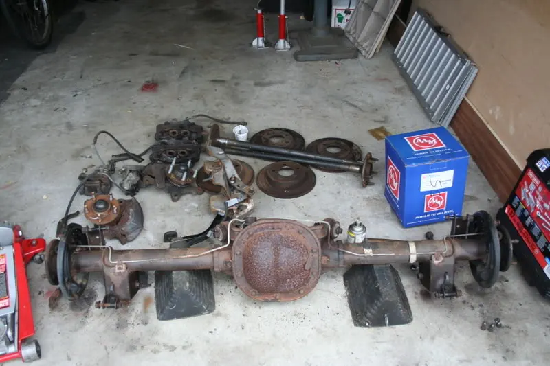

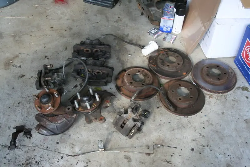

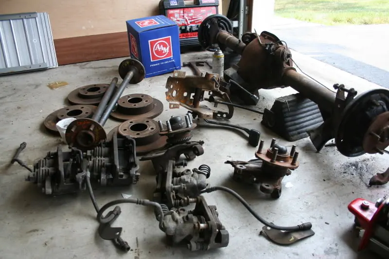

    Alrighty fellas, I have begun the parts collection and the first set of parts started rolling in last week.. 25th's fam was kind enough to sell me an 8.8 with the car so i had that. SVT32V was responsible for the first "official" parts for Blue balls. This will be a busy week with a delivery of parts EVERY DAY and the week will conclude with the picking up of the engine/trans and other misc parts on Saturday :banana: Enough talking - here are the beginninzz
    [IMG]
    [IMG]
    [IMG]
    [IMG]
    [IMG]
    [IMG]

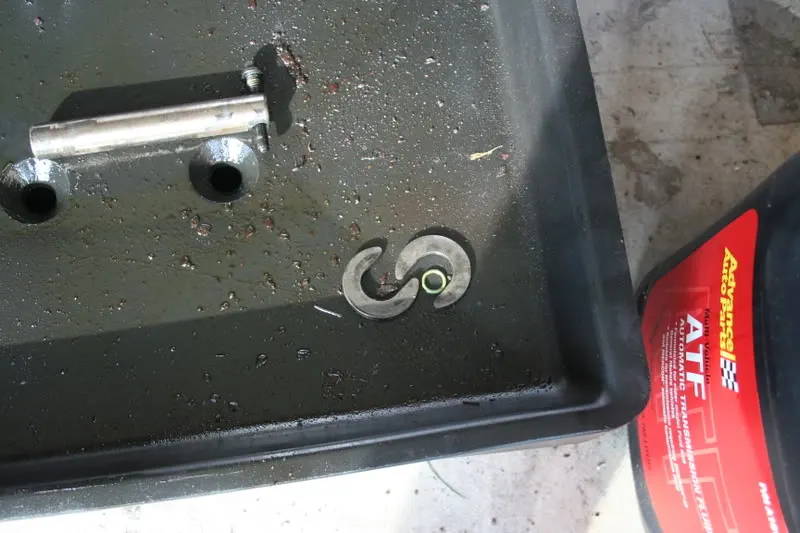

    Do i need to still use the c-clips in the rear?? or can i take them out? It wouldn't hurt to keep them in right?
    [IMG]
    Thats it for now - i'm sure i'll be updating it every day after work when i get home :nice:

    You deff need the c clips still unless you got eliminators or weld on 9" ends. Looks like fun though.

    You can kiss those new wheels goodbye if you decide not to install those c-clips:rlaugh:

    Alrighty then. guess i'll be using the clips! haha. I've never seen the eliminators so i wasn't sure what they were :shrug:

    yep thats why i want to get new stuff for the parts that will be a pita to change in the future. They are sn95 spindles (94-95) and PBR front calipers off a 99-04 GT. Rears are your standard 94-04 disc's.. I have my NRC brackets on order, i should be getting soon i hope. The Axles are just sitting in there right now until i get those brackets.

    Nice to see you moving along with it. Now is the time to clean stuff, and make it look nice before it goes in. A little POR 15 on that rear will work wonders. Maybe paint the calipers as well? BTW the C-clips definately have to go in.

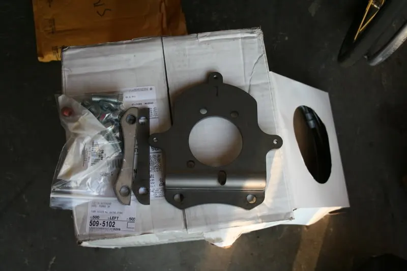

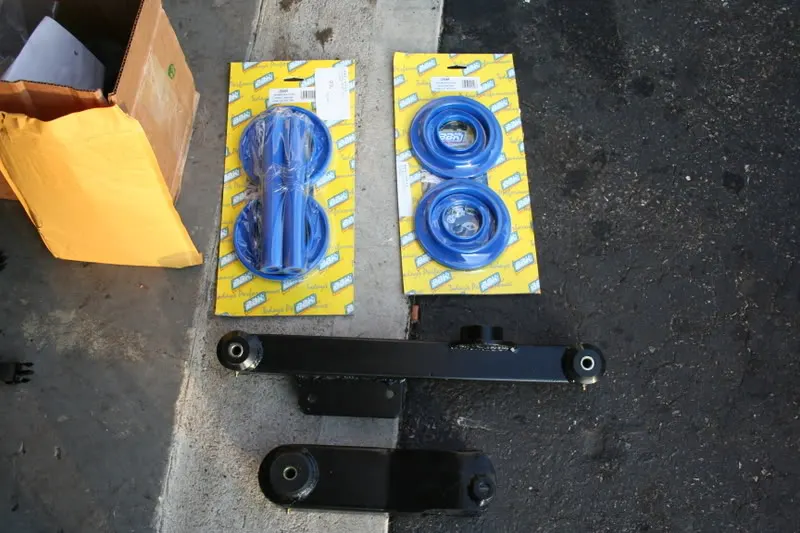

    OK some more parts came today! :banana:
    Brackets:
    [IMG]
    Heater Core:
    [IMG]

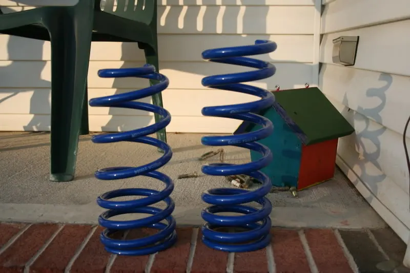

    Springs:
    [IMG]
    Isolators:
    [IMG]

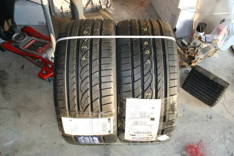

    Front tires:
    [IMG]

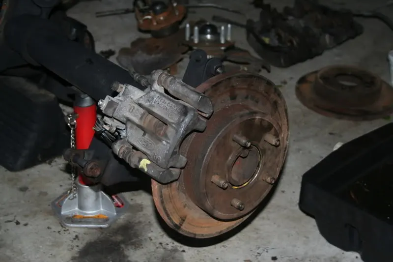

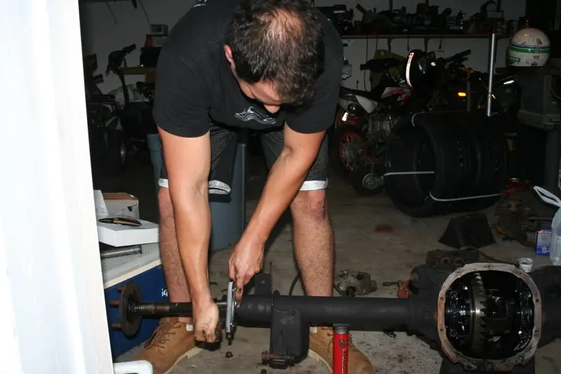

    and some progress!!!!
    [IMG]
    [IMG]
    [IMG]
    [IMG]

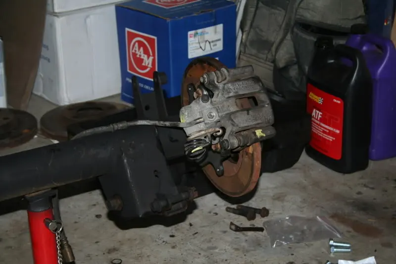

    Por 15 is next - I cleaned up the housing and painted it with high temp paint for now. Since the rear rims are on backorder i have a few weeks before they come in. I'm going to do the front conversion first, and the rear will probably be the last thing to go in. I definatly plan on painting the calipers red, the pics you see are them test fitted. I wanted to ask you, what did you do with the soft lines from the calipers??? i'm kinda confused as to where they mount or where i should drill holes etc.
    Yea i'm going to try to find a por dealer somewhere around my way so i dont have to spend over 100 bucks for it.. Oh i added the C clips back in :)

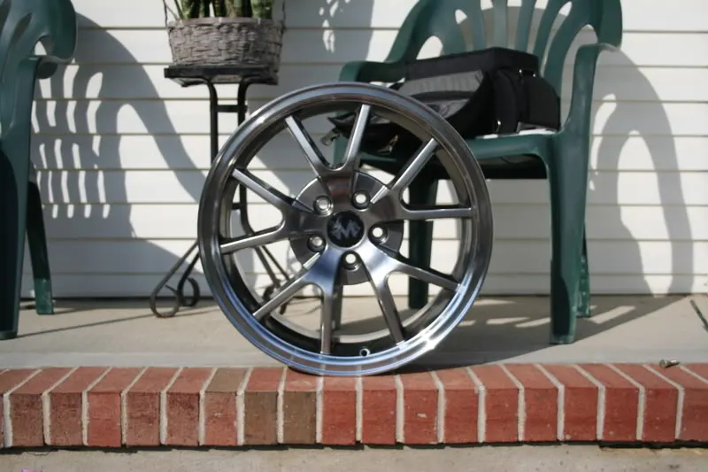

    nice project, I probably missed it in another thread but what size are the wheels/tires?

    They are 18x9 in the front with 255 35 r18 tires, the rear is 18x10 (on backorder) with 285 35 r18 tires.
