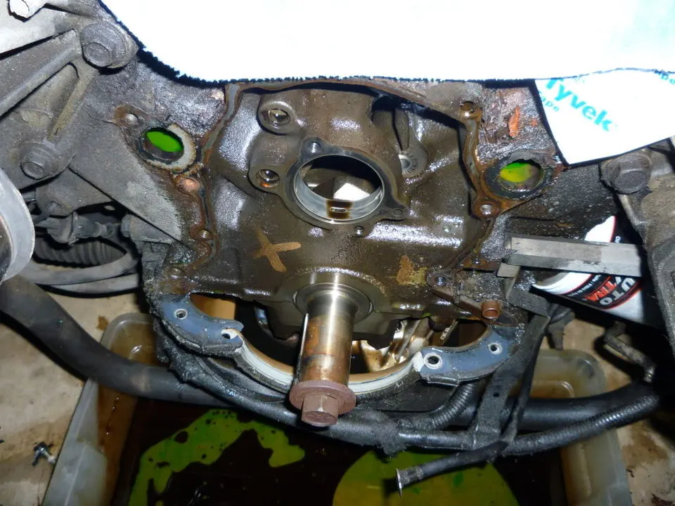

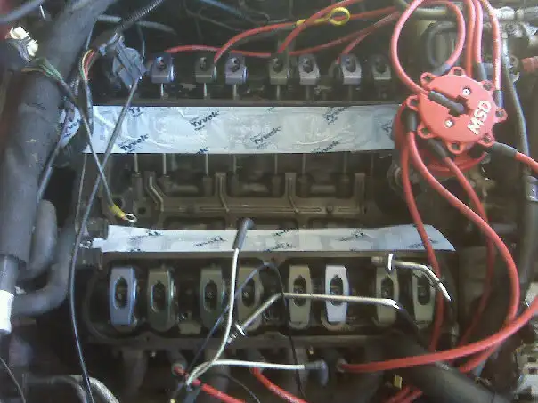

so winter comes along. had a valve cover leak so i pulled the intake off to clean it up and replace the valve cover gaskets...
found thiswhen i got the valve covers of...
so i look at the heads a bit more... they have some mild porting done... check my stock intake that i pulled off. has some port work done there also... so here i am with 1 dirty ass stock ported intake and 1 clean fresh virgin intake
