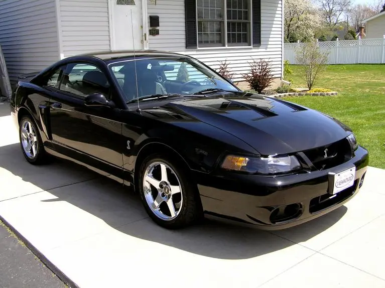

  3. Ok everyone - Don't laugh at me, but the port was something I was gunning for because what I really wanted to see under the hood was that polished blower. ..... I told you I was hung up on looks. LOL So given the combo indicated earlier (RAI, 2.93, tune, cat-back and the ported blower - what do you think it will produce?? - evidently more than 450.) Will the stock clutch take this? ..Should I be concerned with the rearend? .... I feel like an idiot.:nonono: [Please help prevent this moron from hurting a perfectly good Terminator.]
    Pic of my baby:
