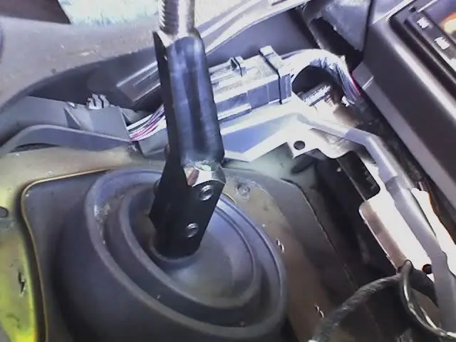

    So it shifts awesome huh?
    I don't know what kind of difference it is gonna make on my car. I don't think I have a short shifter now, it looks like someone put an aftermarket handle on the stock shifter:shrug: But I think the MGW will be quieter and it will allow me to change the fluid during install.
    Are the shift stops installed on a T-45?
    [IMG]
