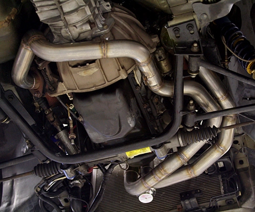

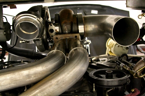

this is because you're using your stock K-memeber and that downpipe cant go above the k-member in between the engine like you can with a tubular. They provide a hotside but it obviously wont just bolt on to your exhaust which would be two pipes that are quite far apart. Because it goes under the K-member and it's 3" it hangs lower than most.
certainly helps to have a tubular k-member tho:
