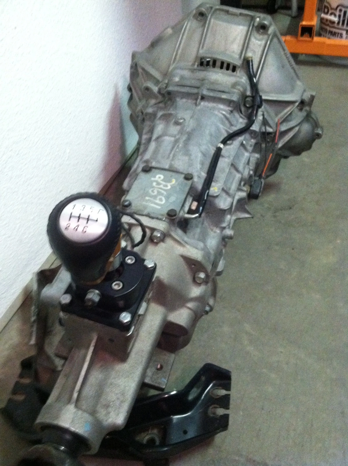

    Well, I decided on the T56. Drove to Texas and picked one up that was a great unit. Setup for my 04 Mach 1 and came with MCloud Stage two Clutch and Pressure Plate, cross member and an Aluminum Cobra Flywheel and I just bought a new Friction Plate for that unit as well. I have purchased new Ford Racing TOB and Pilot Bearing. Almost ready to do the swap just at my age and cold weather I don't get in a hurry. Shoulder is doing well but not great. I'm thinking my friend with a lift will be better then me on my back on cold concrete..... Yeah! Oh, Gear Ratios: 2.66 1st; 1.78 2nd; 1.30 3rd; 1.00 4th; 0.80 5th; 0.63 6th; 2.90 reverse. She is also a 26 spline. All for $1800 and some gas and a road trip. It came with the very nice shifter as well. I'll post up once I get it going.

    Nice find! I guess since it came with a Cobra flywheel, it came out of a Cobra? Do you need to use a spacer to extend the driveshaft?

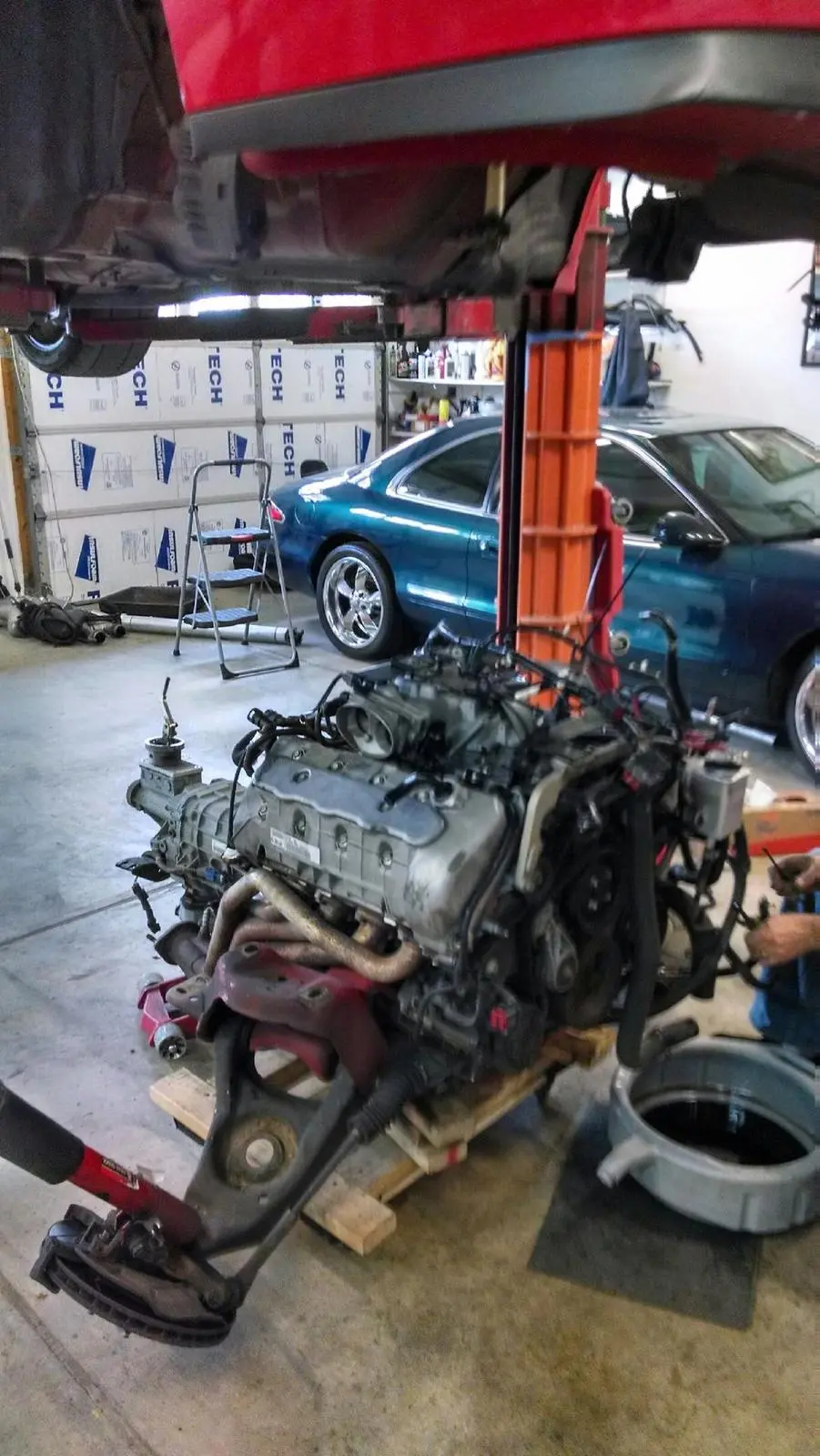

    Yes a Cobra is what it came out of. Just jumped into my son's GT today to install the 1 1/2" Lower kit I got him for Christmas. Good test for the old shoulder and I passed. Easy job. Pulled the Mach 1 in the garage today to start the swap as my Oldest Son will do with our very good friend and his nice garage with the lift. Not having done this before I'm not sure about your comment on the spacer but all will be done with perfection and quality parts. Already contacted our local driveline experts and will fit the driveshaft with new Spicer U's and balance if we have to change the yoke. Will have it all buttoned up soon as they will pull the motor out due to long tube headers and the 3650 does not clear. Good time to clean if anything is dirty and I suspect it will be a little bit. So, I'll take pics and let you know about the existing FORD Racing Aluminum drive shaft goes in conjunction with the swap. I'm sure this will be a blessing once done. Everything is already prepped as of 19:30 hrs local Colorado time. Ready for about 8 hrs of labor.

    KMax, the transmission was located from a good friend that has the nice garage and lift. He found it on FACEBOOK somehow and I drove to TX and purchased from a guy that was between jobs. Guess it was a good deal as it was the best price we found. So my son and our friend pulled the motor out this morning and he made it look easy. He accomplished a leak down/compression test just to make sure everything inside was happy and it was. Only about 68,000 miles on the Mach 1. So the yoke on the Mach 1 was 26 and fits right up to the T56 and overall length from 3650 vs T56 is the same and should be no problem on fitment of the FORD Racing driveshaft. Happy about that. I trust my friend has it well under control and glad I'm not even having to touch it just as any old dad does I'm buying the fluids. Engine.jpeg

    KMax.... well I guess you were waiting on this. Folks was right on the driveshaft needs shortened. The measurement when the entire engine/3650 was pulled was rough. It will need shortened. My friend is just about done and all coming together now and just cut the shaft and waiting on lower radiator hose from American Muscle since no one in Colorado Springs had one not even the dealer. Looking forward to seeing my sons face when he fires her back up and pushes that stiff McLoud clutch pedal in for the first time. Maybe it want be that bad.
