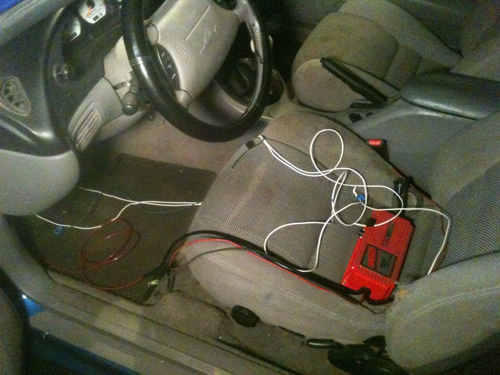

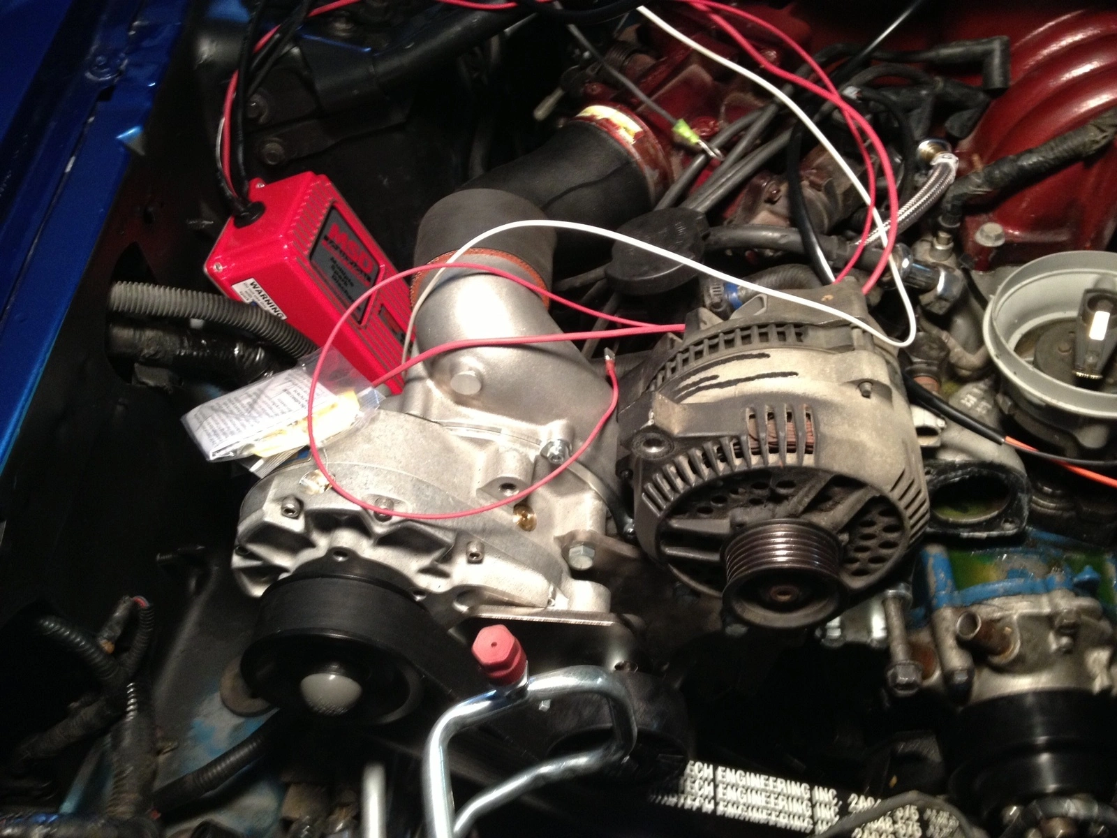

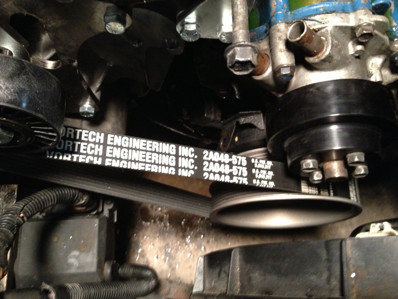

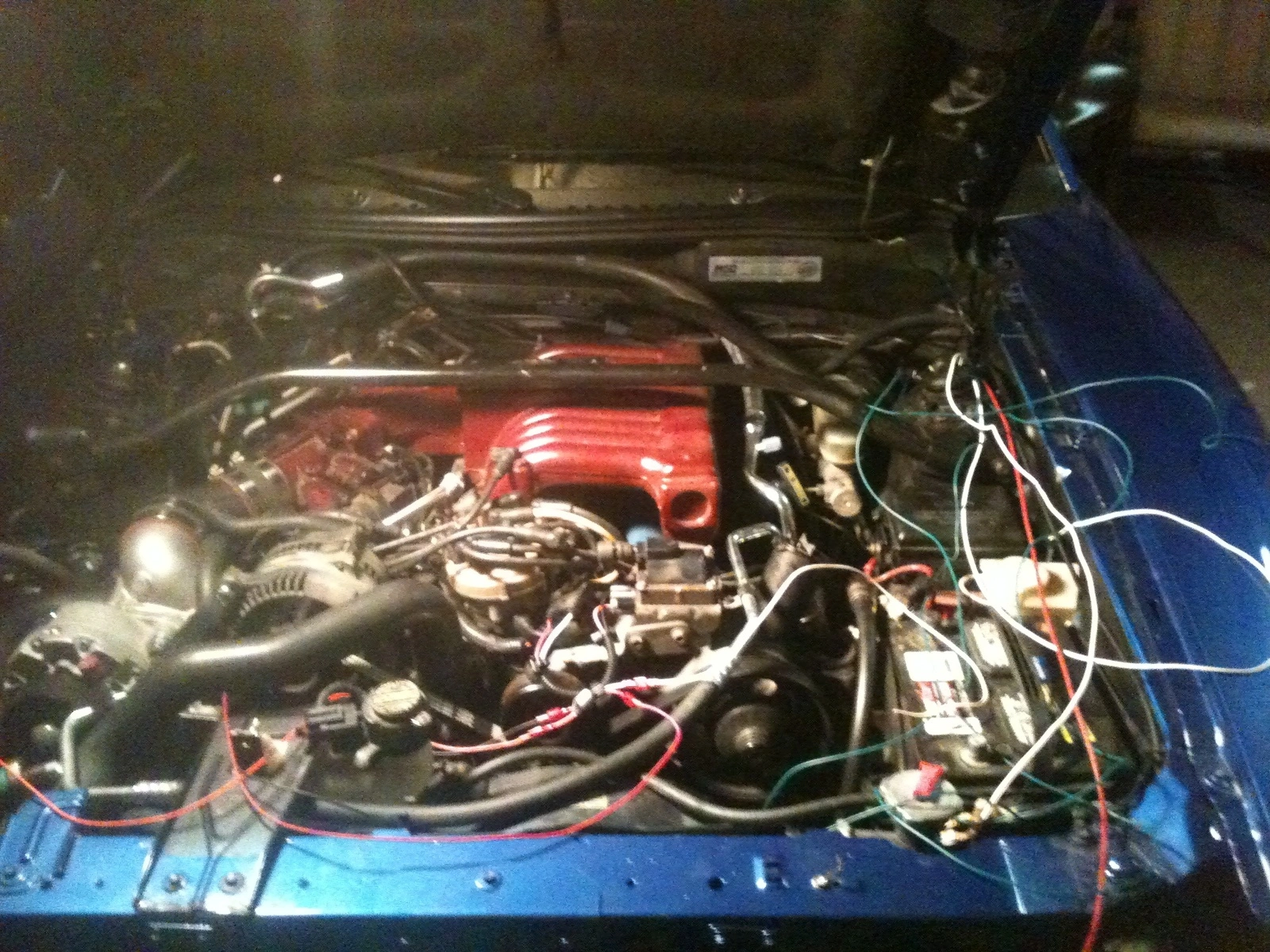

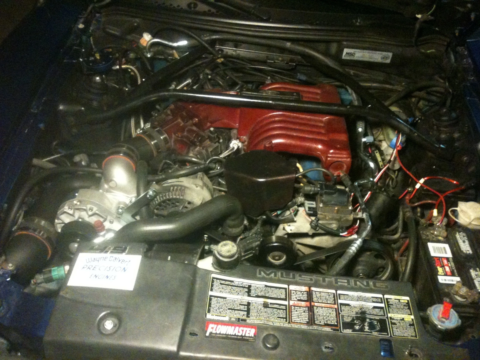

  4. image.jpg Well got er done. Fires right up, no leaks, ran like a stripped-azz ape. Gonna get a tune but may be a month.
