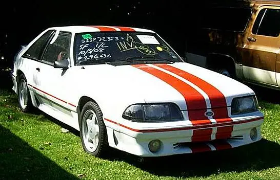

    Here's my flood damaged car. It was within 3" from completely covered with brackish water during hurricane Ike. It's been sitting out for a year now and I figured it would be rotted out by now, but it's not rusted at all. I'm going to gut it and make a drag car. I've got to replace the wiring with one I took out of an SVO. It still has water in the side marker light.

    Your car is looking good. Good luck with it.
