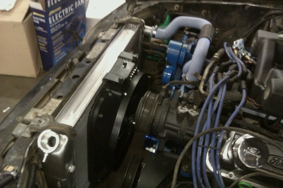

So, I went to Omaha this weekend to spend time with friends and family. Started out ok, midway through my trip my car started to run warmer than usual. I kept my eye on my gauge to make sure it didn't go above half. Thank goodness it didn't, but I got to my Uncle's house and checked out my Electric Fan. I have the Proform and it wasn't turning on! The thought that went through my head was... "everyone was right... these fans are junk". Instead of reacting, I investigated. Turned the knob both directions and nothing. Decided to turn the knob harder than you should counter clockwise, and the fans kicked on! PHEW! Set it to around 180* and its all fine and dandy! Lol.
