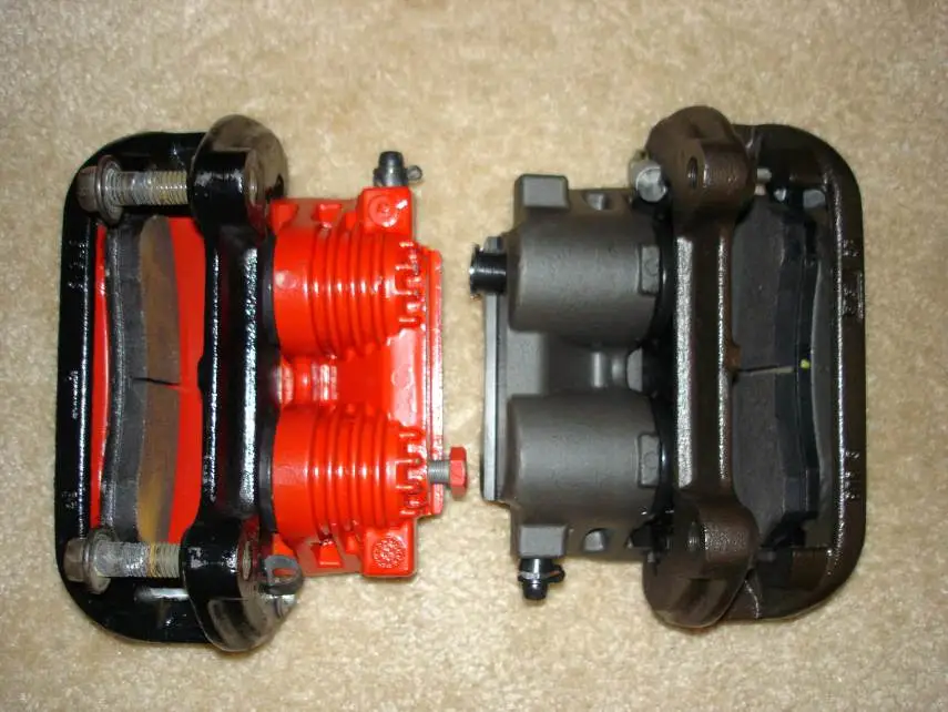

    Nope, physically they look a little different as well.
    Red caliper is a 1998 cobra caliper, black caliper is a 2003 Mach 1 caliper (same as cobra/bullitt) which is on my fox.
    Master cylinder selection can vary depending on which you use
