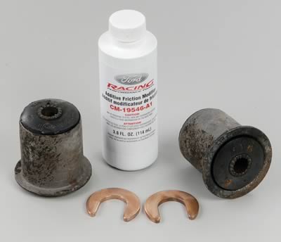

    what does the install tool look like? i got them from summit and they came with some c clips? i dont no where they would go tho. Also is there any kind of trick to get the old bushings out?

    The tool pushes the old bushing out and pushes the new bushing in. The tool looks like a steel cup with a bolt and a couple of thick flat washers. It works really well. At $35 or so it sounds expensive but it really makes the whole job much, much easier especially if the rear is still in the car. I don't have a clue where the c clips go. Which bushings did you buy? Part number? I used the heavy duty Ford bushings in mine.

    these are the exact ones i got from summit for 31.95
    [IMG]
    i couldnt find the install tool tho. Where did u get it from?
