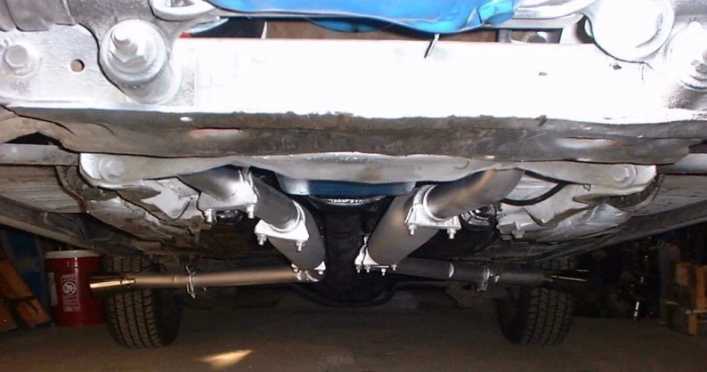

Built my own 2" duels for about $150 , 7 years ago.
