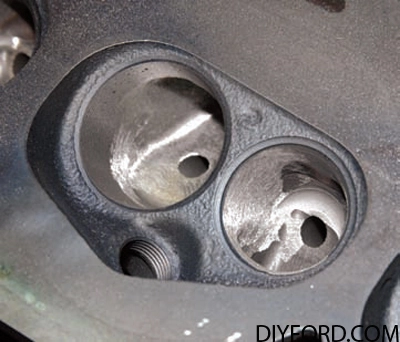

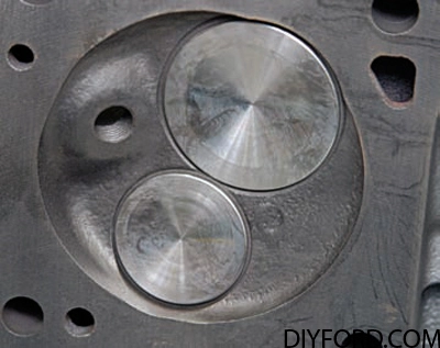

Along time ago I was building a Clevor that I intended to put nitrous on.I planned to use a open chamber 2v head. After reading and talkin to people, I learned that the lack of a "quench area" would cause the engine to detonate very easily.
Consequently,..I bailed on the Clevor thing, and just went w/ a conventional Windsor head instead. I never got to see for myself whether or not that head was gonna cause rampant detonation.
This is a pic of that chamber.

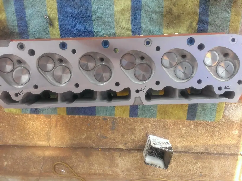

And this is the closed chamber version of that head. The flat area is necessary to promote a clean burn, as it forces more complete combustion as a result a tighter packed mixture.
Now,......this is the Monster's camber:
I'm not seeing no quench.
I knew this in the back of my head, but gave it little consideration. Now it may be that this is why the thing is rattling.
Then again,..It could just be tune related. Time will tell I guess.
If that turns out to be the case,..it'll be the death nail for any boost north of probably 5 P.S.I. as this all ties back to lack of quench being intolerant of high cylinder pressure.
