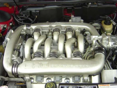

I've never really seen an equal length intake. :thinking:oh...yes I have...
Usually, there is a log and runners coming off from it. Guess that's what you have in mind....since you referenced the gt40.

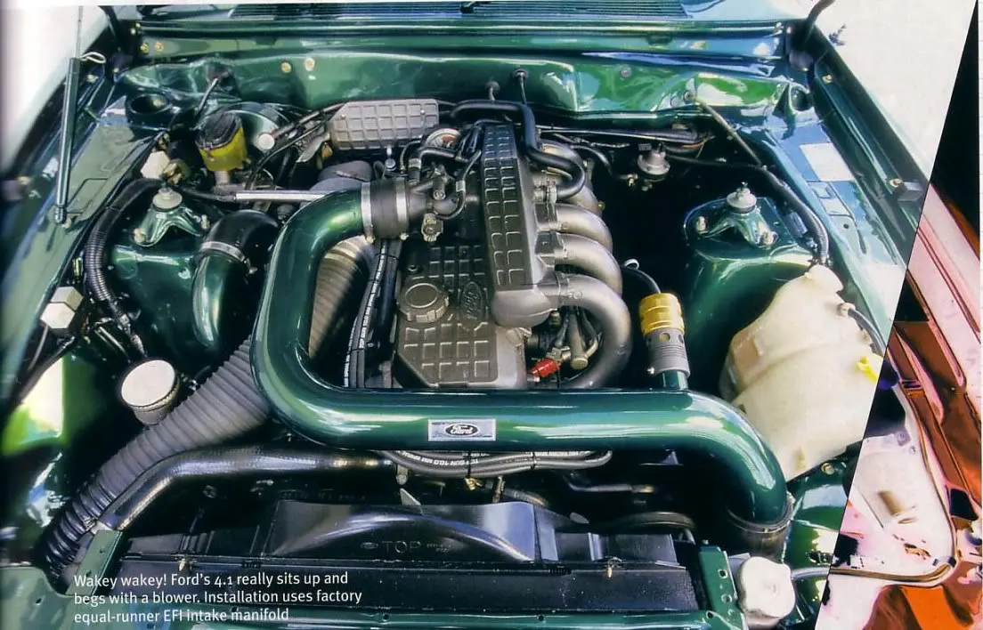

The stock 2.3 liter plenumb Half Ferrari 512i BB/Testa Rosa or BMW 635i style stock 4.1 liter Ford Cross Flow six cylinder type was used in most turbo instillations from 1983 to 1992. It was a supplied via Bosch in Germany, who did the development work for Ford Australia. They did the Injection Ferraris and BMW's the same time they did the Ford X-flow six.
The 1980-1987 Garret AirResearch Australia and laterly, AIT 3.3/4.1 liter Ford Cross Flow six cylinder type was another, both upstream
There are other kinds of more "5.0 Ford EFi" style header tubes for Port EFi 6ixes. Some updraft, some down draft.

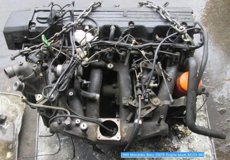

Mercedes Benz always used Daft Steam Punk style runners, often updraft like a pre World War II carb mount.

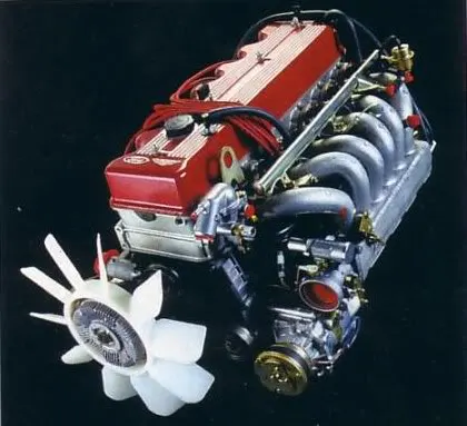

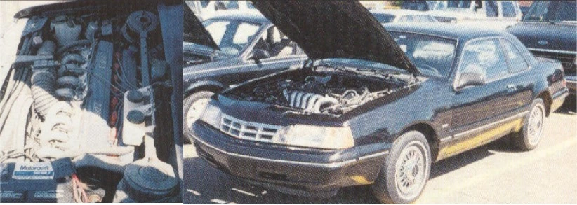

When the Thunderbird MN12 style EA 26 got the go ahead from head office in 1984, Ford Australia then had massive hood space restrictions, so it employed the "sort of" Daimler Benz M103 style low mount Independent Runner branch to the single throttle body.
It looked like this in 186 to 216 hp form from 1988-1992 EA and EB S pack and XR6 3.9 liter OHC Falcons.

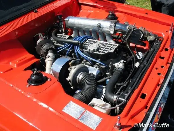

They package really well on the 9.22" tall SOHC's based on the ancient overhead valve 250 block.
To do the same, its just like this to do a bunch of banana's intake

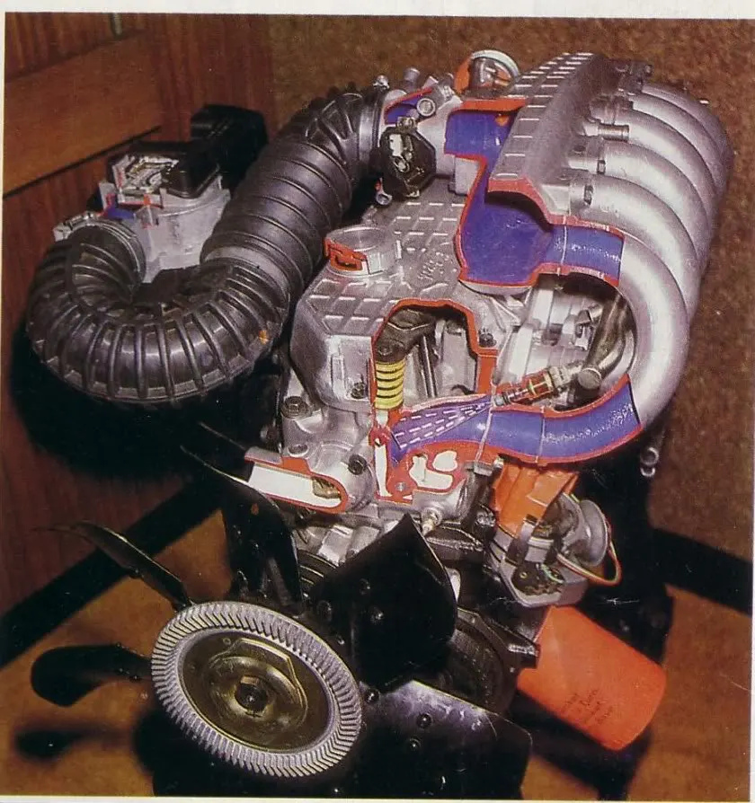

However, a few years earlier, the 142 hp GM Holden Commodore XT6 3.3 Liter 202 Electronic Injection intake looked like this.
1985VKHoldenCommodoreElectronicInjection33literHeadersEFIandseparteTankcompactpowersteeringunit.jpg
It REALLY produces the goods on a little 3.3 liter six that normally is restricted to about 300 hp at 7000 rpm without an aluminum cylinder head. With the best cylinder head around (zjello's remastered knock off of the Phil Irving 12 port Heron head), they go up to 370 hp at 7000rpm.

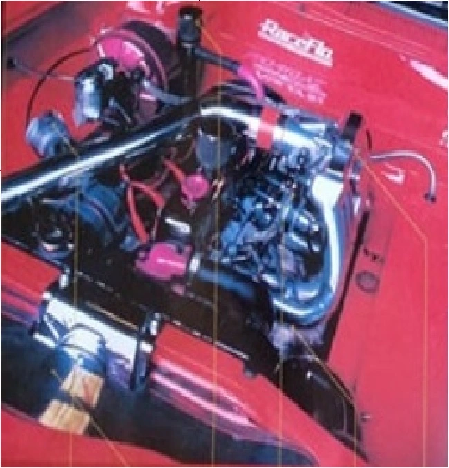

The best example was the January 2003 Australian Street Machine preview of the Western Australian Mick Munro's OVA BOOST.
It was put together while he was still working for FORMAZ. On the strength of this 9.92@135 mph Power Glide and 28 x 11.5 wheeled 2400 pounder, Mick started OVA BOOST Engineering. Sadly, it became 2JZ after he eventually threw a rod in this Holden 202 in line six, but it took about 5 years of thrashing to do it.

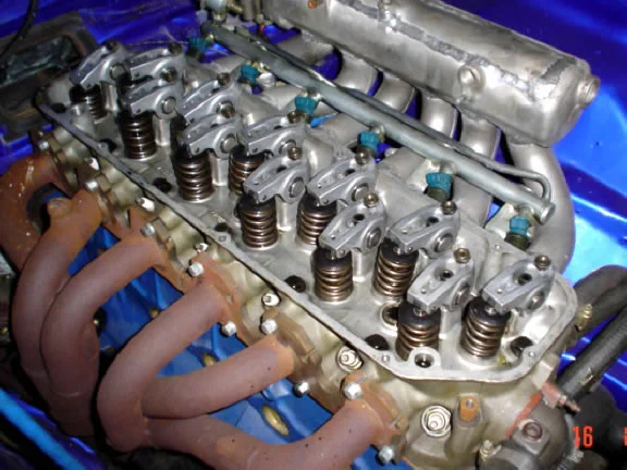

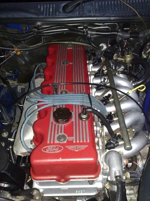

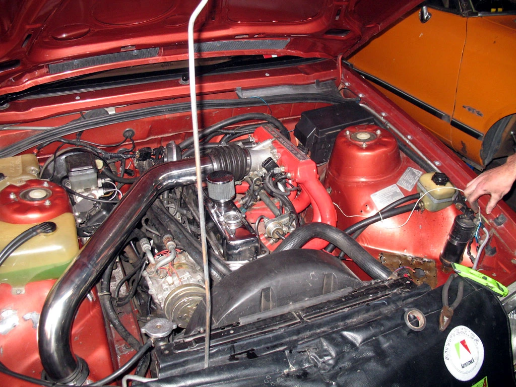

It wasn't GASSED250, but a guy called Jayd copied another members 250 EFI to EA-EB MultiPoint EFI intake.
It had a killer 250 with custom inlet and pipes and nitrous, ran a 10.8 Stanging 1/4 mile unboosted with Nitrous. Both turned the EA-EB Benz style intake runner upside down.

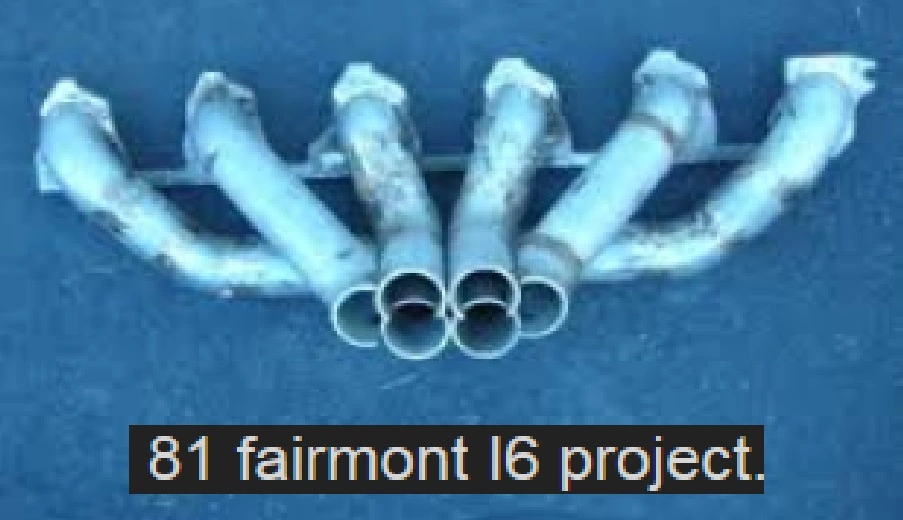

This pretty much what you are looking at I guess

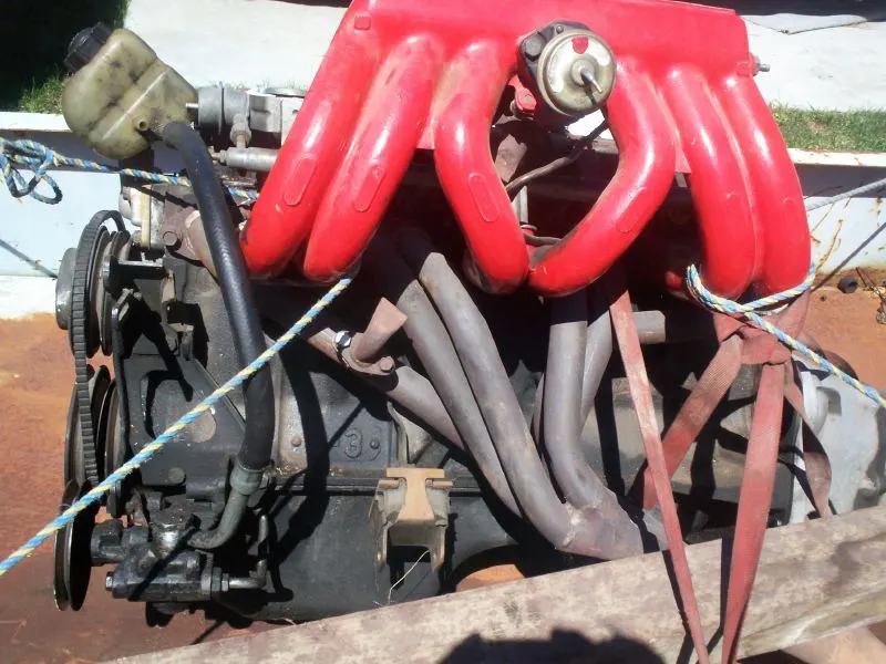

You take the SOHC EA 3.9 or EB XR6 3.9/4.0 intake, and turn it upside down
Ford Australia developed it intially as an Upstream Port EFi Straight Eight DOHC intake for the 1985 concept of the T drive Thunderbird. Basically a 4.3 liter version of the 3.2 liter in line Six based on the old 200
The EA-EB stuff fits any 1980-1992 X-flow OHV head
F79C2399%20theres%20a%20guy%20on%20xfalcon%20that%20is%20running%20eb%20efi%20on%20a%20crossy.jpg

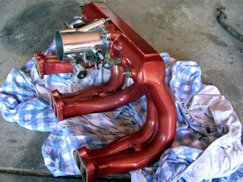

If I could get a plenum under the runners I'd consider a look like this:
But that forces a rethink on the existing water pump system that lives under the intake manifold,...so,...more work than what it's worth.
Ironically,...this is the concept seed that is growing in the grey matter forest inside my head...
So,....more topic for discussion.....

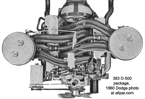

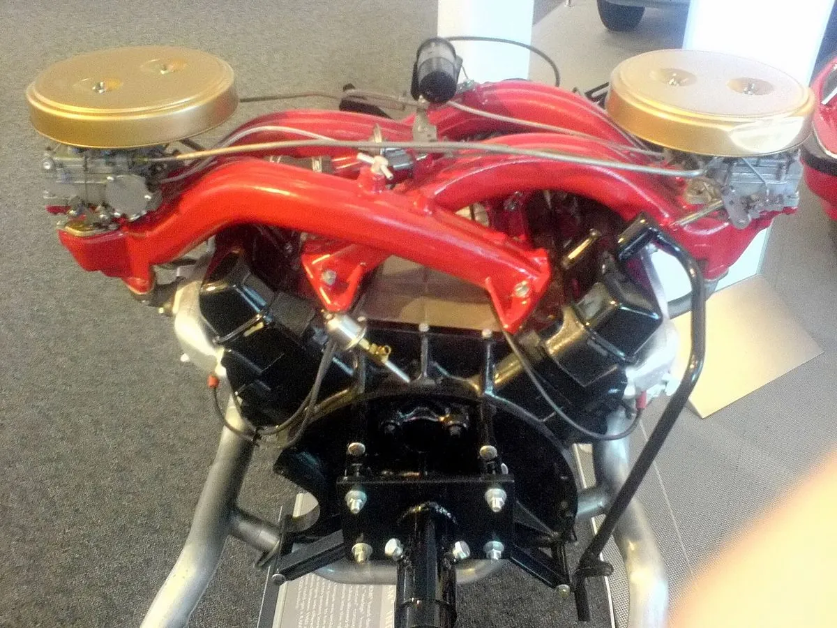

If I split a plenum and feed two banks of three cylinders ( much in the same way I'm feeding the twin scroll turbo)
Do we think there'll be any negative/positive benefit to feeding cyls 123 from one common plenum, and 456 from another? Chrysler did it almost 60 years ago...
( I'll bet this was a real btch to get started)
They linked the two plenums together,...you can barely see it in the above pic...
But much more clearly here...

The trouble is that this is a V6. It would be difficult to do an equal length this way with all your intake ports on one side.
@madmike1157
Something you may not know...
Notice the runners in the photo... They are cast in pairs. Chrysler wanted to use the same layout as the larger 413 but with a higher RPM tuned band. Soo they did a sneaky; they removed part of the divider inside the paired tubes where they joined the plenum, effectively making the paired section a part of the plenum. They could take one common external casting and play with the internal casting mold and get almost any runner length they wanted. Mike could do the same thing.
