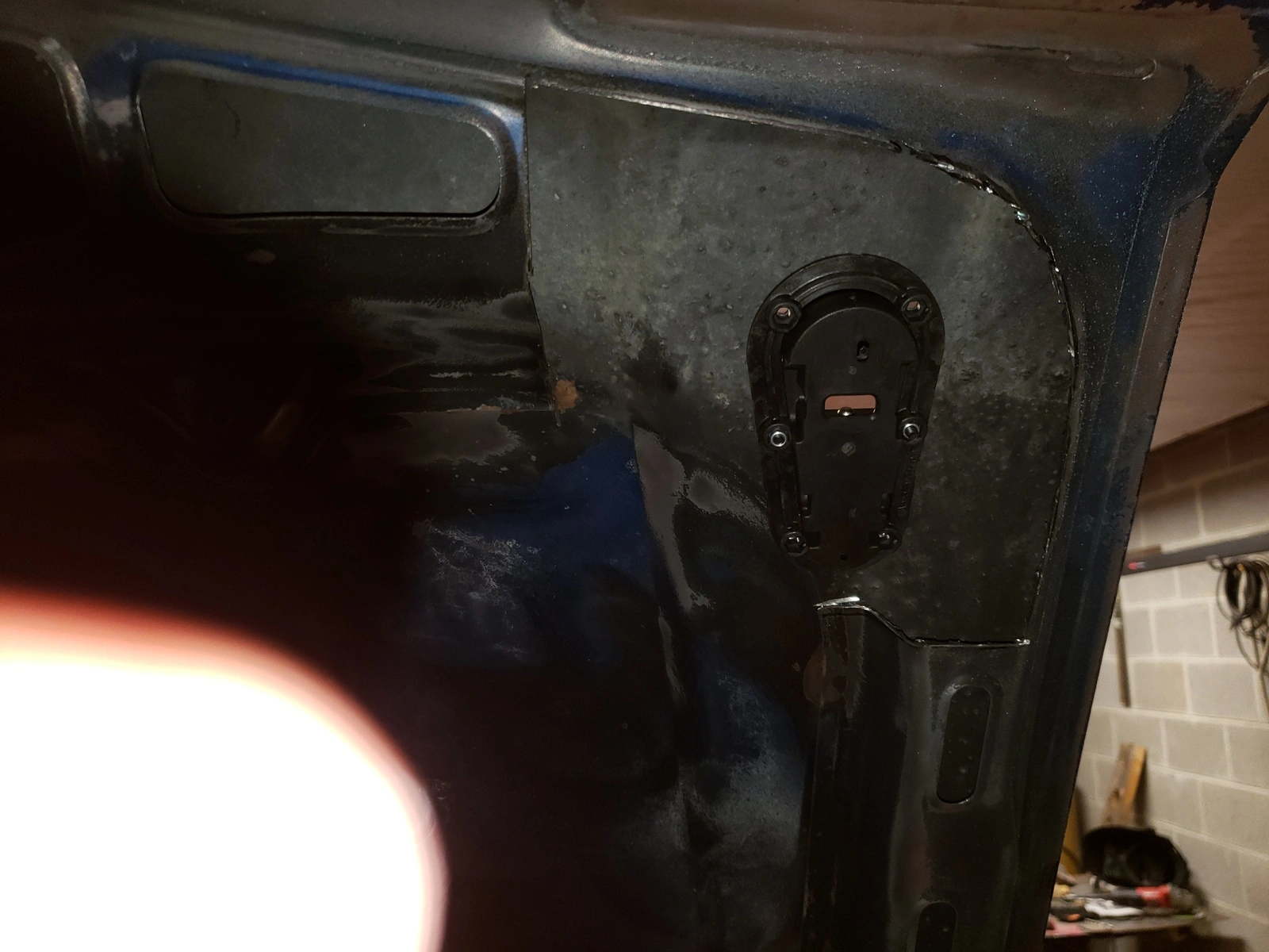

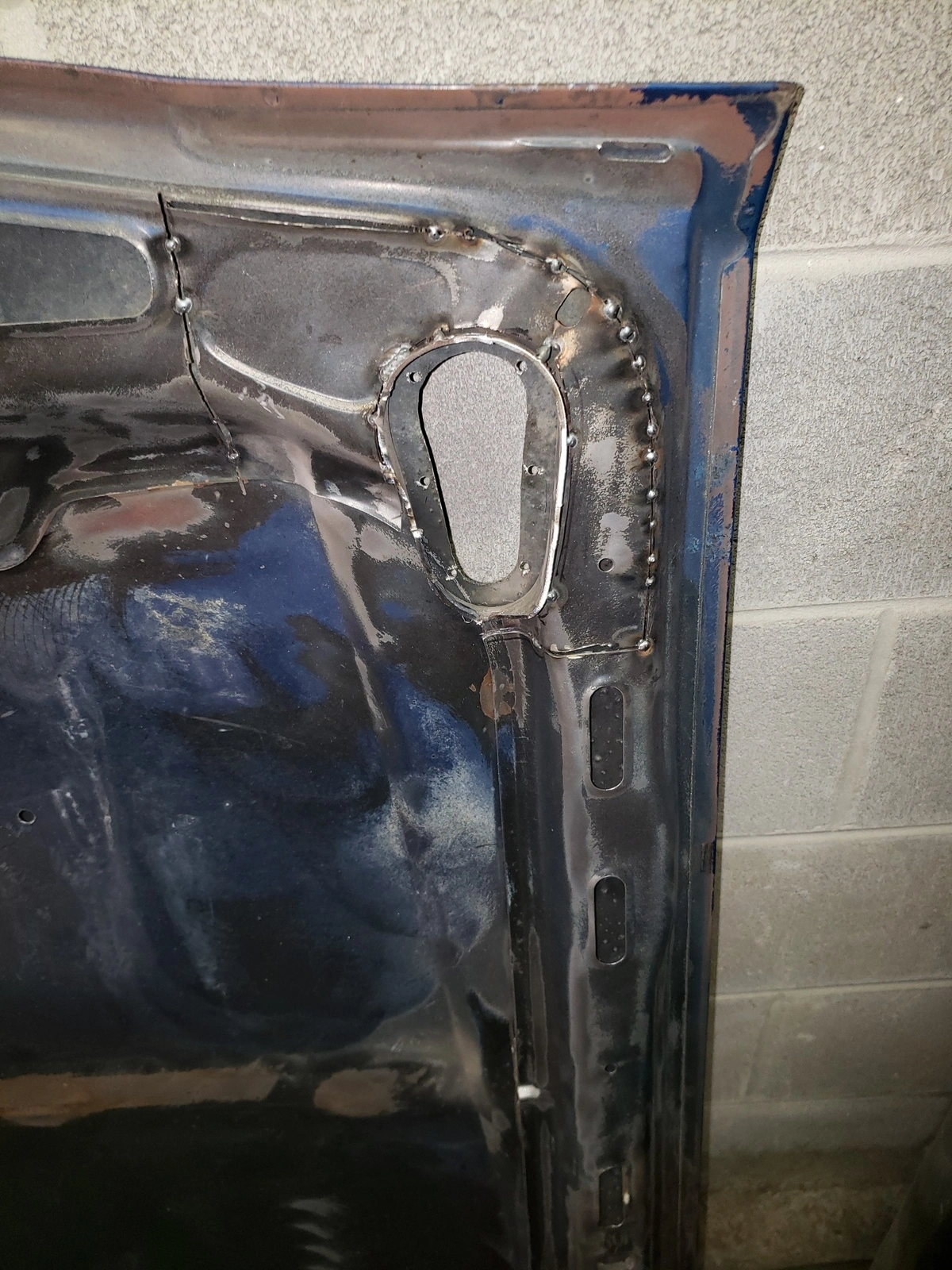

The hood needed the surrounds for the Aerocatch hood fasteners finished. The metal under skin on this hood has got to be 24 gauge...maybe it's even 26...cause it's some thin sht. While I managed to get the piece butt welded back in and the welds ground down decently on the first one, the second one decided to test me.
Trying to get those welds smooth resulted in a couple of places that got ground through.....and now that remaining metal was like paper. Try as I may...a hole that was a quarter inch in diameter quickly grew to the size of a quarter. I simply couldn't get the heat setting low enough..as soon as I trigger the gun, it blew through the metal. And the freakin hole kept getting bigger and bigger.
Finally, I got to thicker metal,...but what's left to do to fix it?
Grinding of course...
I posted a pic a while back showing the broken hood where the early prop rod used to go. I thought I had that fixed.
But the sunlight streaming through the cracks told me different.
So I cut that piece out, and made a new replacement piece out of .......ohh....I don't know,...something thicker...... ( maybe 18 ga.) and butt welded that in.
Then ground down the welds,..and promptly ground through a couple of places again, .....and made another mess.
Fairmont hoods have hood ornaments.....there's a hole where that stupid thing pokes though up front....but not no more.
Now there's a plate welded in place of the hole.....but it's not butt welded...it's lap welded. In other words, the piece I made to plug that hole wedged into existing sheetmetal that wasn't cut.....so it kinda got welded on top of the other metal...cept it's still recessed.....which means no grind through this time.
( that didn't stop me from burning the fck out of myself when I decided to see if it was smooth after grinding the welds down.)
I think I left melted flesh on the hood..
