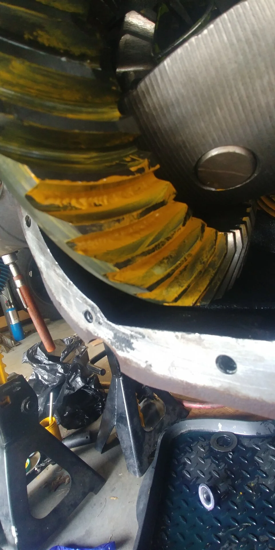

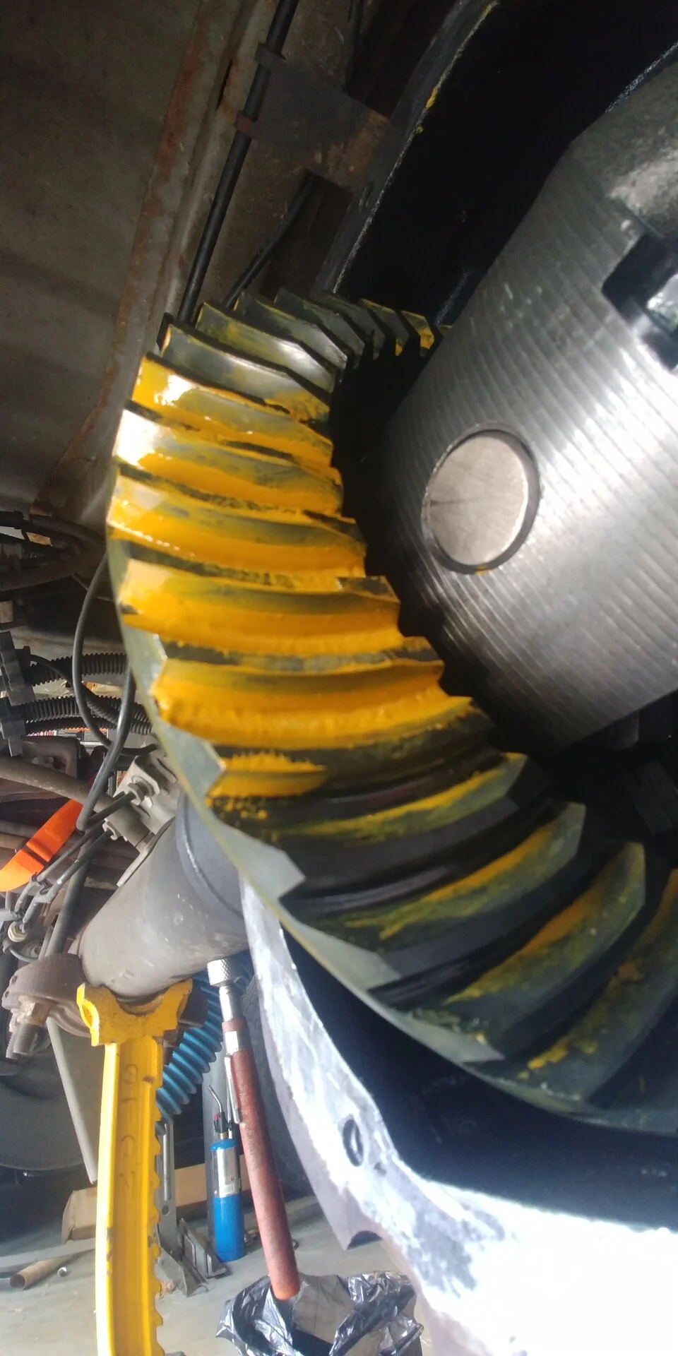

What do the gear gurus think of this pattern? It looks to me like it's shallow but no matter what shim i use, the pattern just moves around. Doesnt get any deeper...
How much backlash do you have? It looks like you need to move the ring gear closer to the pinion. What brand are the gears, maybe their tech line could help you out?
