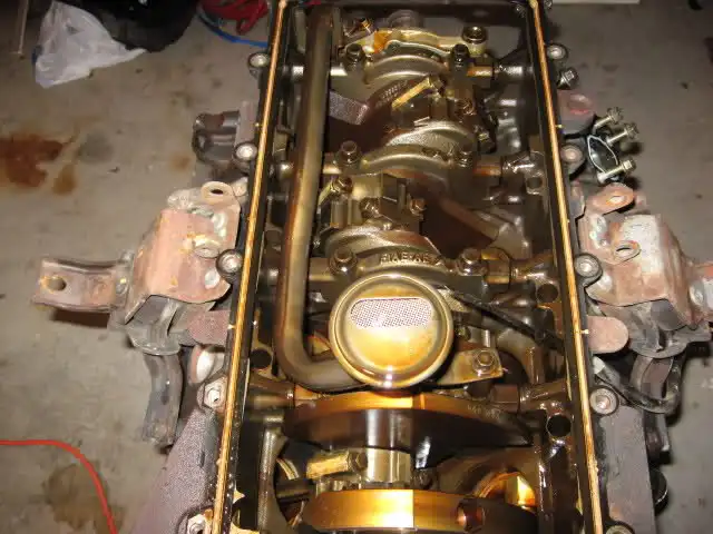

This is a 90k mile 2002 Romeo engine out of a police interceptor. Driver's side head dropped a valve and punched a hole in the #7 piston. I'm replacing the piston only and not pulling the crank. Due to what I found in the oil pan, I'll probably replace the oil pump and pickup tube as well. I'll need a driver's side PI head, which I think will come out of the FRPP catalog. I'm assuming the cams are all the same in all PI heads. Check out the oil cooler, I think I'll keep that. I've already picked up some GT engine mounts, a 5-speed wiring harness, GT exhaust manifolds, GT power steering pump and some COPS. I'm still on the fence about going fuel injection or using Edelbrock's carb setup. I have an old cracked non PI intake with the injectors still in it. I'm just trying to figure which way will be least expensive. My goal with this car is just a unique Saturday night cruiser, occasional nice day driver. Enjoy!

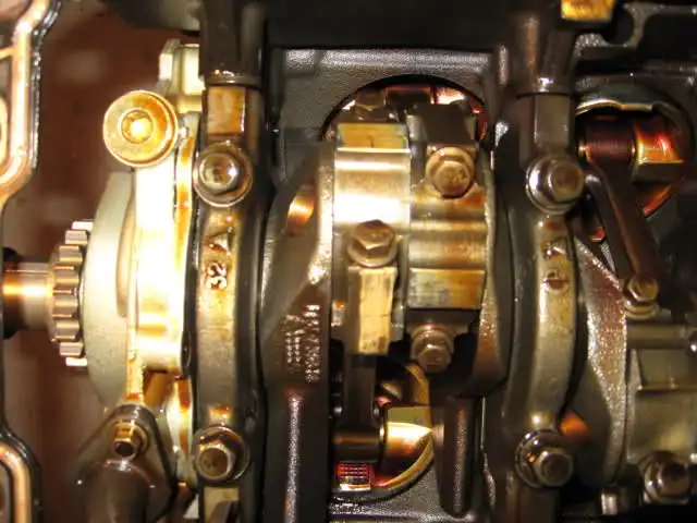

What could have caused this?...
And the winner is.....valve locks in the oil pan.
