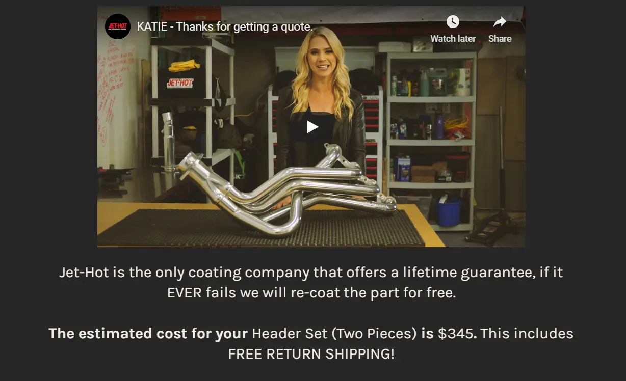

Send them to Jet-Hot. That's who Ford used for their headers. I have a set I bought used about 13 years ago. They will not discolor. They do lose some of their shine.

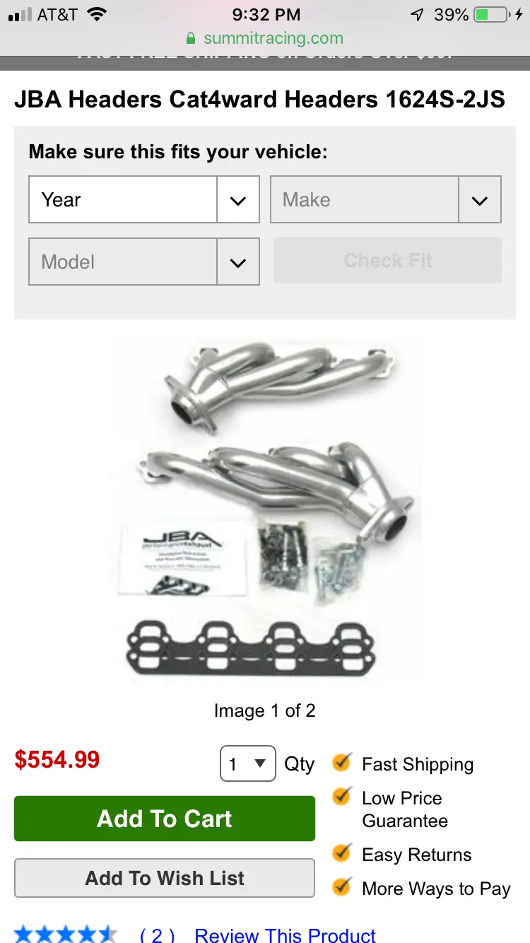

The BBK ceramic coated ones are $300. Buy new, sell the old.

Jet hot was $350 plus my shipping costs to them. They also had reservations about the condition of my headers. So it may not be worth coating them. They are solid though...just surface rust.
Jet hot is nuts! Maybe its because of the metropolitan Detroit area and it's some what competitive since so many shops do the coating. But I would estimate those would be $150 or less to coat outside only, hell some might do inside outside for that price I'm just estimating. They would not care about rust as they would sand blast them clean as long as they dont blow holes in them.

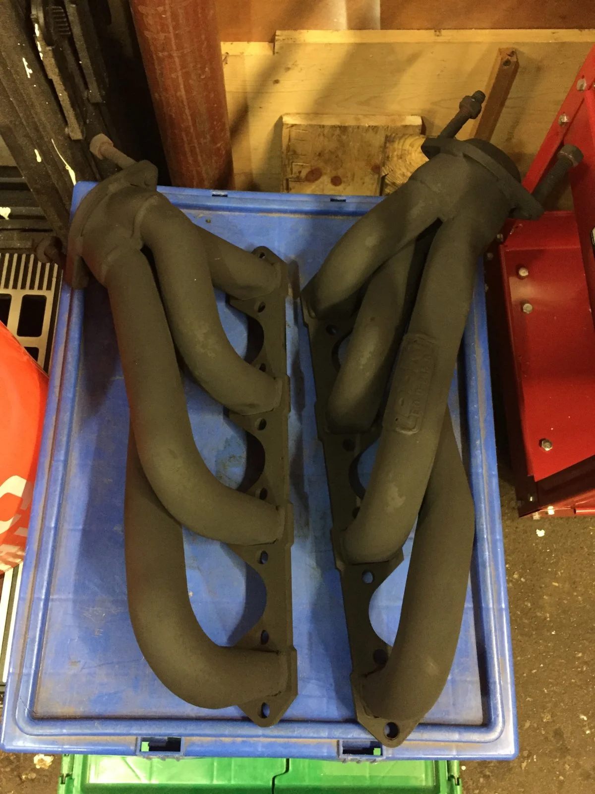

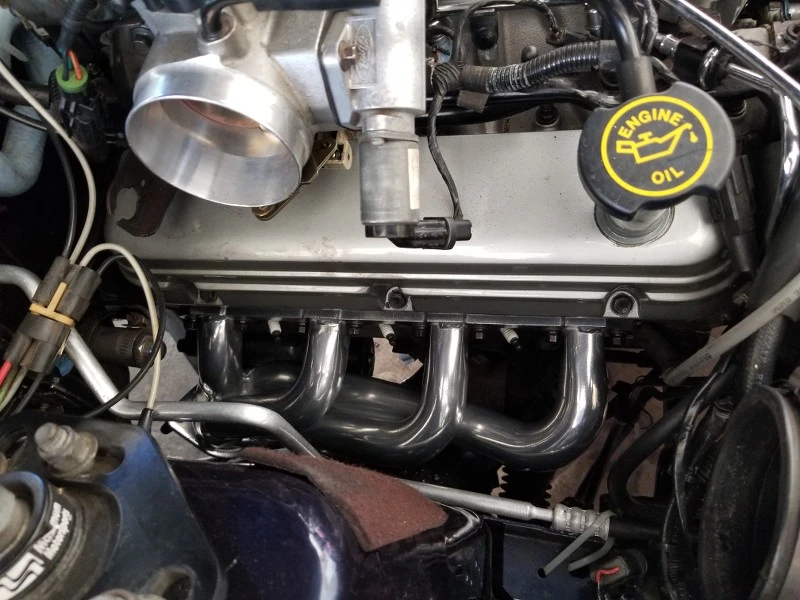

For comparison if I remember right these were $250 for both left and right. This was inside and outside. As I stated earlier was not real happy with the inside coating as the car was already run and the mufflers were full of those damn polishing bb's.
Obviously the last 18" is stainless and was not coated.

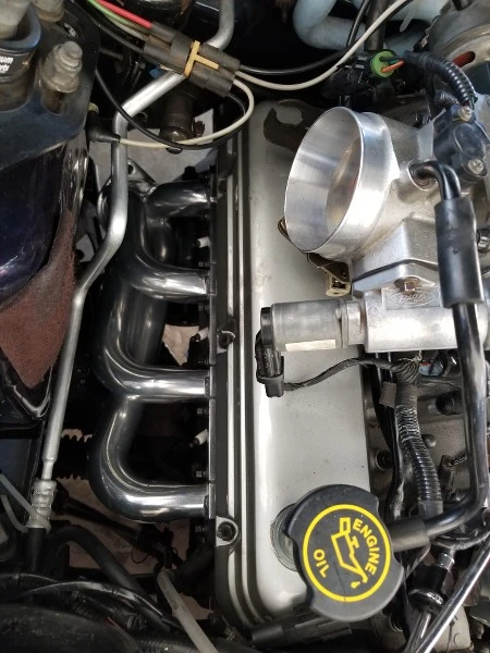

I had a set of ceramic coated headers on my saleen explorer.
Something about the finish that I just didn't like, especially as it aged and they lost their luster.
I'm unsure if there really is performance benefit of ceramic coating, but visually i'd rather be looking at a high quality set of Stainless headers.
I think the ceramic coating is more for heat than appearance.
I know my current headers get hot as hell after a long drive and am looking to ceramic coat in an effort to reduce that heat.

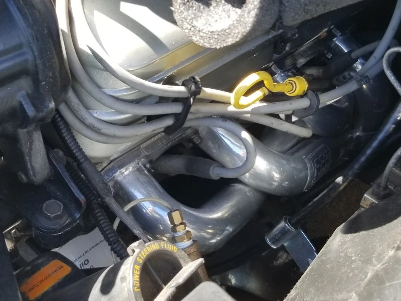

When I had two Foxbodys at once, one had Ford Racing ceramic shorties and the other BBK ceramic shorties. The BBK were much nicer pieces. When it came time to sell one set and keep one I kept the BBK's and they are still on the car now. Excellent product.
