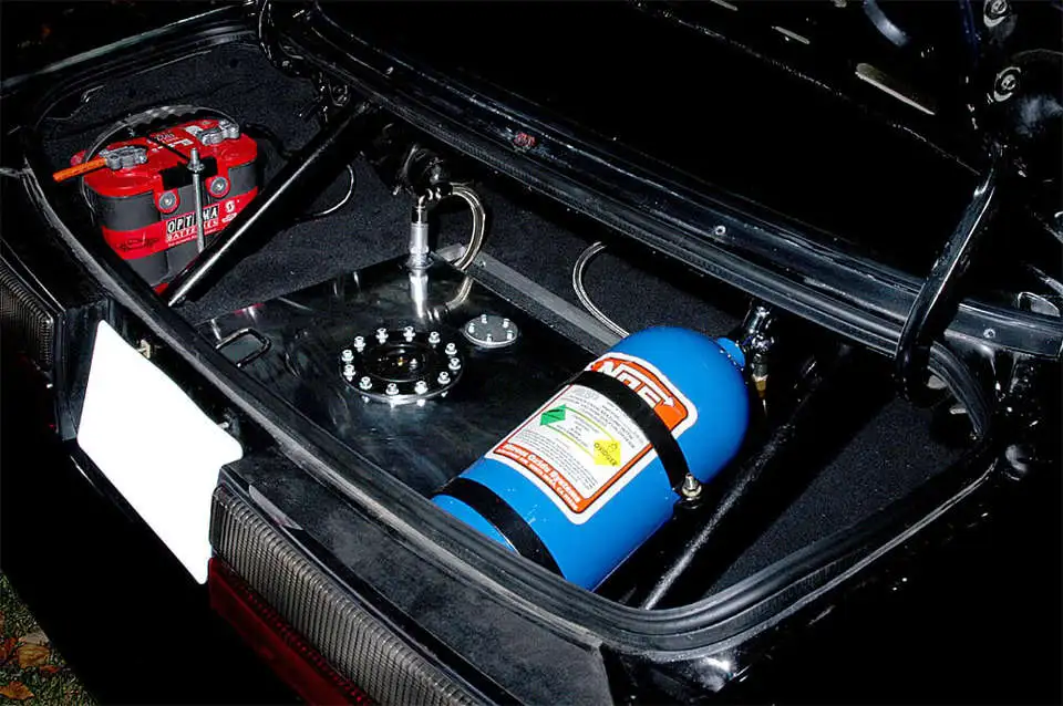

As the title states I want to see your fuel cell and battery relocation pics. I am in the process of putting a fuel cell and relocating my battery to the trunk.
I just bought a 16 gallon cell, all -10 an lines from cell to a Y block, From there it is reduced to -8an to my 2 fuel pressure regulators which then split off to my nitrous solonoid and the carb.
I am currently in the process of routing the -10an line, Nitrous line, and battery cable in a safe place under the car, which is very hard with full exhaust.
I would love to see how you did it!
Thanks,
Matt
