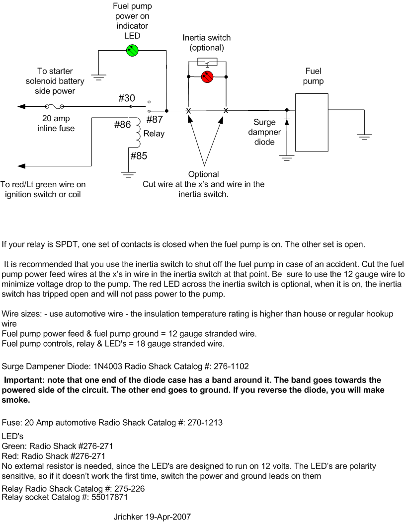

1. Do not use an EFI in tank fuel pump with a carb. You will never get the pressure/flow regulated properly. If the add on pressure regulator fails, you will flood the engine with gas and wash all the oil off the cylinder walls. That will cost you big time $$$. Either go full EFI or use a tank/fuel pump/fuel lines out of an 85 or earlier Stang. The in tank electric fuel pump from an 85 5.0 Stang can be used since it is only 10 PSI and not 40PSI+ output pressure that an EFI pump delivers.. Fabricating your own setup is possible but there are some snags to overcome.
2. Do not attempt to leave the EFI computer in place in an attempt to control either the electric fuel pump or ignition. Doing so qualifies you for the “Road Kill Mechanics Award”.
3. If you try to use your current tank, you will need to pull the fuel pump out and fabricate a pickup tube & strainer sock to replace the fuel pump. Or you can have a sump fabricated and welded onto you existing tank. Many welding shops will not weld fuel tanks because of the dangers involved if the tank isn't purged properly.
4. You will need an external electric fuel pump unless you change the timing cover for one with the mechanical fuel pump mount on it. The external pump will have to be mounted below the bottom of the tank to get the siphon effect needed to keep the pump fed sufficiently. Rip all the EFI wiring out, and the computer controlled fuel pump won't work. You will need to add a relay & switch and wire in the existing inertia switch for an external low pressure electric fuel pump. Do not try to wire the fuel pump without the relay. The 15-20 amps the pump pulls will overload the circuit. This will take power away from other items on the same circuit or cause the fuse or fuse link to blow.
