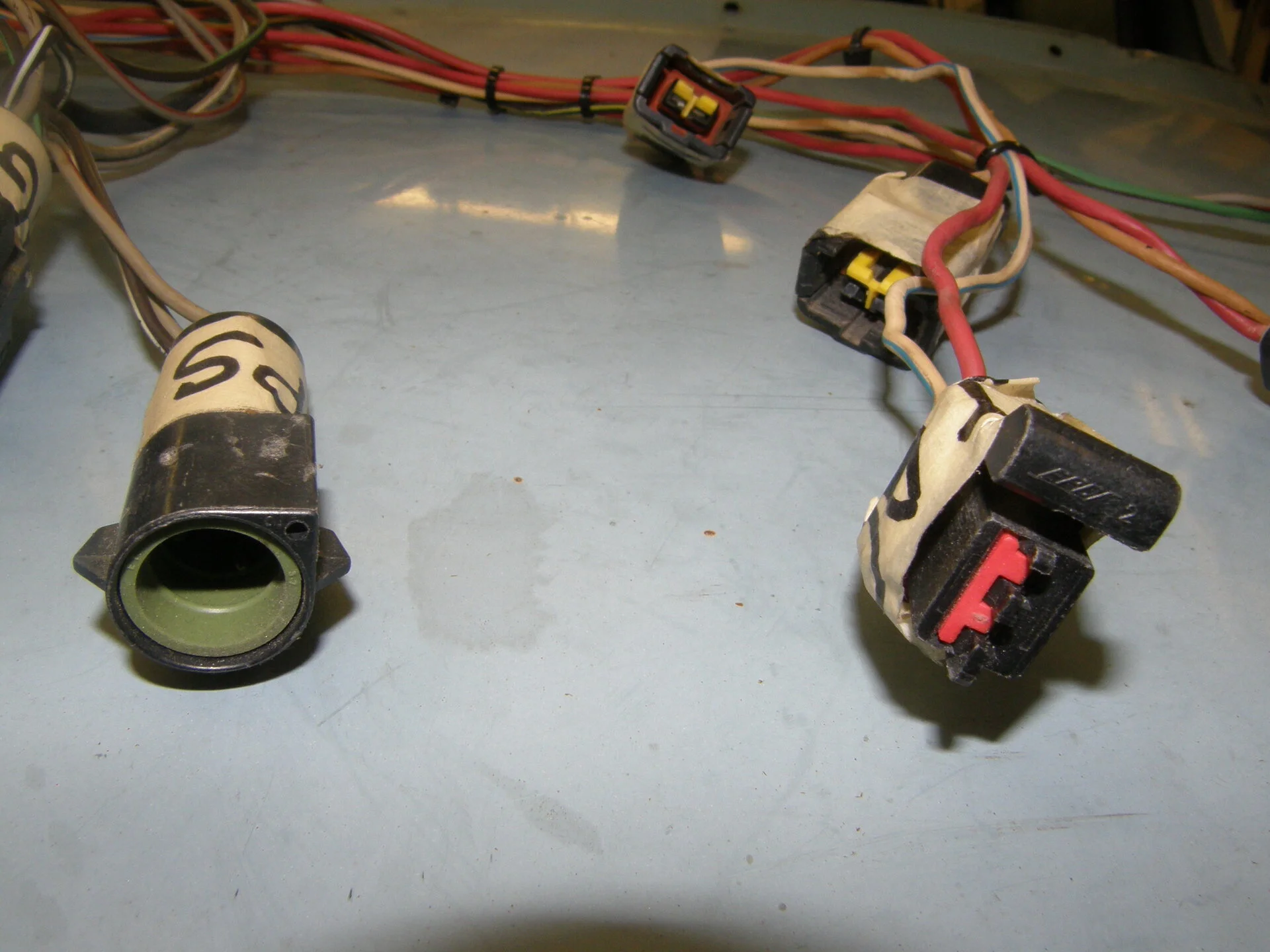

Can someone show me where the Idle Air Bypass Valve plugs into. Looking to follow the wires on where it plugs in down stream. Also, looking for the Throttle Position Sensor. It's like the plugs simply disappeared.
The IAC plug (on the right) is probably tied in with the injector harness pass side and the TPS plug (on the left) is probably wrapped up with the EGR plug.
