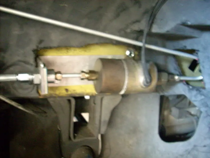

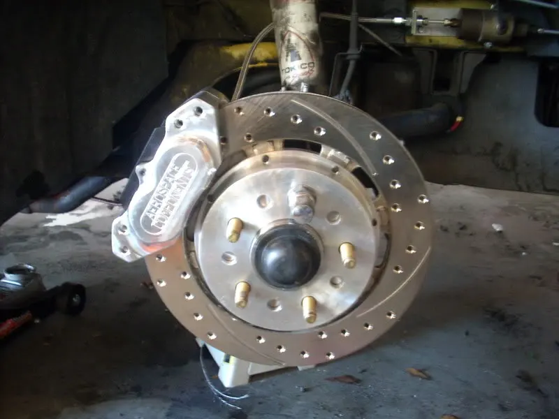

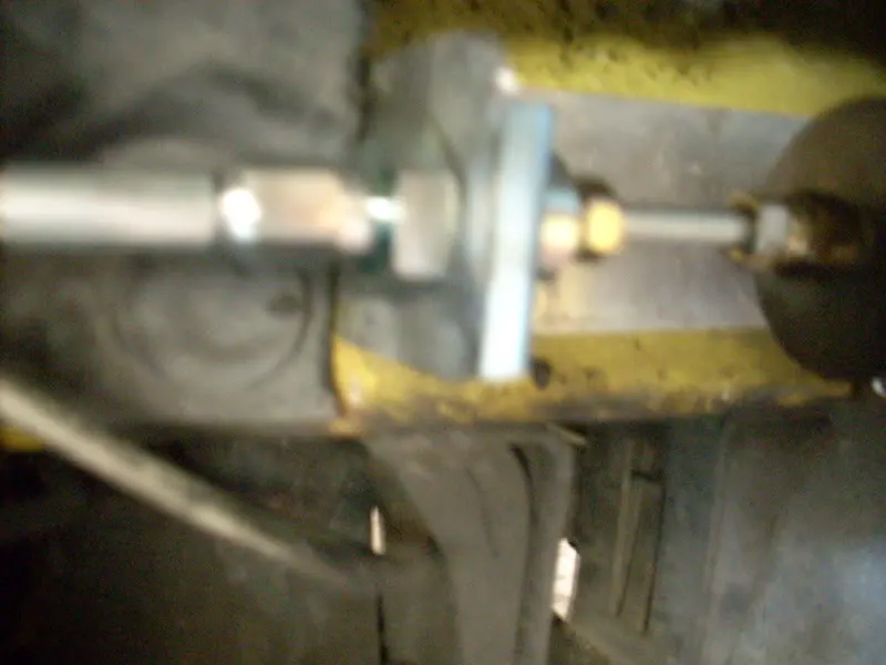

It's kind of a pain in the butt. The best way to do it is to put one line lock on each of the front wheels right before the brake hose. If you put a single line lock upstream, you ended up trapping a lot of fluid in the line which is suposed to be bad for some reason. Anyway, you can get generic Summit line locks for about $45/each, and they work just fine. You will end up having to cut and flair a lot of break line to do it. My factory brake hose brackets got lost a long time ago, because I kind of did a crappy install which deleted the brackets. I finally went back and cleaned it up, and fabbed up some new brackets. Here are some pics.
