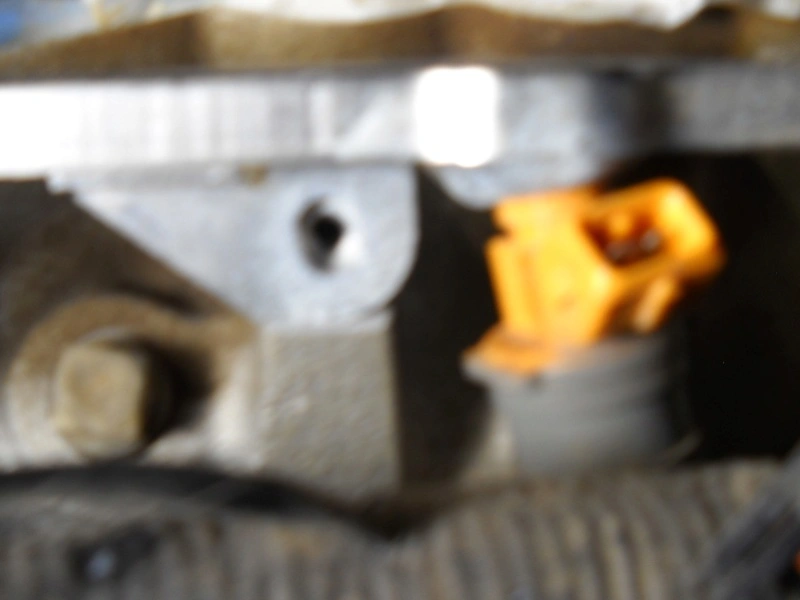

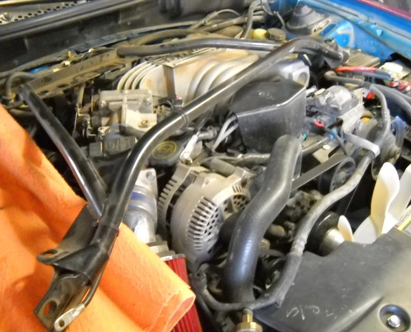

Here's the big brace I found under the hood, unfastened, to allow raising the upper manifold.

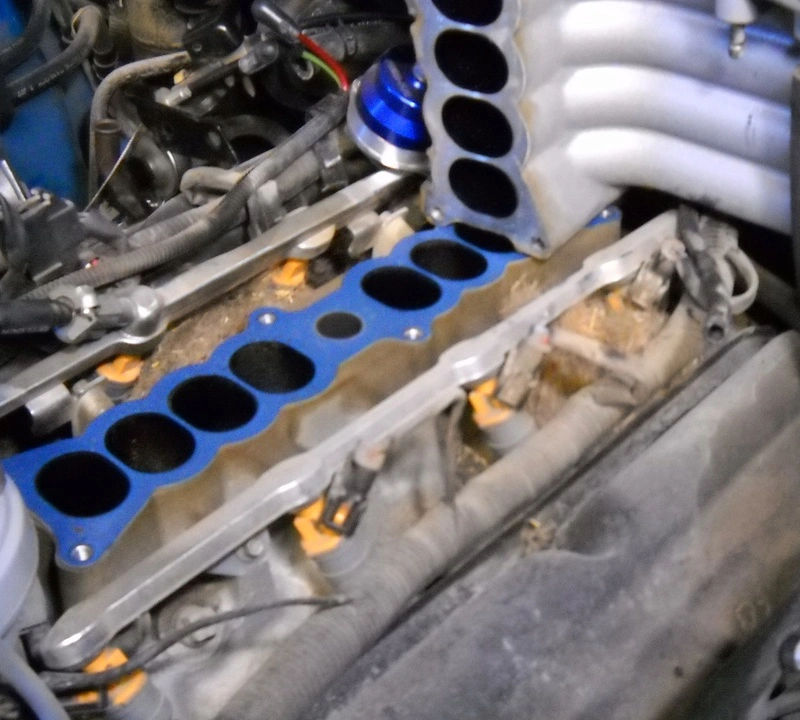

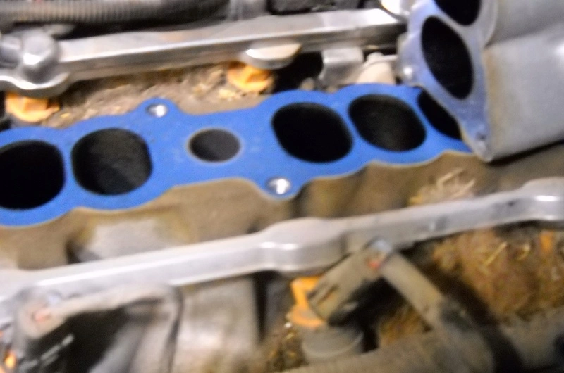

Shocked by what I found when I raised up the manifold! Two big mounds of hairy stuff, obviously rodent nests. I sucked it all out with shop-vac, two "thumps" indicated probable mummified remains. This was very common in Missouri, but I've never seen it before in the Desert, after a total of 25 years here! The car may have spent time elsewhere, of course, but was originally titled in CA.

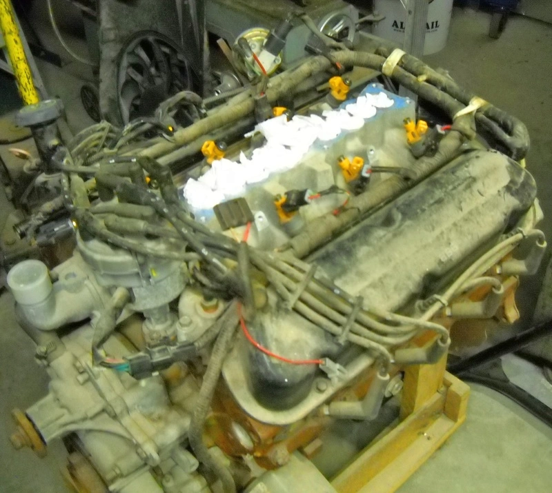

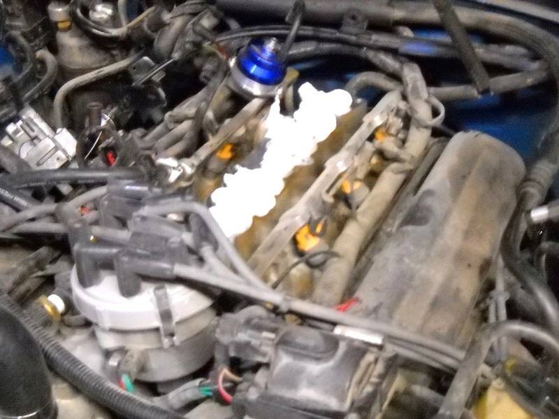

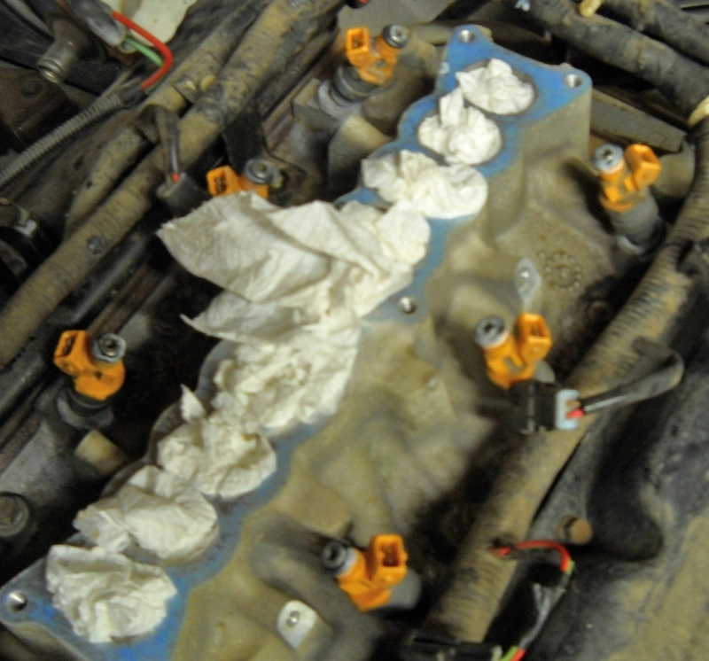

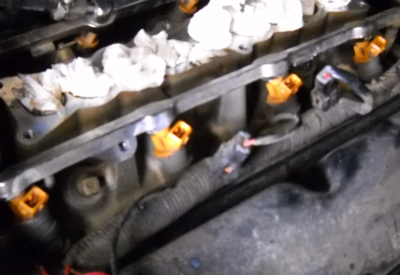

Manifold out of the way, I will raise fuel rail up off of injectors, but not remove it from the car, then remove injectors one by one, this all after first blowing out any remaining debris, dust, etc. with compressed air. The bright white blow-out is paper towels, protecting ports.

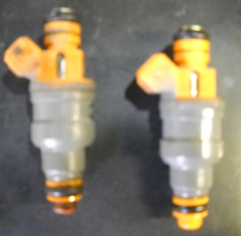

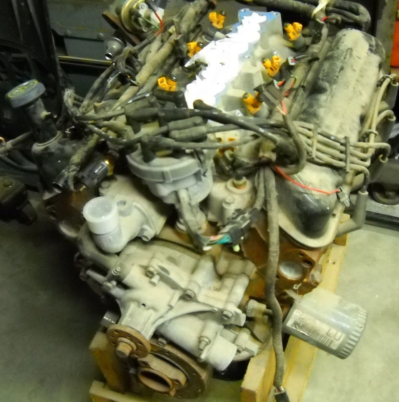

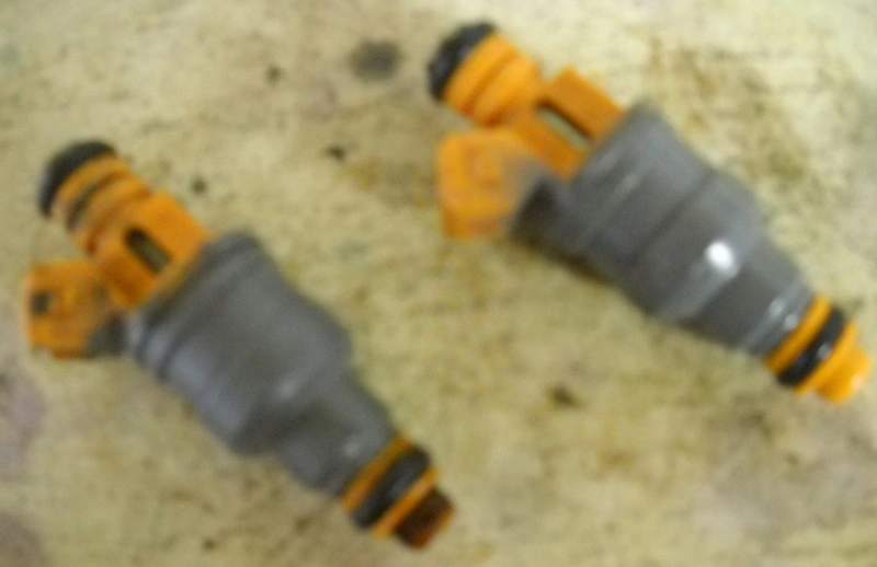

Here's the new injectors! Believe that hulk is brand-spanking new? Followed me around the country for 20+ years, about time it's put to good use! Note how Ford ships new engines: The thermostat housing still has a plastic cap over it. So do the fuel rail connections. Every possible opening into the engine was protected in some way. Oil pan filled at assembly point. Note gray no-name Ford oil filter also supplied.

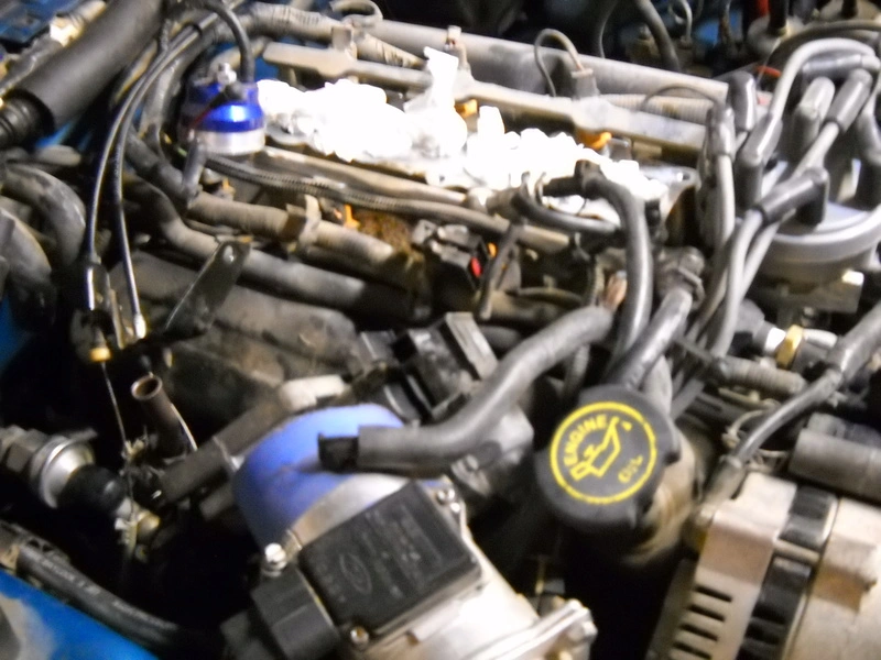

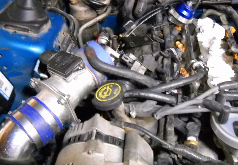

Notice the fuel rail has been removed and set aside. Cleanliness (?!!) is important.
