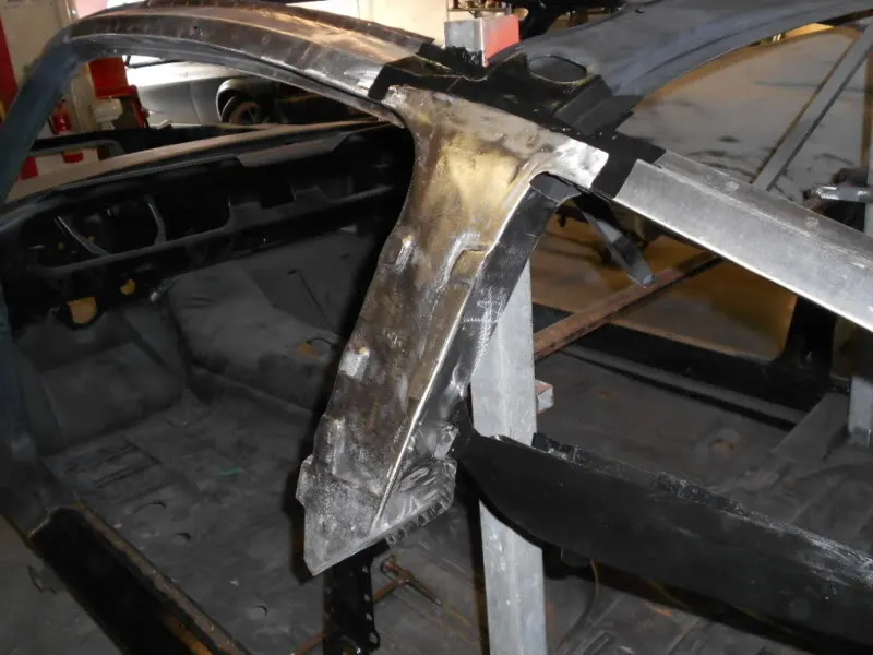

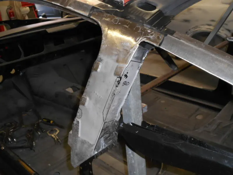

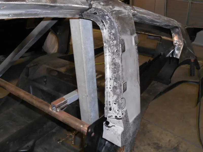

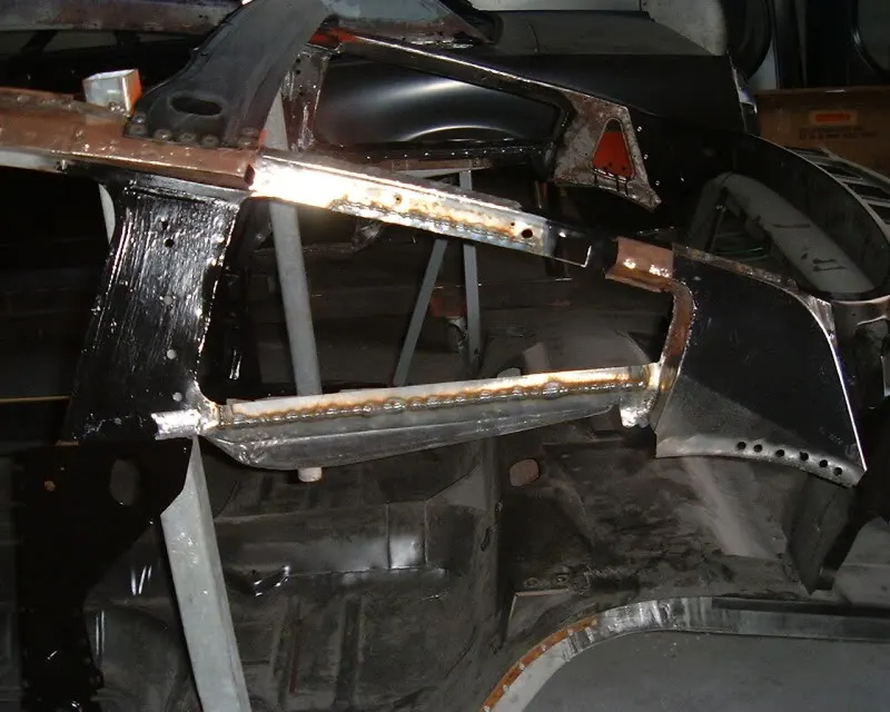

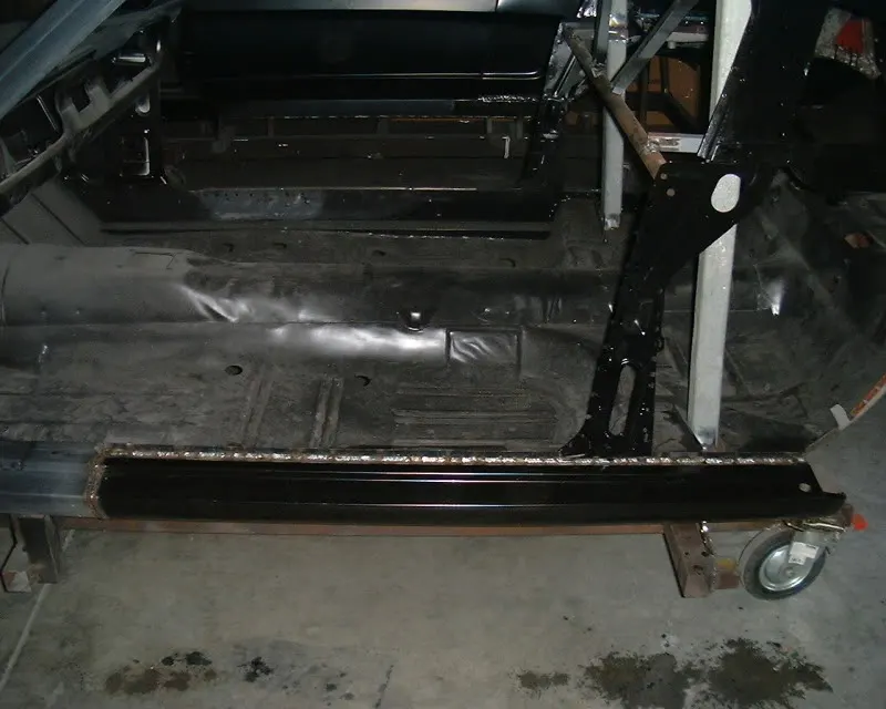

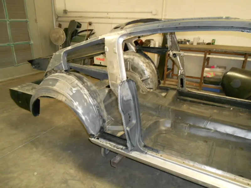

    Brian replaced the left rocker
    [IMG]
    Starting to repair the left quarter panel inner structure
    [IMG]
    [IMG]
    [IMG]
    [IMG]
    [IMG]

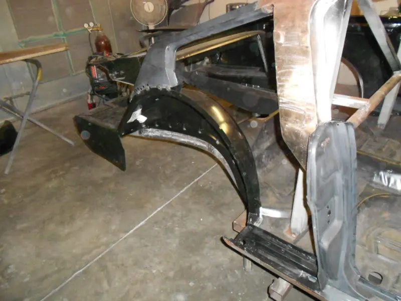

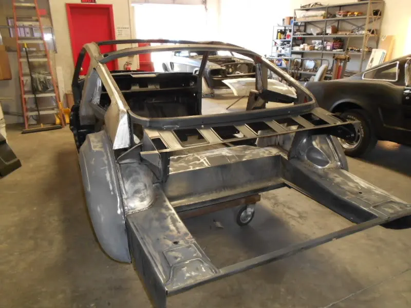

    More rust repair

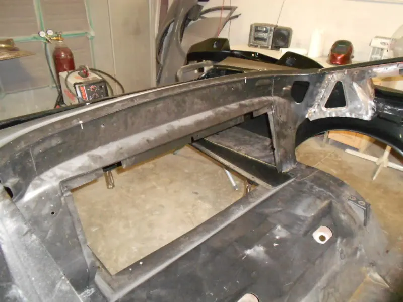

    Test fitting the sheetmetal before welding in the rear package tray panel

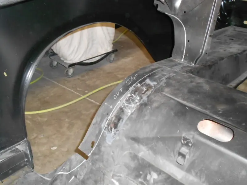

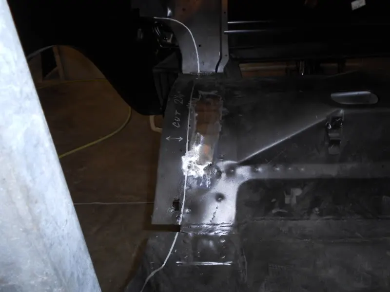

    Marking the area that needs to be cut out for the Graverobber wheel wells

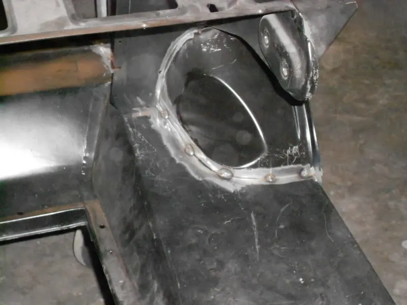

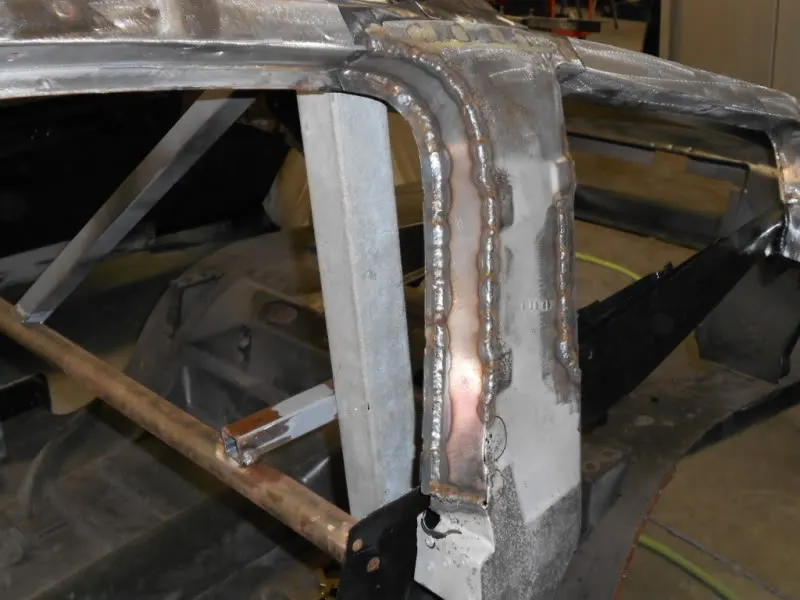

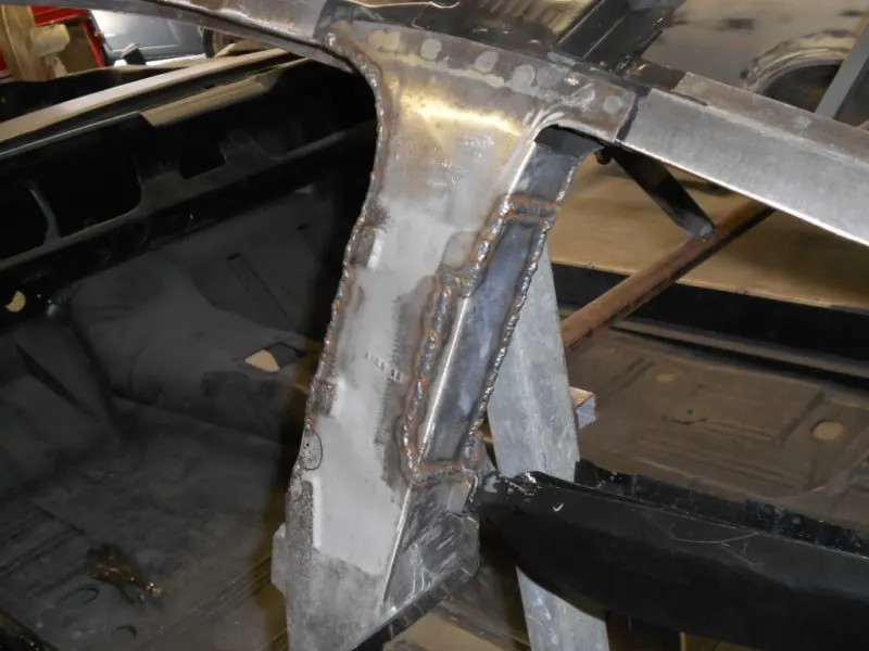

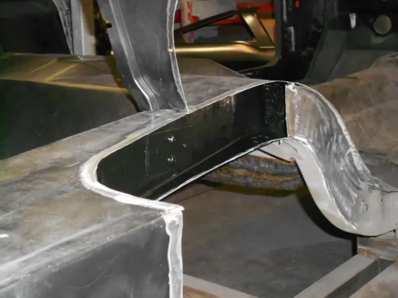

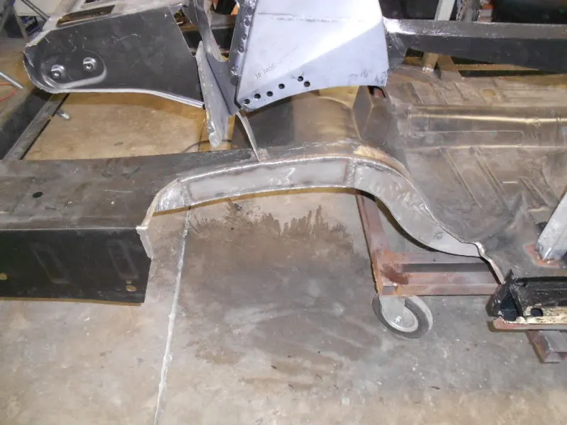

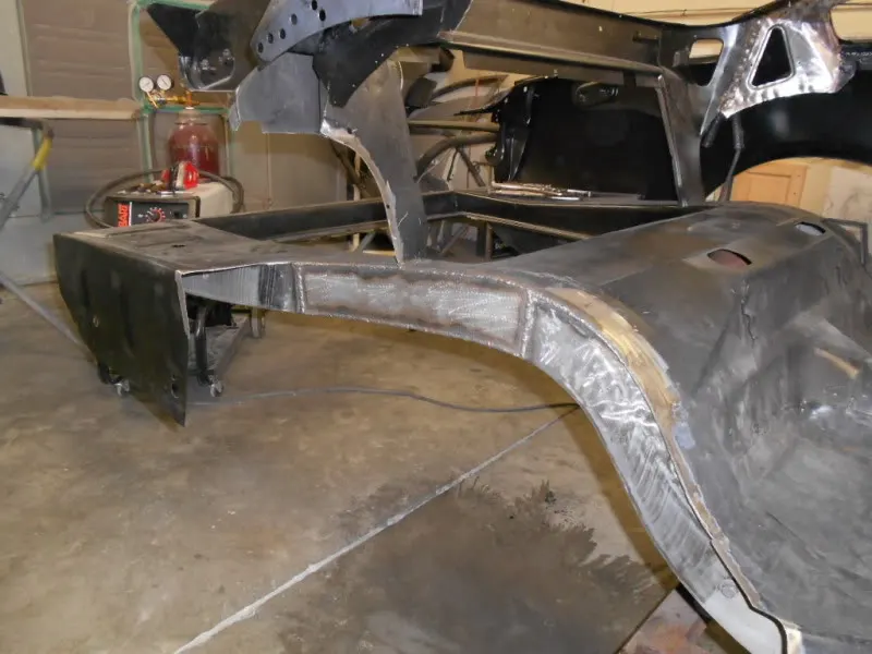

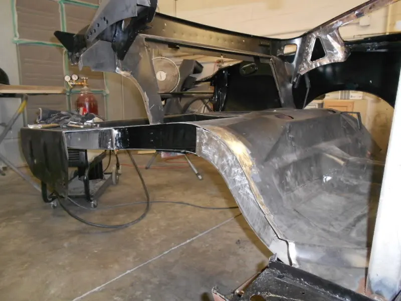

    The frame rail was notched and epoxy primed inside
    [IMG]
    [IMG]

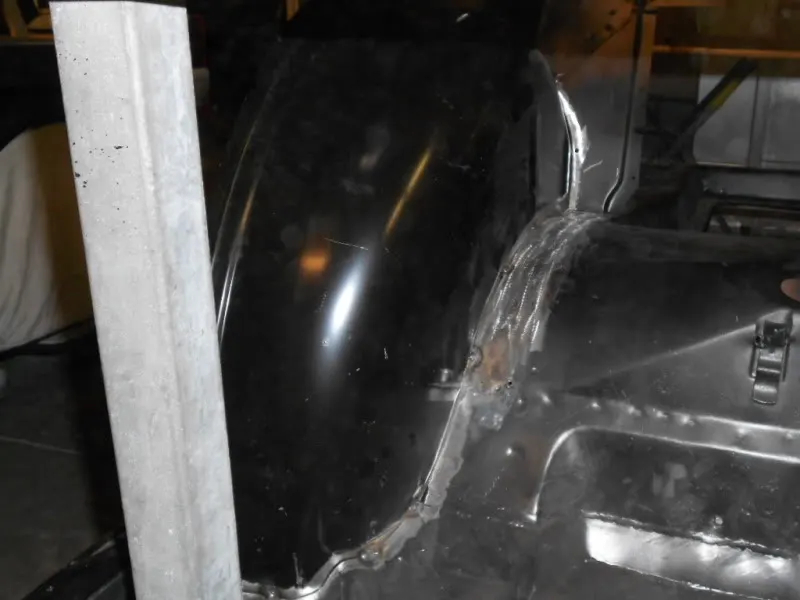

    Patch welded in place
    [IMG]
    [IMG]

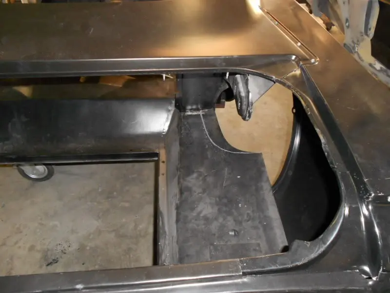

    Ready to install the right inner tub
    [IMG]
    Tack welded in place
    [IMG]
    [IMG]
    [IMG]

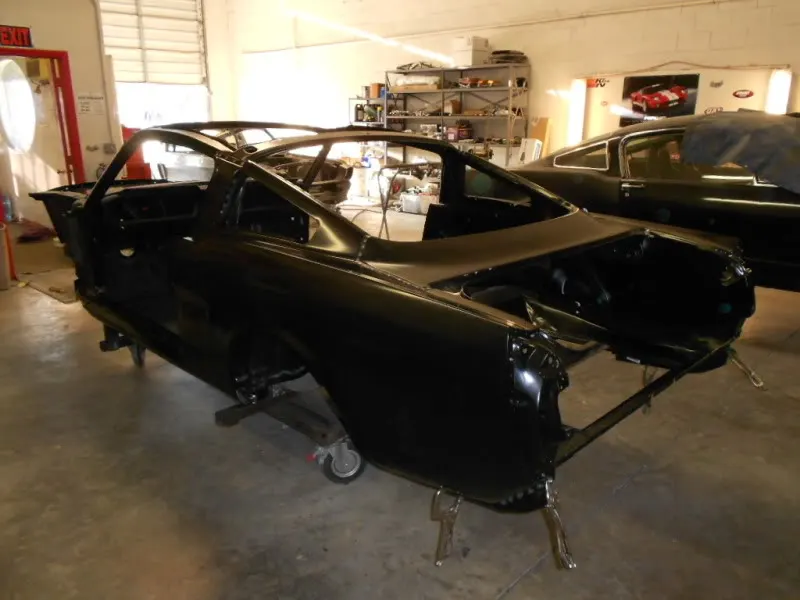

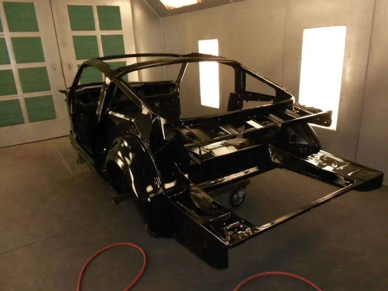

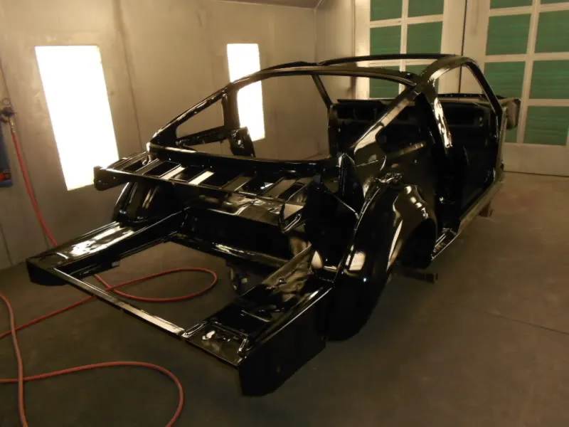

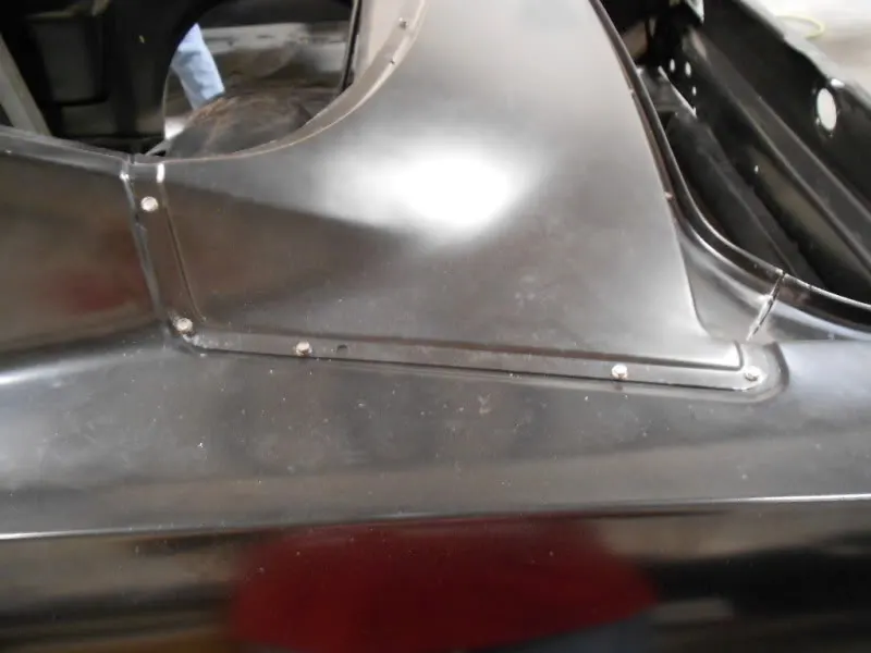

    Today Brian finished sanding and I sprayed two heavy coats of SPI epoxy.

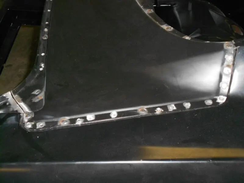

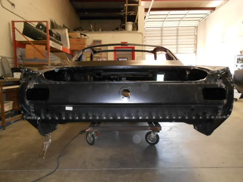

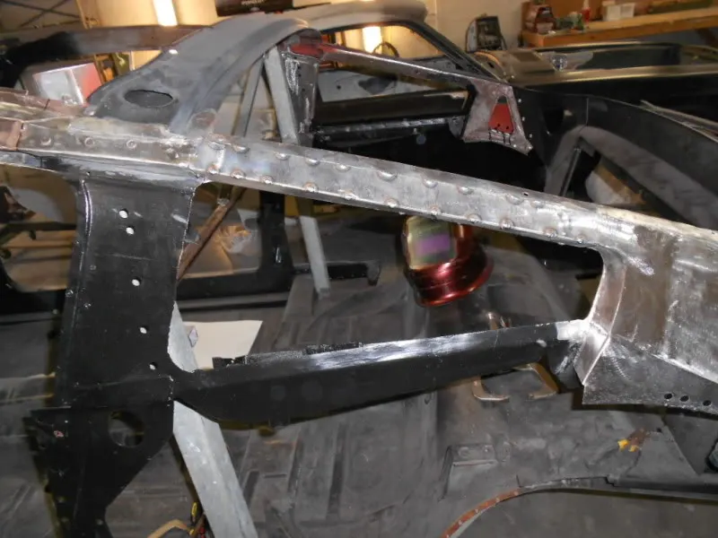

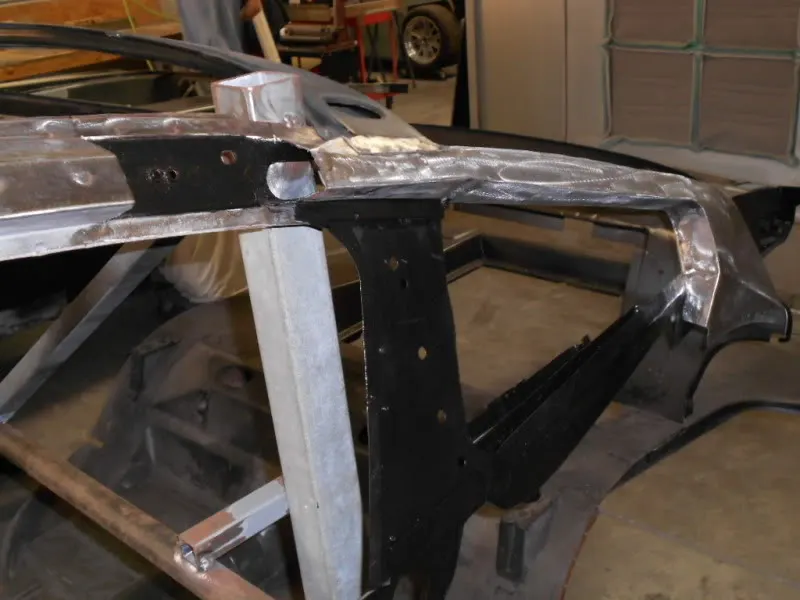

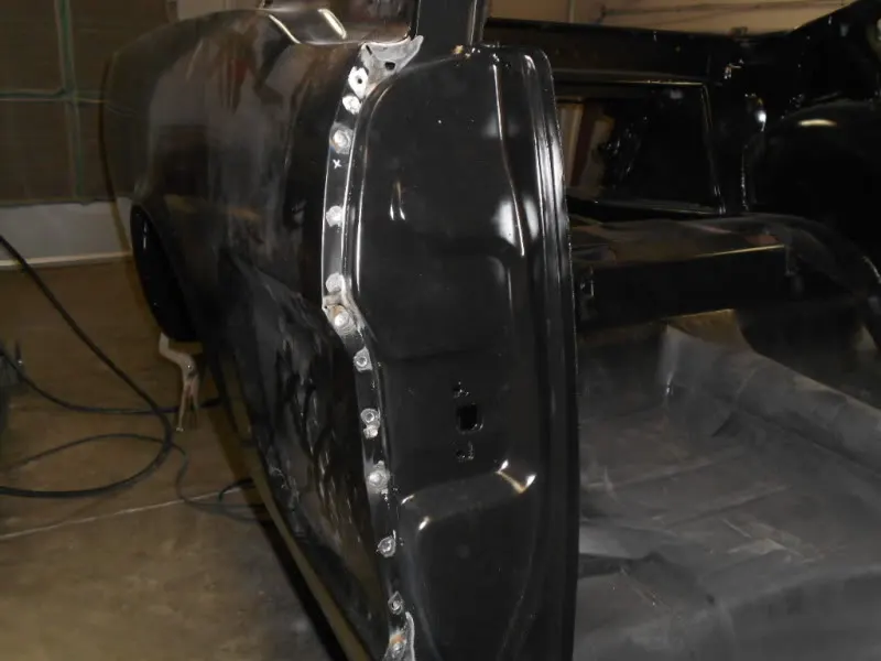

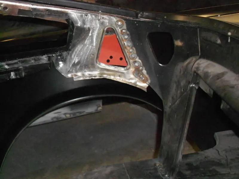

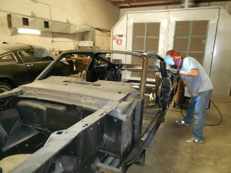

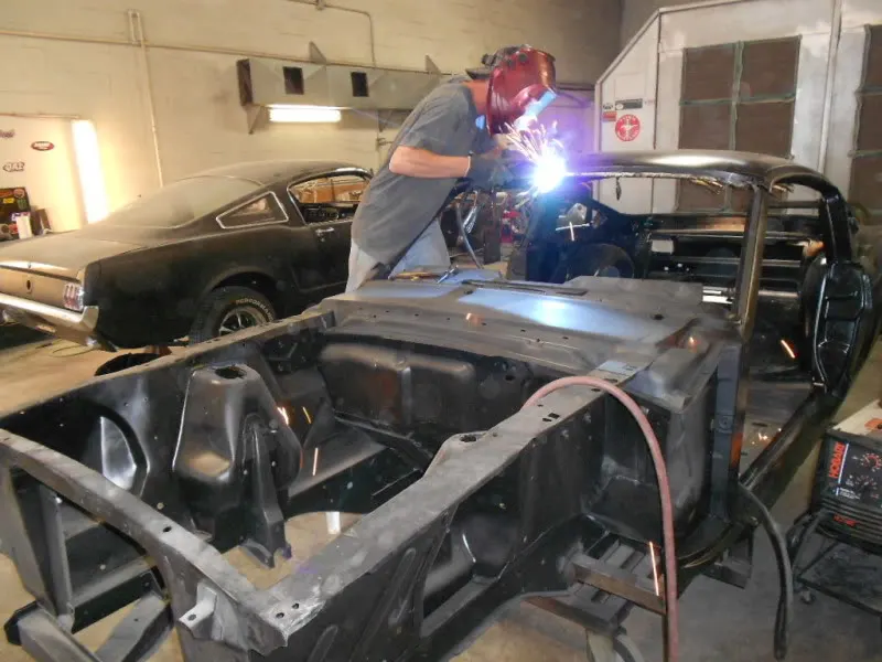

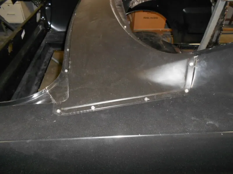

    Brian is lining up the sheetmetal with screws for the last time after he drilled holes for the plug welds
    [IMG]
    Starting to plug weld
    [IMG]
    [IMG]
    [IMG]
    [IMG]

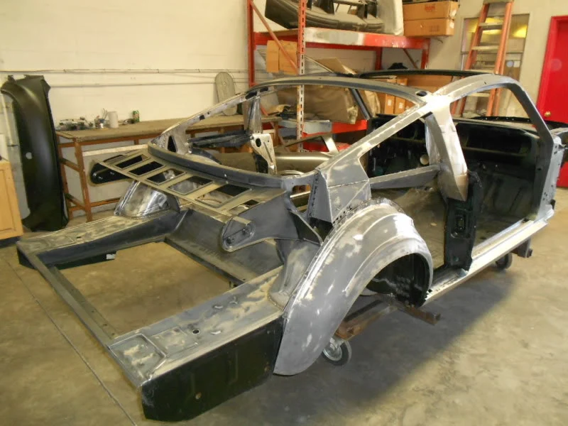

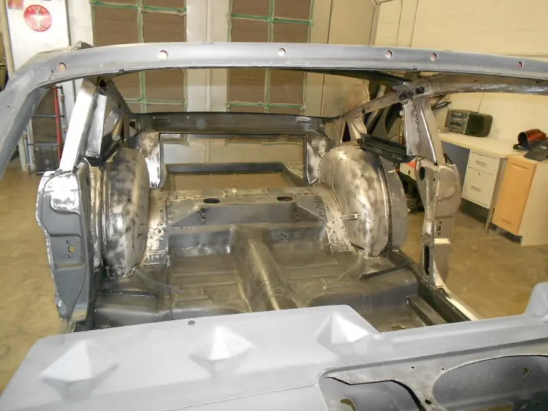

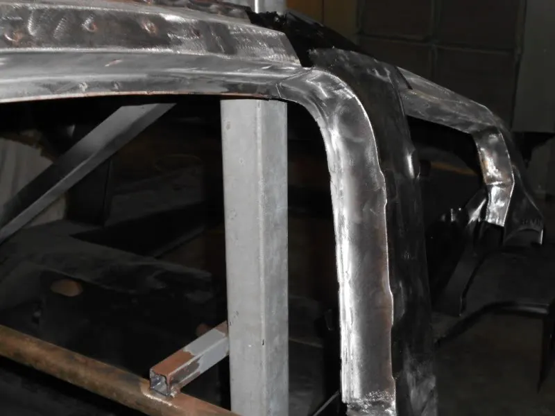

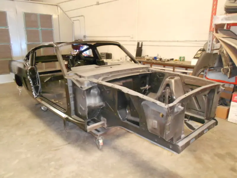

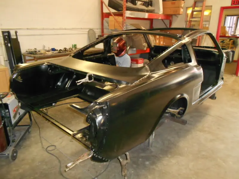

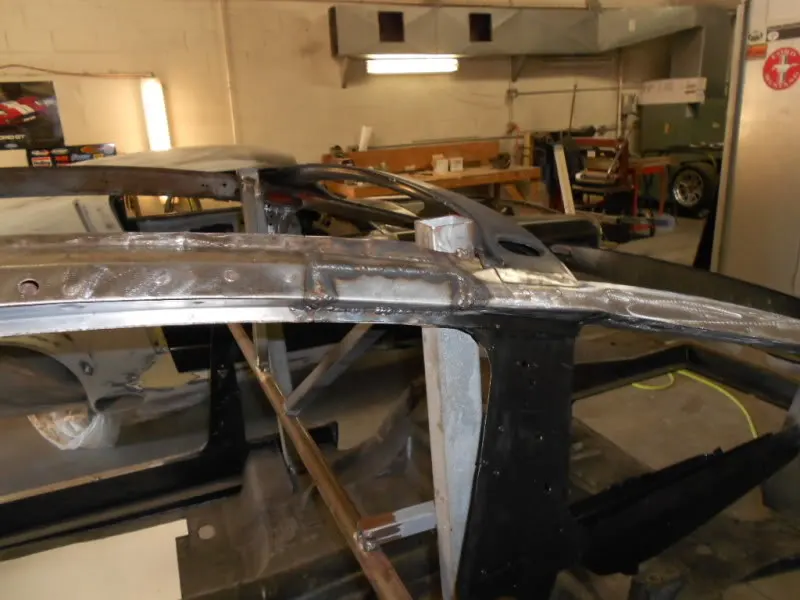

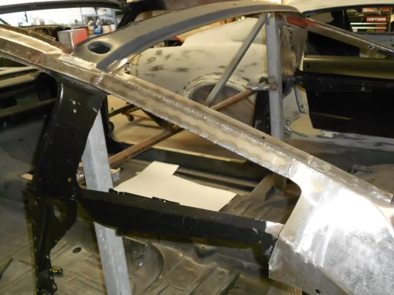

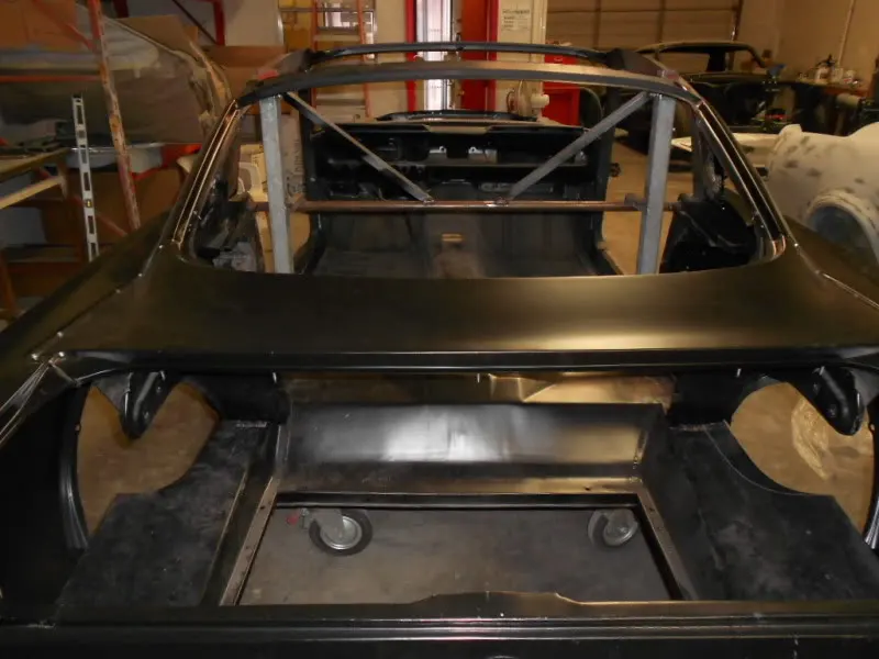

    Brian has everything back together except welding on the roof.
    [IMG]
    [IMG]
    [IMG]
    [IMG]

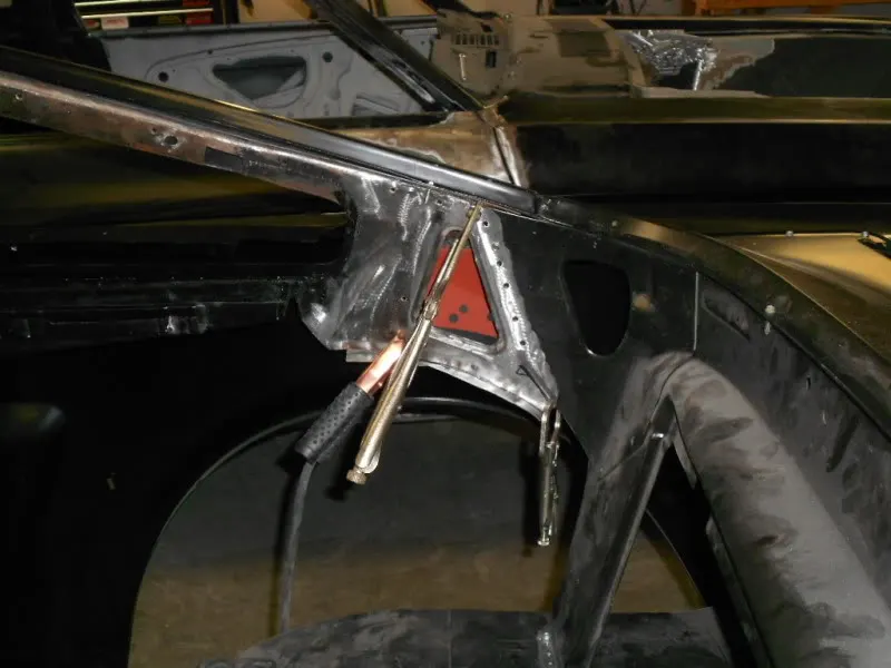

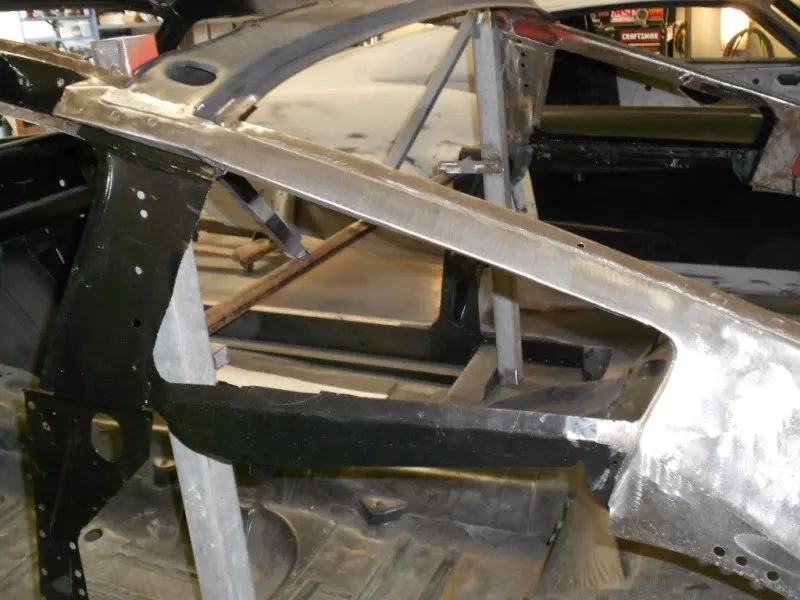

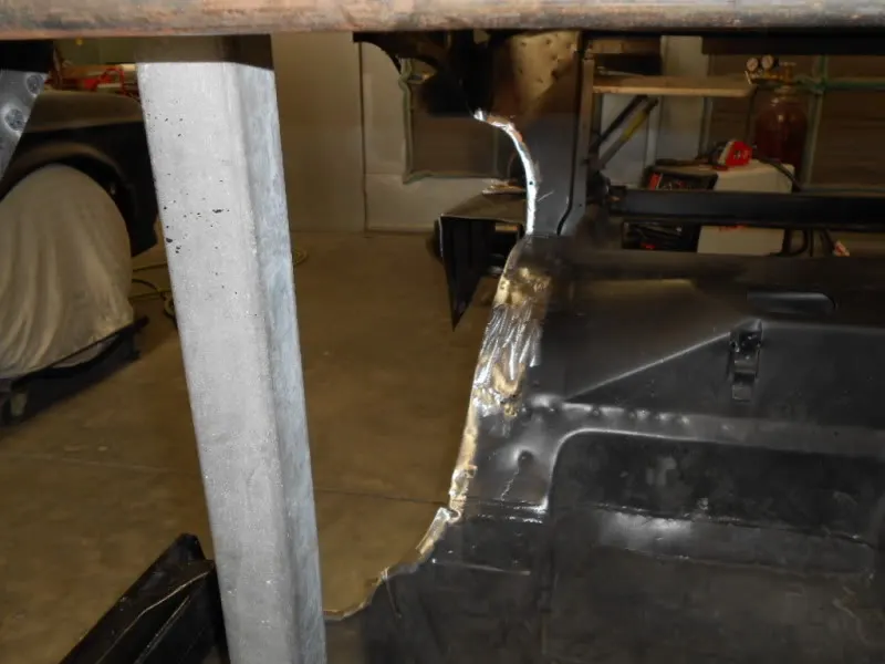

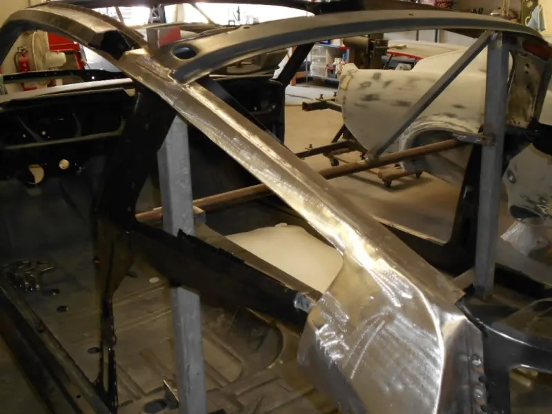

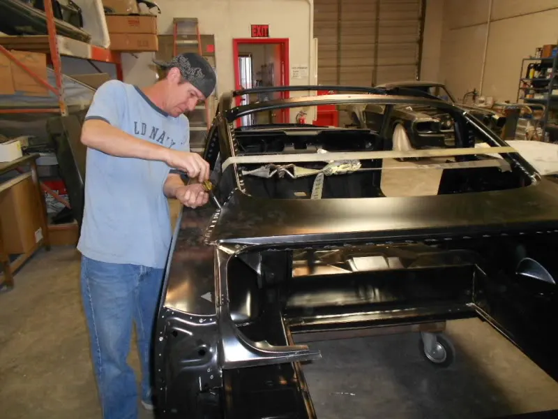

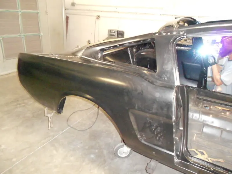

    Brian attaching the roof. Now he has to repair some rust in the corners and where the drip rail was.
    [IMG]
