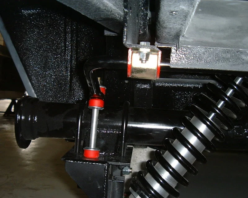

    I assume you'll be running a fuel cell with the FI anyway but just in case you didn't notice that rear sway bar will prevent you from using the stock fuel tank.
  4. I will be using the stock tank. I bought the second kit Rod & Custom made and they sent the wrong sway bar. Here is the correct one that is in front of the tank

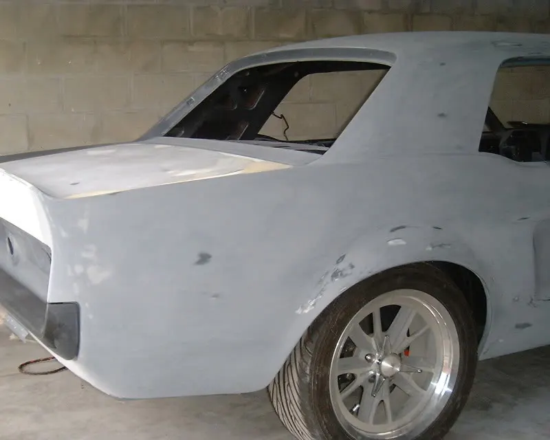

  7. More block sanding it's getting closer.

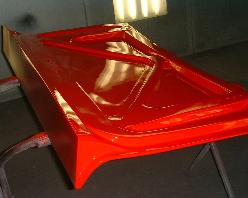

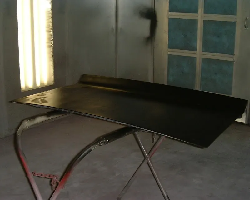

  8. I finished block sanding the deck lid trying to get it to match the quarters and than epoxy primed
    Sprayed SPI Turbo primer

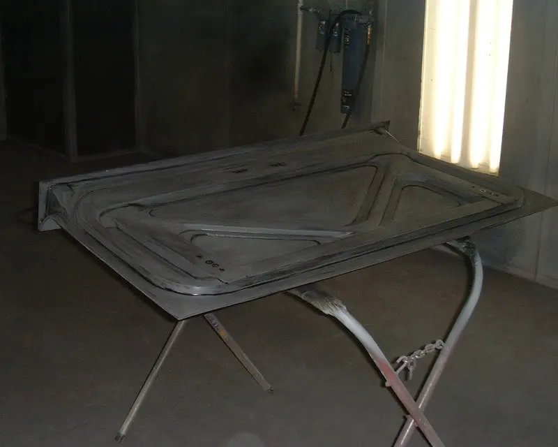

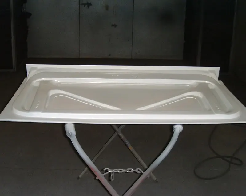

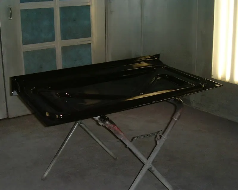

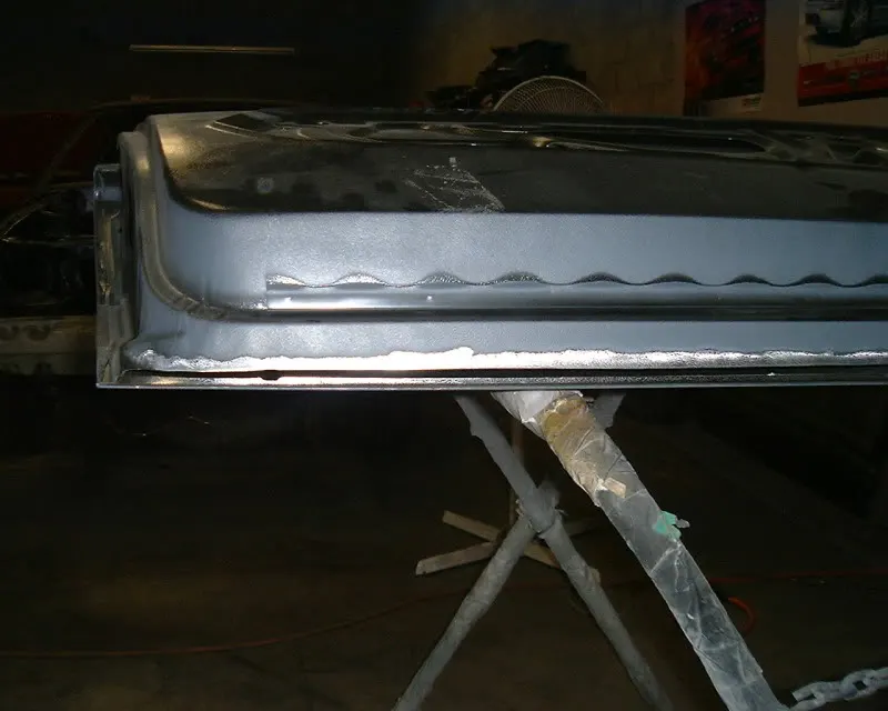

  9. I spend most of the day working on something that you don't see 95% of the time the back of the deck lid.
    I finished sanding and than epoxy primed
  10. I bought the first - same deal - had to swap the sway bar.

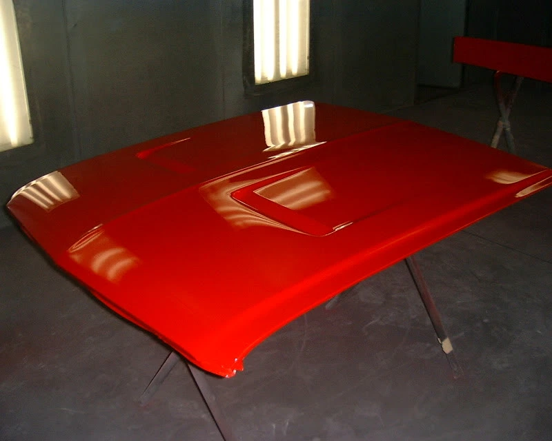

    You wouldnt happen to take kidneys for payment would you?

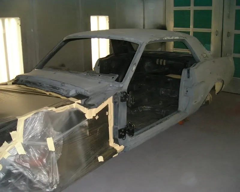

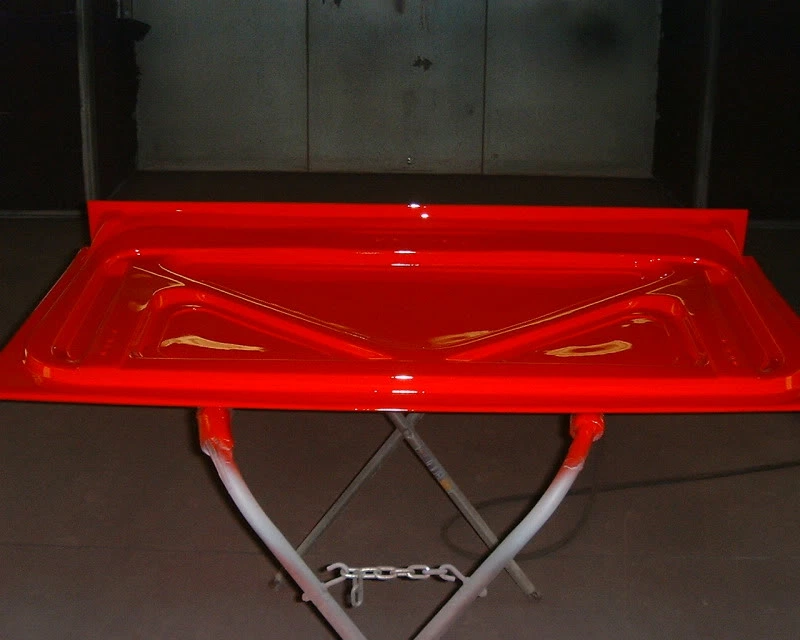

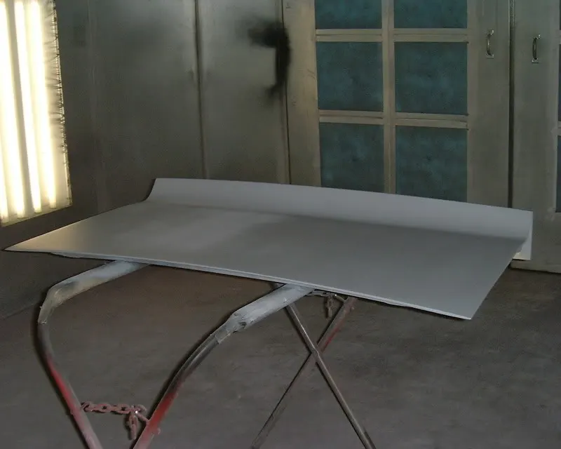

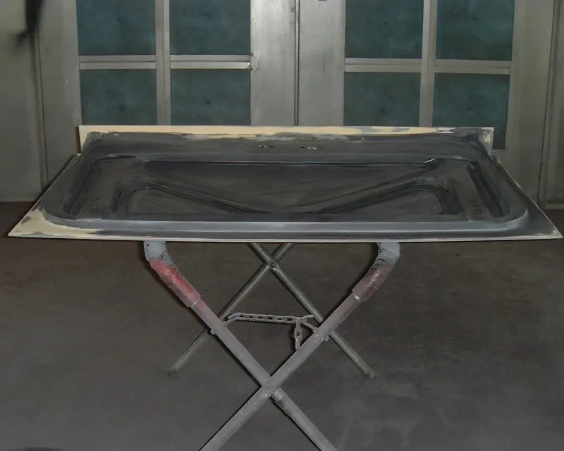

  12. Today I sanded the deck lid than sprayed a coat of SPI white epoxy
    I waited a couple of hours than sprayed 3 coats of SPI single stage red.

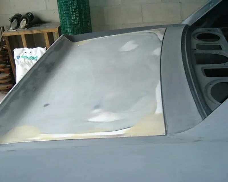

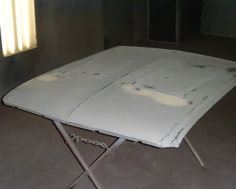

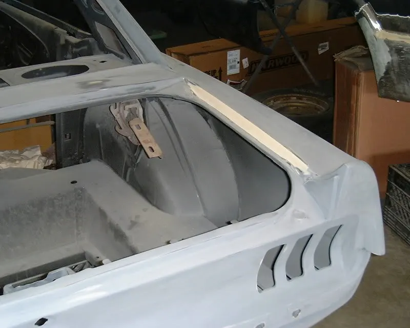

  13. I was not happy with the hood after block sanding. I added a little filler than epoxy primed again.
  14. I block sanded the hood again and epoxy primed white next I need to sand and paint the back side of the hood.

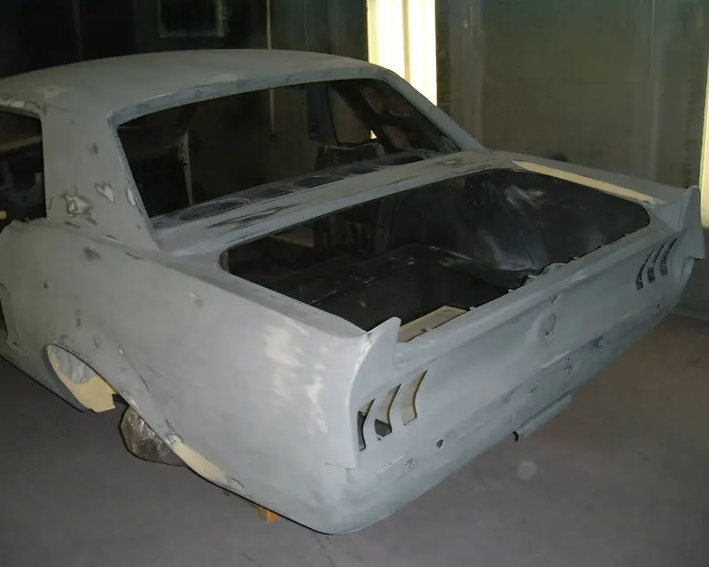

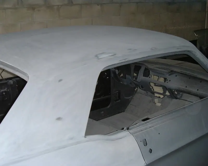

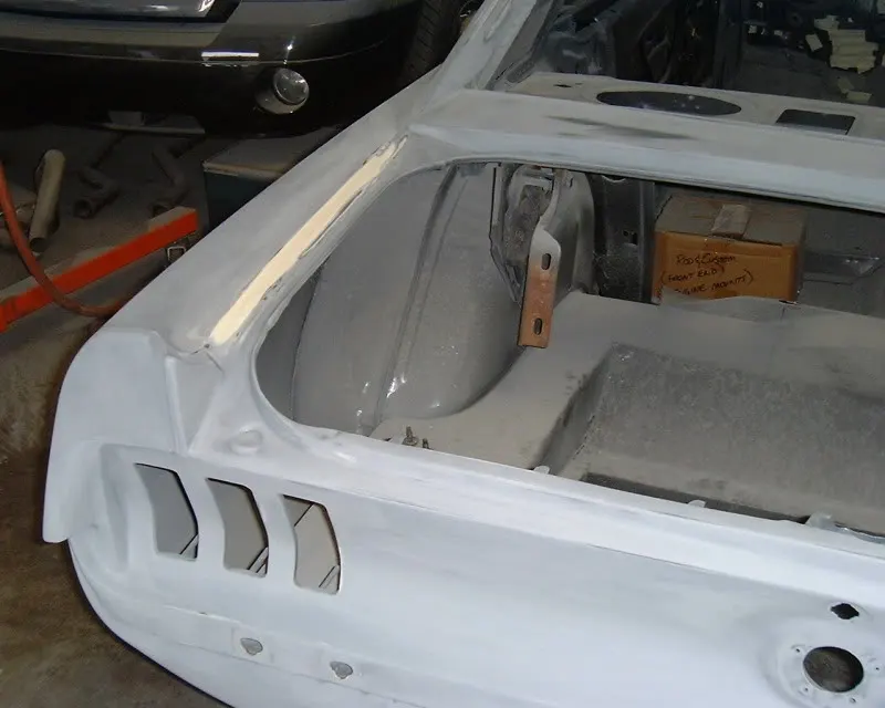

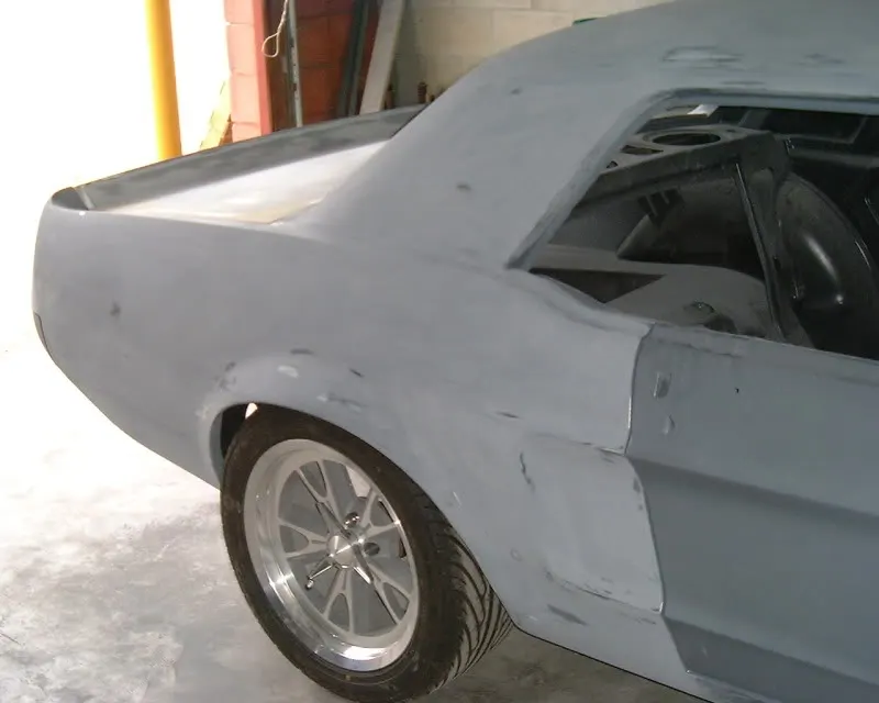

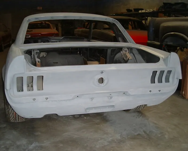

  15. It has been awhile since I got to work on the 68 so today I decided to add a little filler to each quarter to tighten the gap on the fiberglass deck lid and I block sanded the roof and taillight panel.

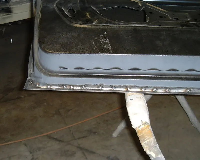

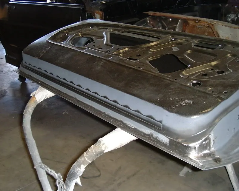

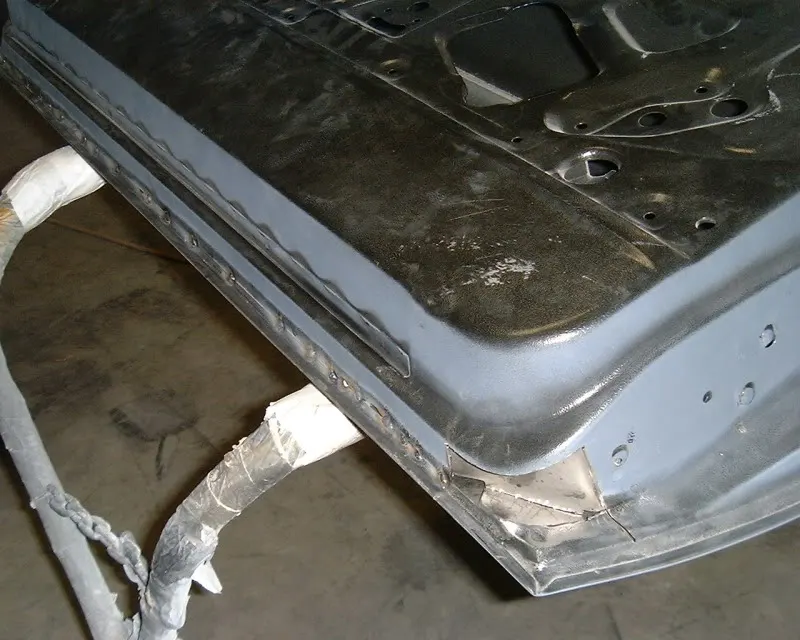

  16. We had a problem with the drivers door sticking out 1/4" at the bottom even after elongating the holes in the hinge. We cut 1/4" out of the bottom of the door.
    Brian had to cut out a section to get at the inner brace to cut it. After the brace was welded he brushed some epoxy primer than welded back in the piece he cut out.

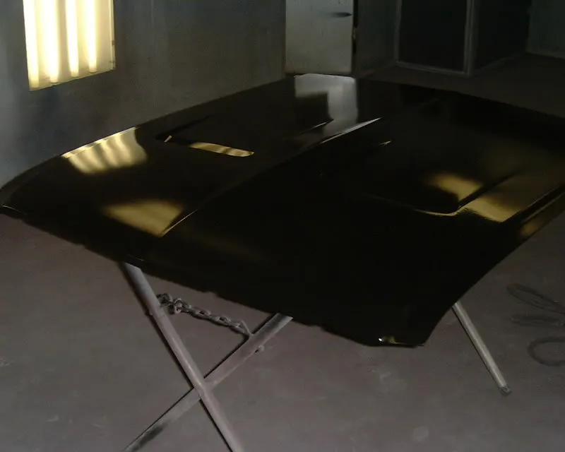

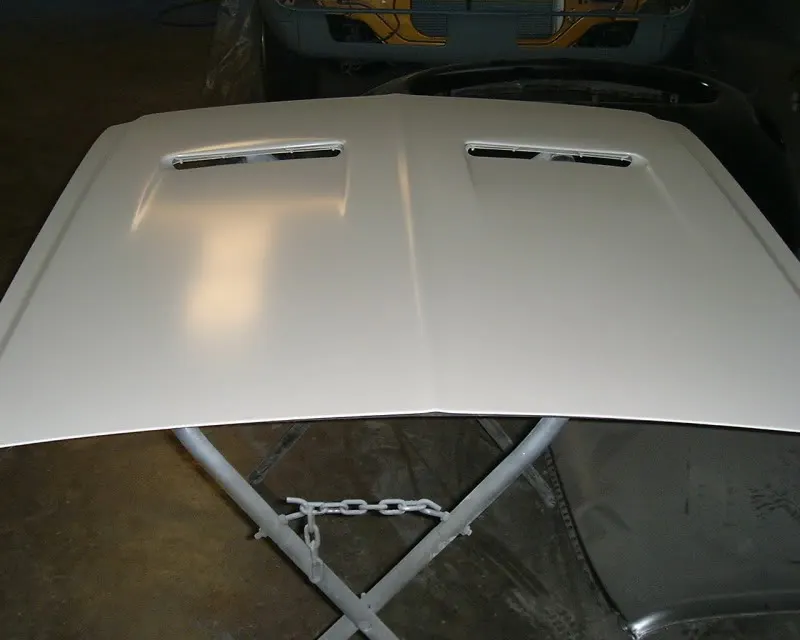

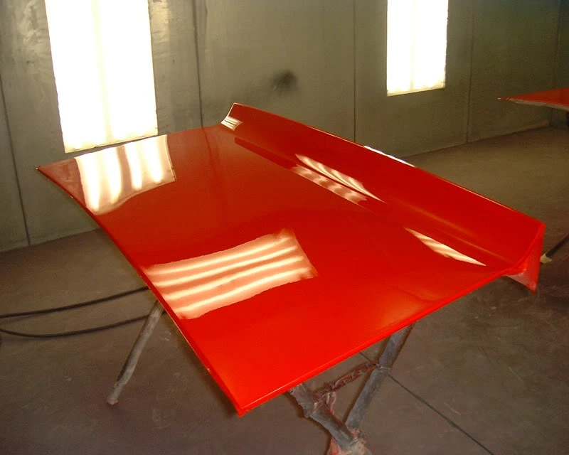

  17. I sprayed SPI Red yesterday on the hood and deck lid and the clear today. I will wet sand and than spray 3 more coats of SPI Universal clear.
