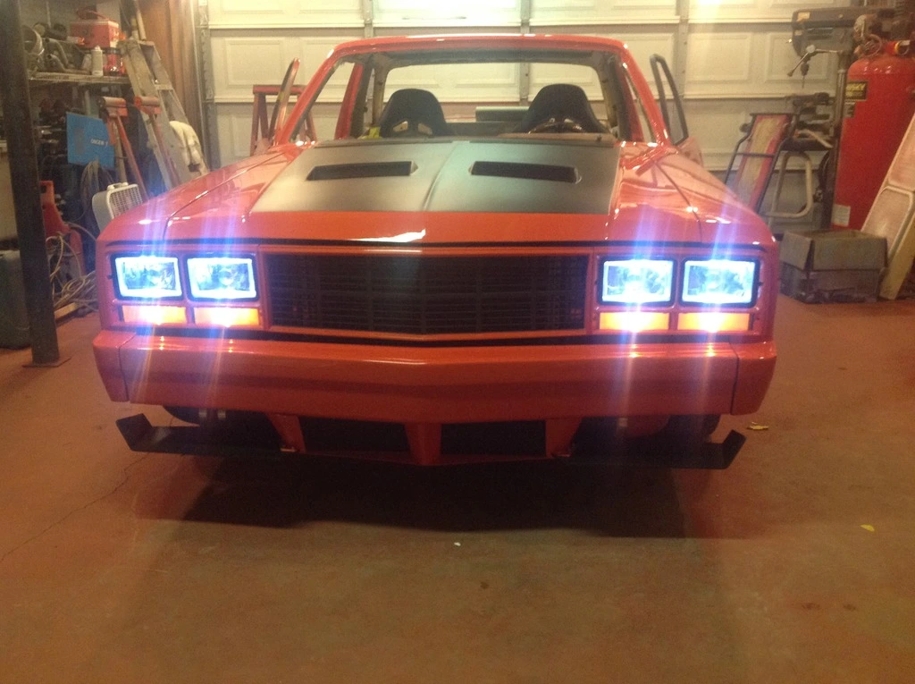

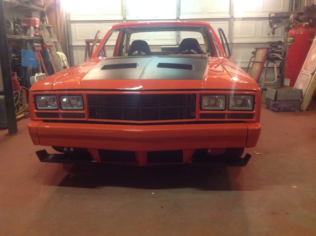

THE GRILLE:
The painted parts that have been hanging for months, labeled as "good to go" are not exactly good to go.
Several things are/maybe wrong with them, starting with the obvious:
#1. The grille surround, and the headlight bezels are only painted on the facing side. When mounted, you can see "unpainted" area.
The solution to that is to mask that area, and paint it satin black, as that is what the unpainted areas are butting up against.
Alot of nit-picky detail masking.
#2. There is texture (orange peel) on some of those surfaces......Not so much on the front facing sides, but on the lesser horizontal spans around the headlights.
Anndd......The solution to that is some 2000 grit wet sanding and a little hand rubbing.
More nit-picky crap.
#3. I'm concerned that I may not have applied enough paint to the pieces.
Do I even have to say what the solution is here?
#4. It looks like there is a color mismatch from the rest of the car.
I'll know better when it's all out in the sun.

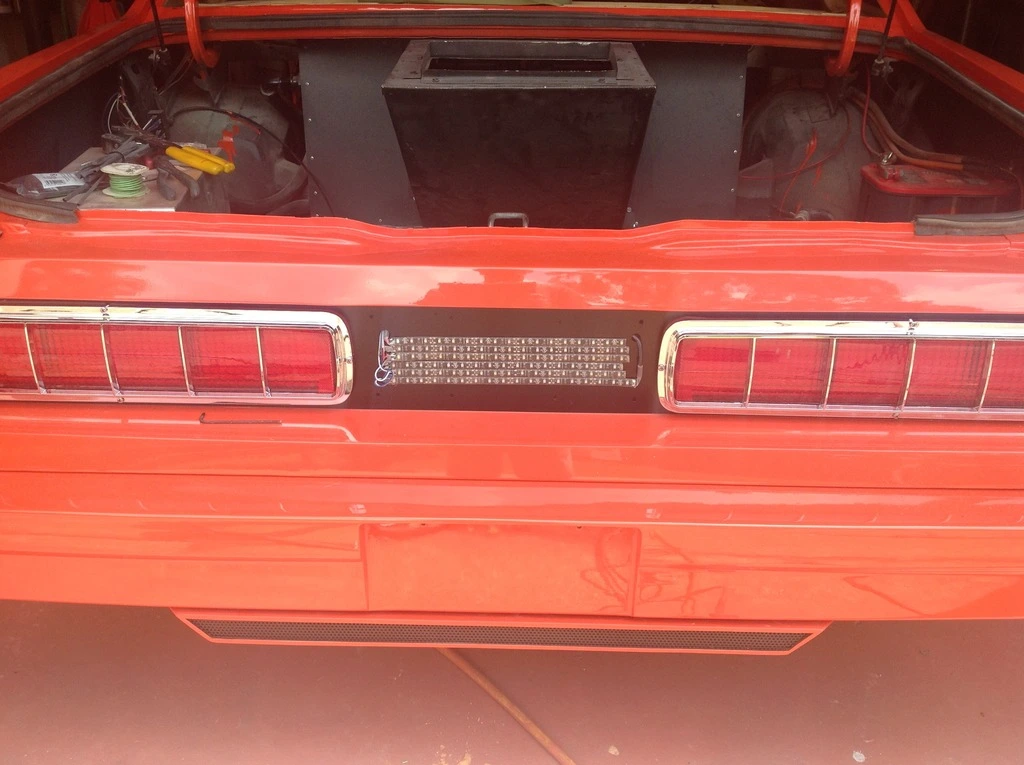

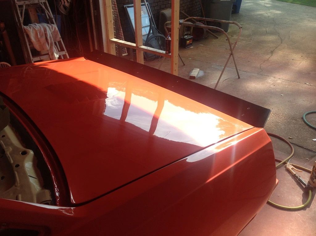

THE TAIL.
Somewhere in this garage is some more of those led strips that I ordered about 6 months ago when I made that center piece that goes between the tail lights. Right now, all I can find of them are 3 sections of white, and one piece of red. The original plan was to make it so that the word CYCLONE will serve two "masters of light", and I'd just stick rows of those strips in alternating order, so that I'd have it work as a tail light in running mode, and as a back up light (purely to satisfy the safety inspection when I attempt to license the car), when I stuff it in reverse.
( It's just a damn shame to have a $100.00 piece of laser cut aluminum that only works in reverse)
The problem is that it gets real crowded under that cover when I try that.
The option here is to make it either/or, not both, and be done with it. And the writing on the wall says that I have enough white strips. So why not just do what it is that you need to do to satisfy the inspection and be done with it?
( Isn't this me we're talking about here?

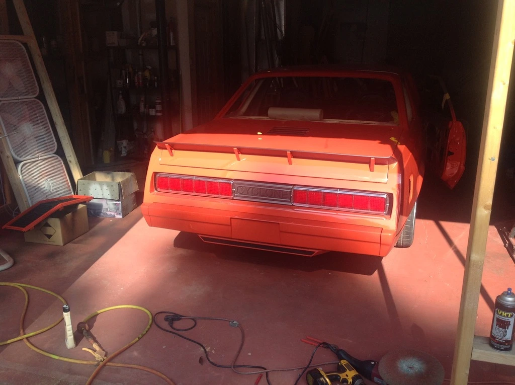

The Duck tail is painted and ready, but those stupid assed triangle shaped stand offs..........I can't get them painted properly.
I sprayed them orange, and got a reaction. (texture like dirt in the paint). So, I wetsanded that texture off. (Then I exposed raw edges at the corners) So I brush painted a coat or orange back on. ( Then I got my reaction back.) So I wetsanded that smooth again, anndd guess what happens? The sharp edges reveal again.
Why can't there just be a rattle can solution here?
So,...either way I go today,..I'm gonna have to dick around for a long time for what will amount to a small reward at the end of the day.
