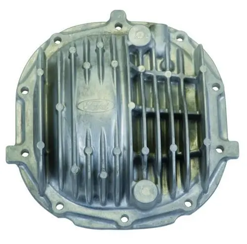

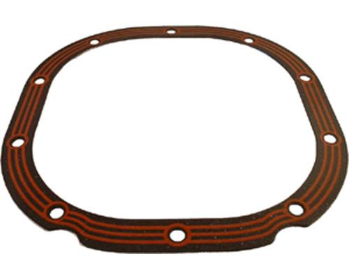

    my rear differential leaks. i took the cover off and replaced the gasket. still leaks. what are the odds cover or the diff its self and if its the diff what all do i need to replace to take care of it?

    IMO the odds favor the problem is a bent cover from over torque. Take the cover off and use a straight edge to check. If you are careful it might be possible to restore to "true" status by using a hammer and dolly.
    Reinstall using only silcone sealer (no gasket required). Torque to 28-38 foot pounds except the bolt holding the tag. Torque to 18-28 Foot pounds.

    I accidentally tweaked mine jacking the car up.....leaked like crazy....those cheap tin covers are junk.

    replacement cover shouldnt cost much if it is bent , but as stated above you can check it with a straight edge to see if its bent , when you reseal it next time torque it down in criss cross pattern and use silicone with no gasket thats how Ford sealed them from the factory
