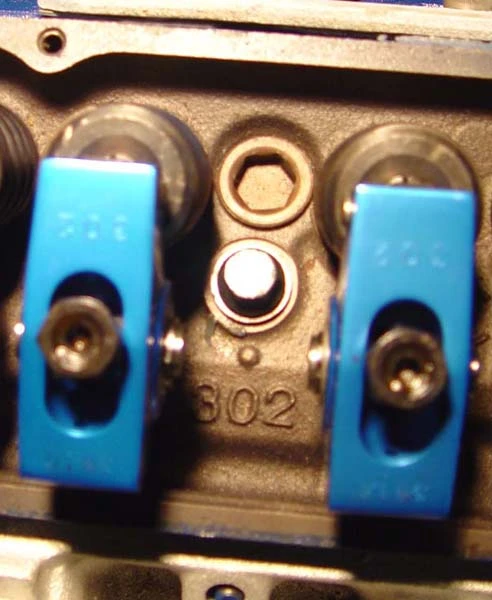

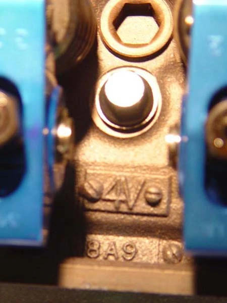

  5. that's not true
    the "j-code" cars came with a 4V head which had higher compression. I had one. If you take off the valve covers it should say 4V & 302 like this.
