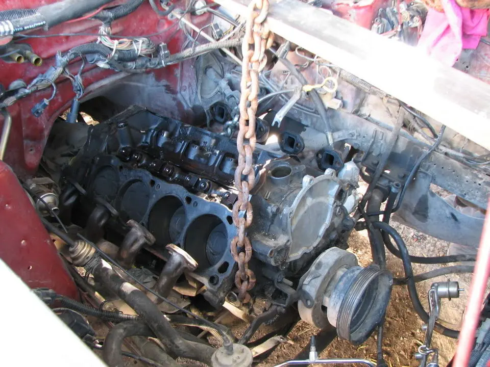

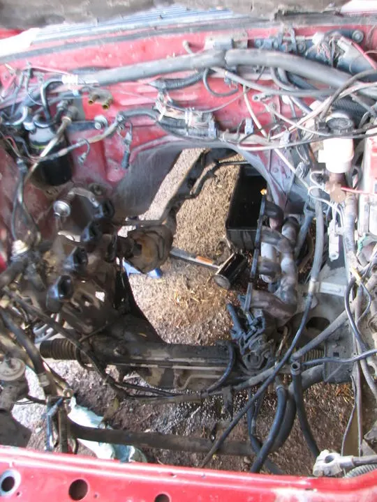

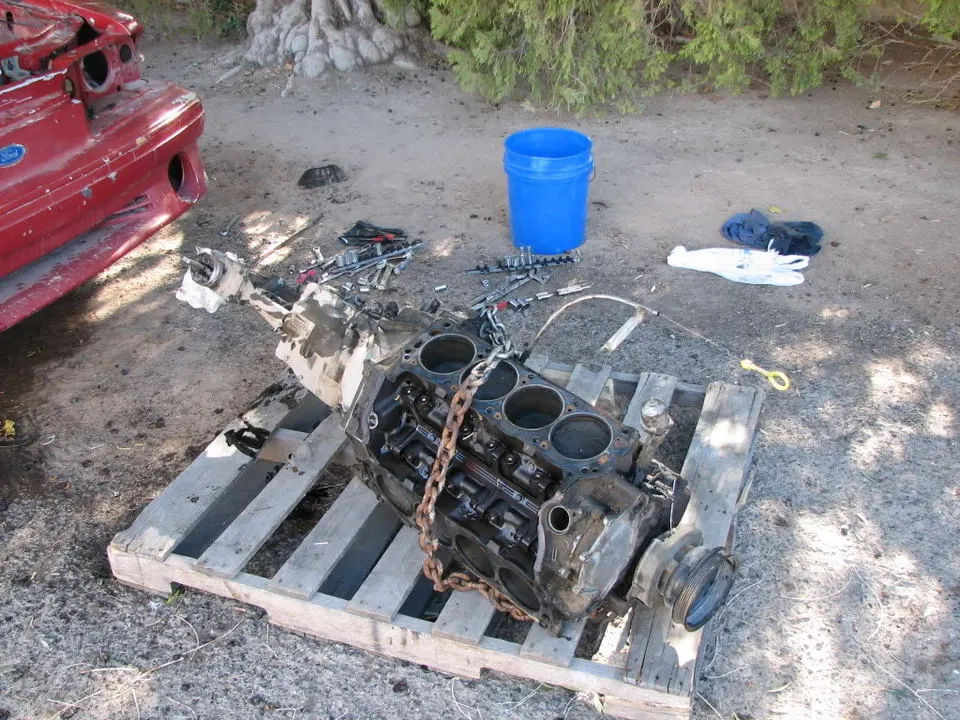

  10. i got a little more work done to the car over the long weekend. the block is ready to come out of the car....at least as far as i know :shrug:
    [​IMG][/IMG]
    [​IMG]
    [​IMG]
    now i just have to figure out what to do next.

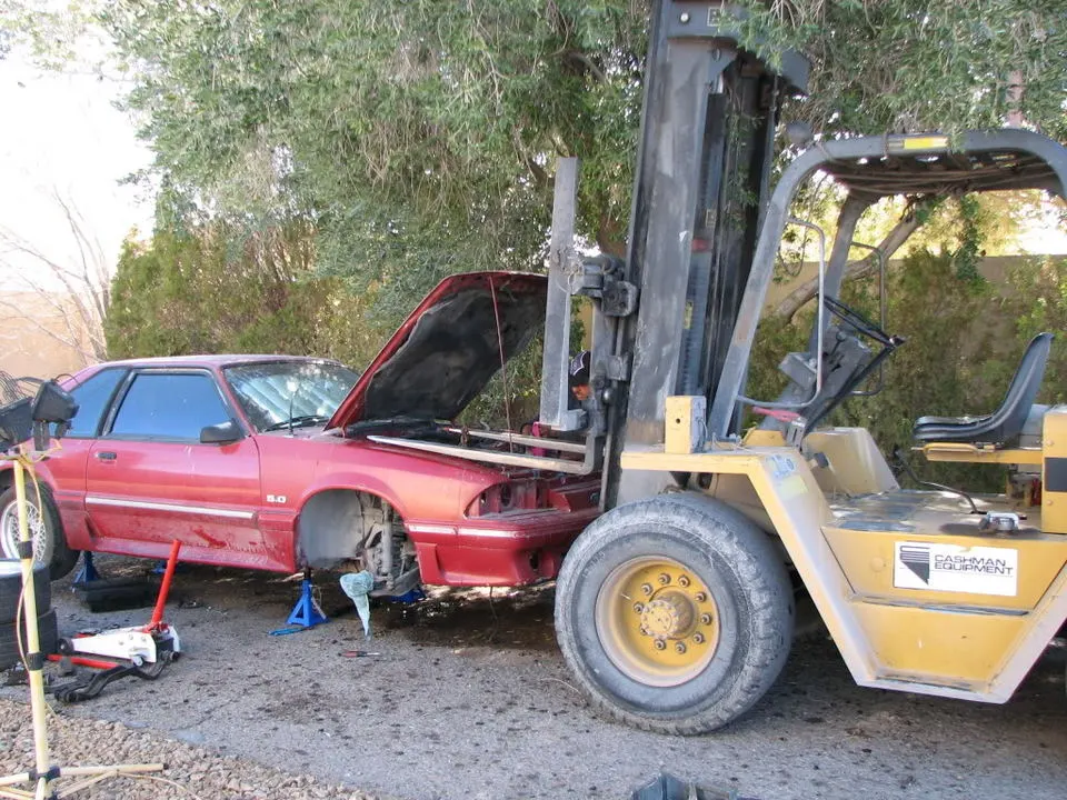

  11. a little bit of an update........
    FINALLY got the engine/tranny out of the car. now i just have to start figuring out what comes next. there is a TON of wires, cables, lines ect in the engine bay of these cars. i never really realized how much stuff there was in there.
    on to the next step :nice:
  12. Good lord thats a hell of an engine hoist you got there.
  13. HaHa thats how i swapped my engine into the roller
    way easier than a hydraulic hoist
  14. i had to use what i could get my hands on :D from there it's going on an engine stand that i borrowed...lol gotta keep costs down you know :nice:
    i did learn a few things on how NOT to do it, but i'll know better for when i put the motor back in.

  16. suggestions from what i think i did wrong.....
    1) completely remove the gear shift handle......i removed only the longest part that the shift knob is attached to which leaves a lever several inches long on top of the tranny.
    2) either leave the headers on the block or take them OUT of the car. i unbolted mine and left them attached to the catalytic converters. BIG mistake. they got in the way entire time!!
    3) i'm not sure how to take it off yet since i left mine attached, but maybe take the dipstick tube off as well. it sticks way out at a funny angle. i haven't looked at real close yet, but i believe i broke mine during the process.
    4) if you're using a forklift like i did, i'd suggest taking off the hood too. if you're not easy on the "sticks" you'll hit the fenders and/or hood with the forks. this may not be an issue at all if you do it the normal way of using an engine hoist :shrug:
    we ended up removing all of the brackets under the car around the tranny and exhaust system. don't know if it's necessary but that's what we did.
  17. yep on all but the dipstick
    notice no hood

    I think installing the trans/engine together as 1 peice is easy. Just make sure the radiator is out and you have friends to help. Also, hood's gotta come off or tilt way back and get some friends. I've pulled 5.0+ AOD's before...and IMHO it's easier to install an AOD bolted onto the engine from the front than under the car trying to line up the torque converter studs to the flywheel.
    Just gotta make sure no fluids are in the trans...or it will come out
  19. yup only part i ****ed up on, made a HUGE mess
