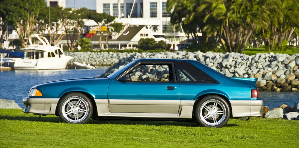

1. So here's another brake thread but I have a different type of question. Naturally I want to do a 5 lug cobra upgrade but that would also involve me buying new rims. I want the Chicanes true forged rims 3500. That said my plan I stokers the rims I have until after paint (2 winters from now).

  4. There is no way I'd waste my time with a 4 lug brake upgrade personally. There is even less of a chance that I would ever spend $3500 on a set of wheels for any vehicle, let alone a fox mustang that is barely worth $3500 with that set of wheels on the car!

  7. I had your car on my work computer as a screen saver until I got my car back. Nice and clean
  8. Thanks, I get more compliments on the wheels than anything else.
  9. those wheels are beautiful, razor sharp and too the point not over the edge they fit the car very very well
  10. Thanks I thought the (fairly big) power would get the props and high fives... nope the wheels.
  11. You car as a package just works bro! plus the reef blue is :drool: and fairly big is being modest lol !
