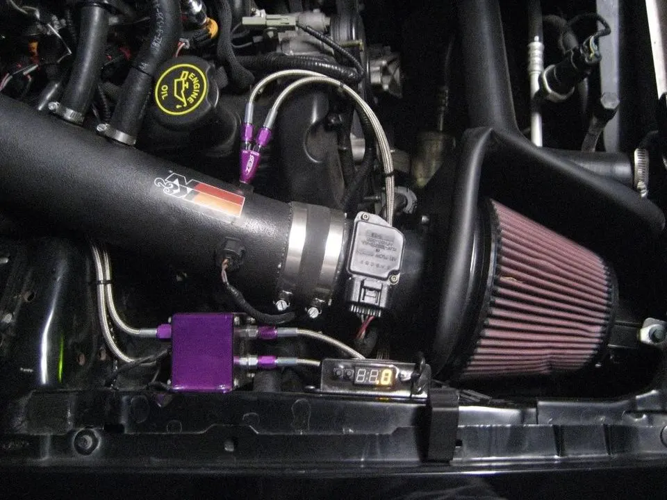

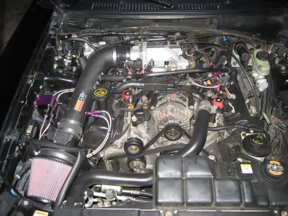

MSD COP's (no problems at all), Steeda firewall adjuster that's hooked with alum. quadrant and FRPP King Cobra clutch, Zex traction control window switch (mounted by the air filter shield), the 90mm Lightning MAF that solved my A/F problems on the dynotune
Better view of the window switch and Lightning MAF

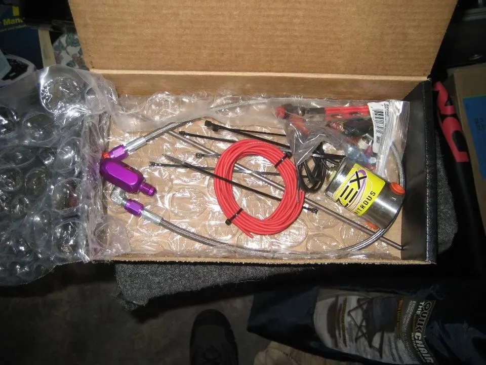

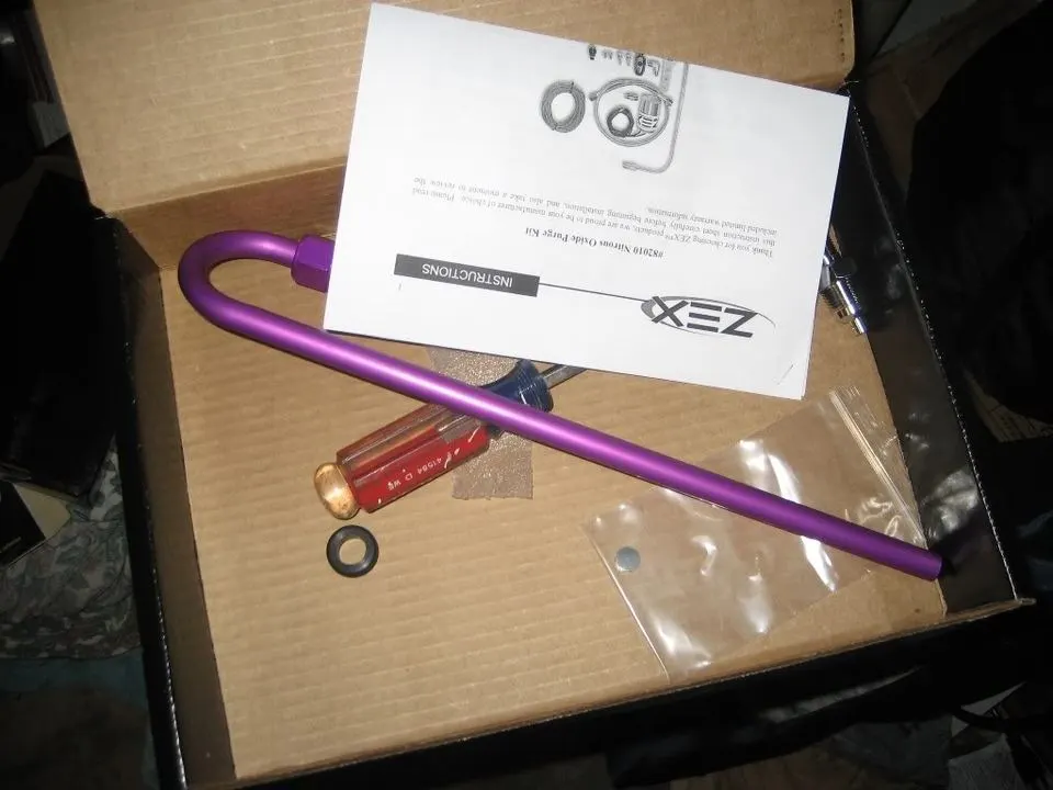

Zex purge kit

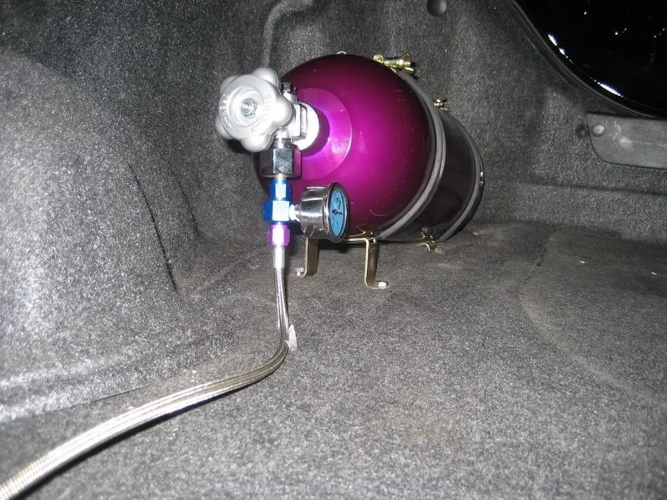

NOS liquid filled nitrous pressure gauge

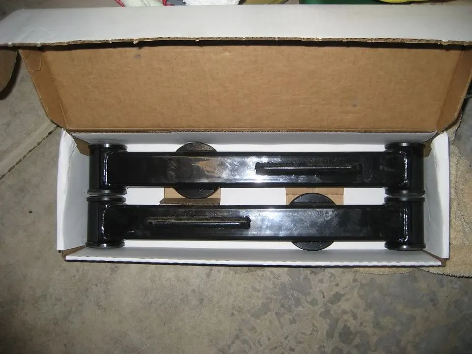

Steeda LCAs

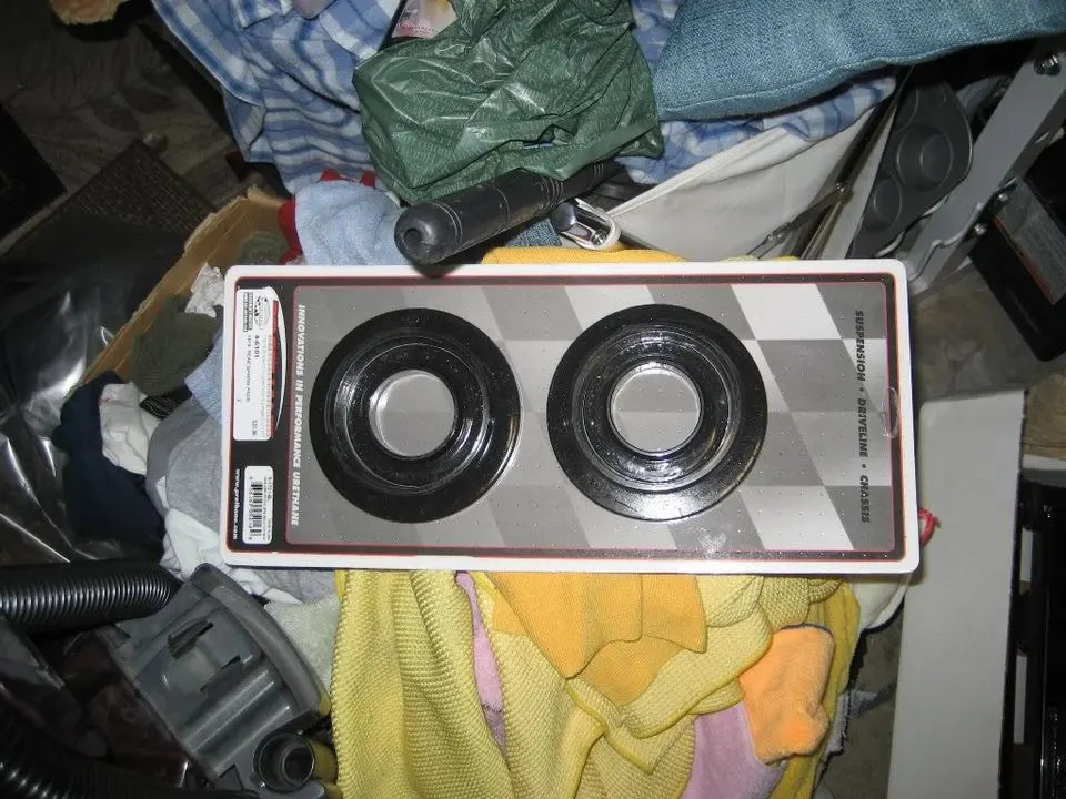

new isolators for the rear springs so I can get rid of my rake

What kind of A/F ratio problems were you having? And did you need an adapter plate for the lightning MAF?
Lightning MAF is a straight bolt in, just needed recalibration for my 19's. The old MAF wasn't letting the tuner adjust the A/F ratio on my dyno day, voltage was dropping during full thorttle rather than rising, slight bit of break on WOT and on let off. Since that MAF has been swapped in, she runs alot smoother now
