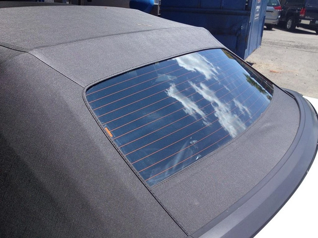

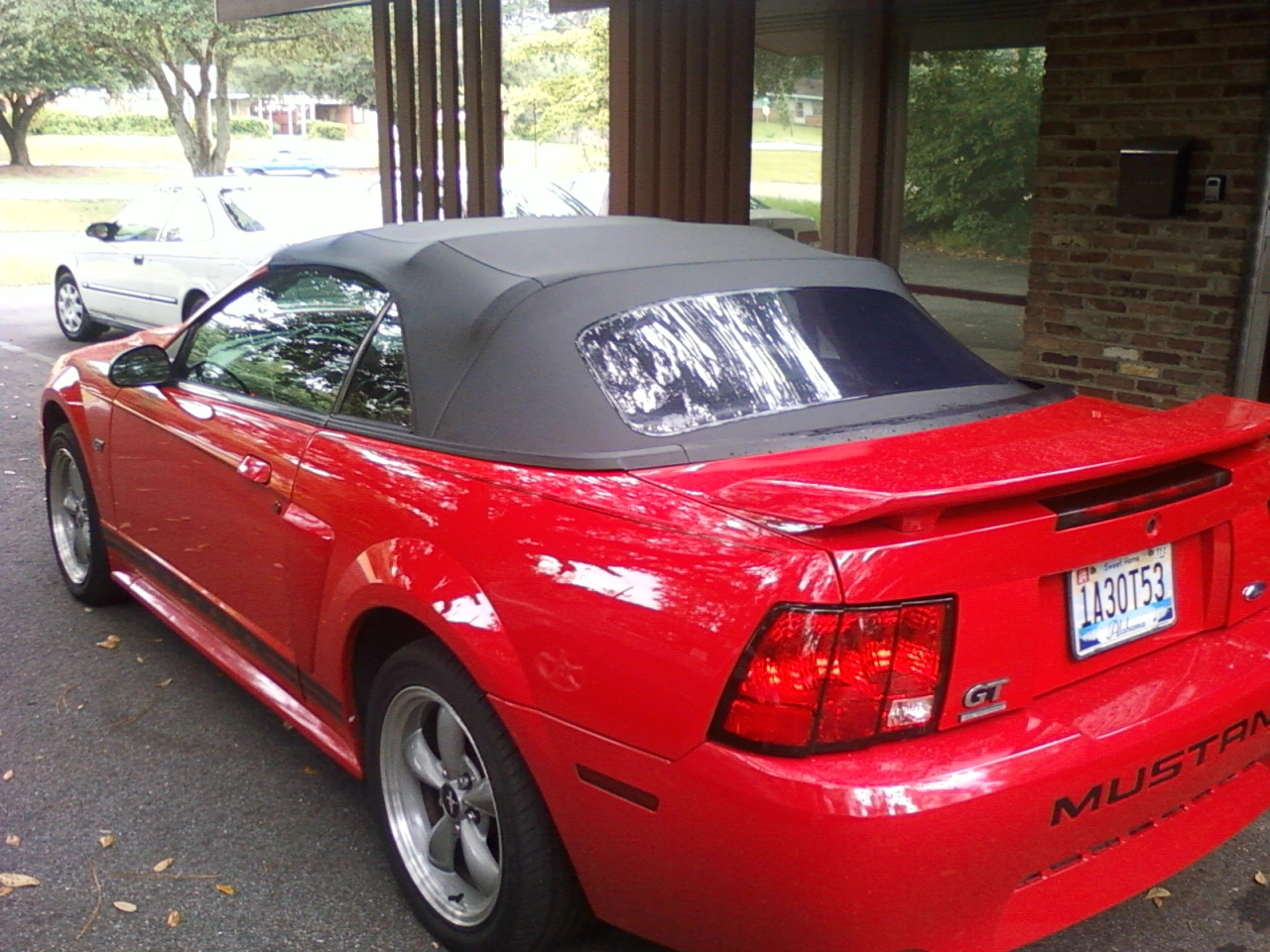

i have gotten good tops from american muscle and convertibletopguys.com.... AM only has the 2 piece tops.. about $180 for the top and $180 for the window... convertibletopguys have a one piece EZ install top that has a plastic rear window... they are really not bad at all to install... much easier than the 2 piece... price is about $275.... however if you like glass, it can be done by a novice....just use your old top as a pattern to go by..take your time and you'll be fine... 1st top will probably take 2 afternoons... get the DVD convertibletop guys offer and you should have no problem.. a 2 piece top in alabama costs about $1400 to have installed, parts and labor.. i think it's worth a try... the one piece tops look good and are a snap to install.. you have to take care of the window... only use PlastX or equivalent to clean... but they wear well..,,,find a good stapler, doesn't have to be electric.. use the glue sold by the website... you'll also need an upholstery tool and a pop rivet gun... try it, it's fun... good luck
