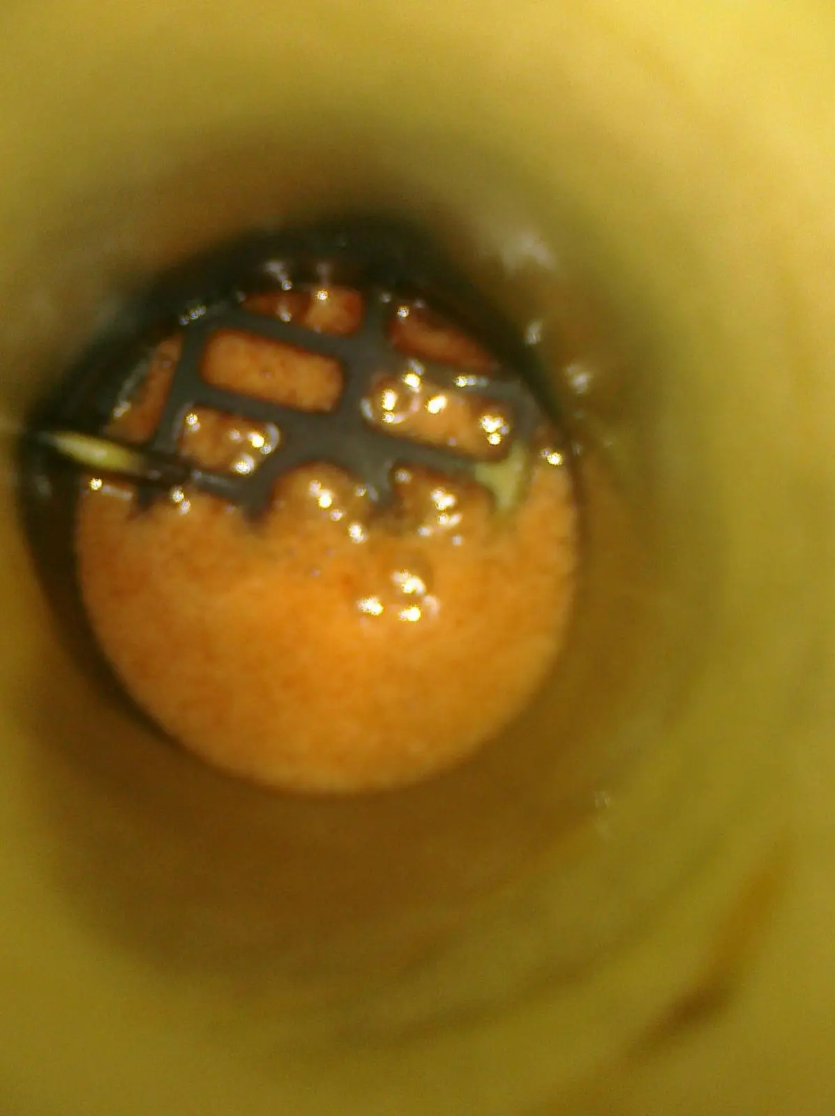

CAR HAS BEEN SITTING FOR A WHIEL SO THE OVERFLOW IS A LIL LOW BUT THE RADITOR WAS FULL.:OT: WHAT IS THIS MEAN THE BUBBLES IN MY POWEER STEERING

If the reservoir has fluid but the light is on, remove the sensor and clean it. The prongs get crap on them and they don't conduct till cleaned.
Yep, alot of us have the low coolant light, it's simply that the sensor in the tank gets cruddy and won't take the reading correctly. Clean that up and the light should go off
