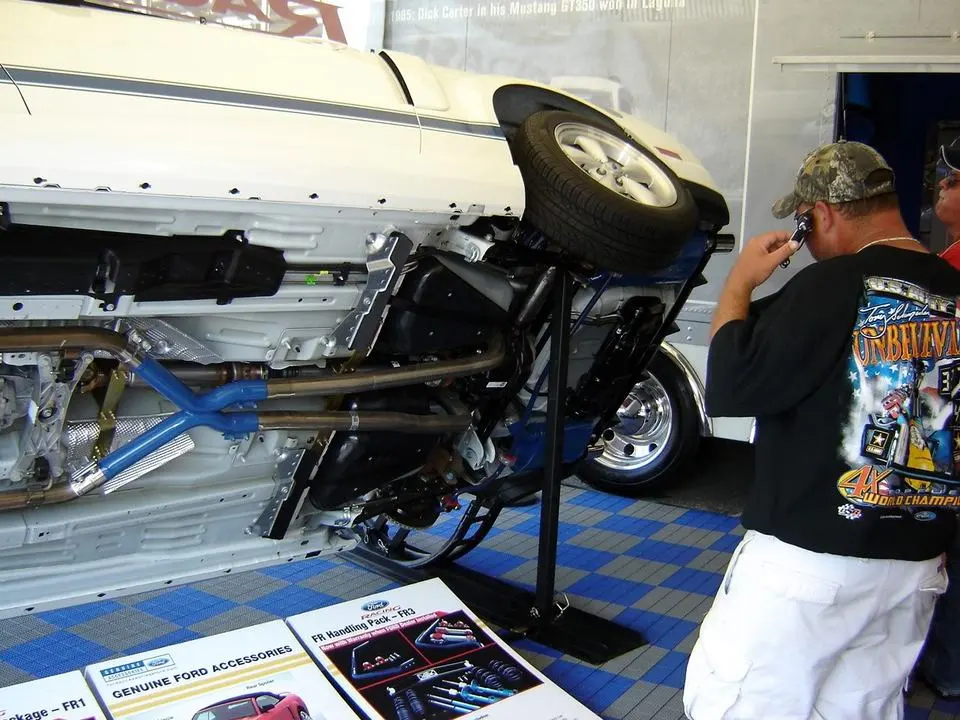

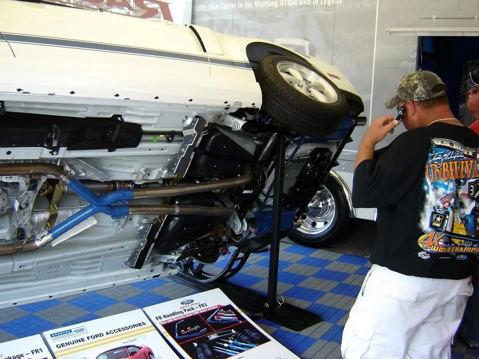

    This FRPP Stang has 2 DSLs installed.
    [IMG]
    Also has the X pipe Casey mentioned getting:nice:

    Nice pic Kooldawg! :flag: That car is super clean! Stupid question here but can the DS loops be put on without taking the DS off? Looks to me like you can slip it around and then bolt it down. ?:nice:

    The photo of the car on it's side shows the FRPP front and rear DSL installed. These do not require dropping the driveshaft to install. My BMR rear does not require dropping the shaft but the BMR front loop does. The FRPP pair of loops sells for $110 to $130 on the internet.

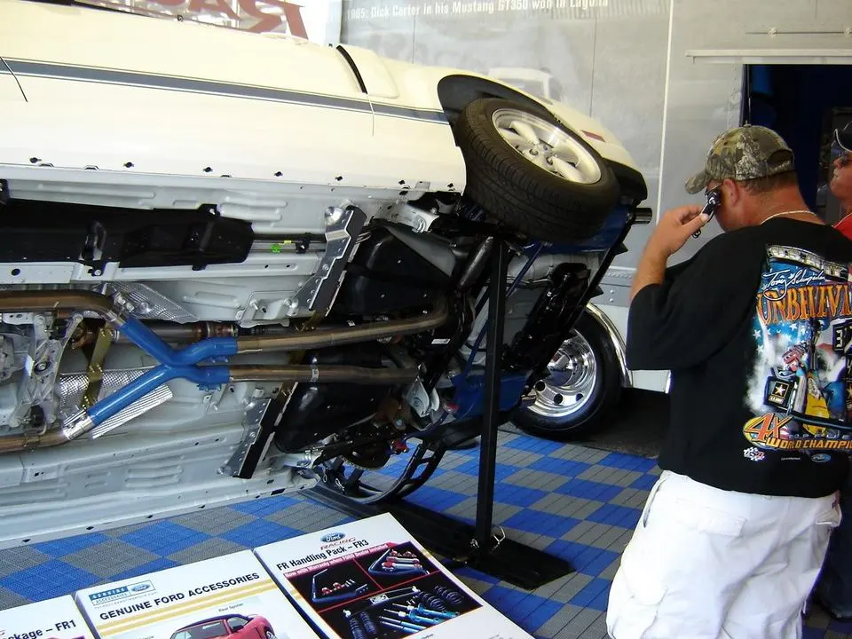

    It was at the Ford Racing display last weekend for the NHRA Torco Nationals outside of Richmond, VA. Here are some more pics.
