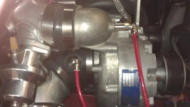

    Hi
    My nozzle is in the supercharger so it's close??? Looking to put another one pre-supercharger... :)

    My IAT is right before the T/B... and then the nozzle is about 7 inches before that... They must move there IAT to after the T/B.

    Getting excited!! Installed a pre blower water/meth nozzle tonight.

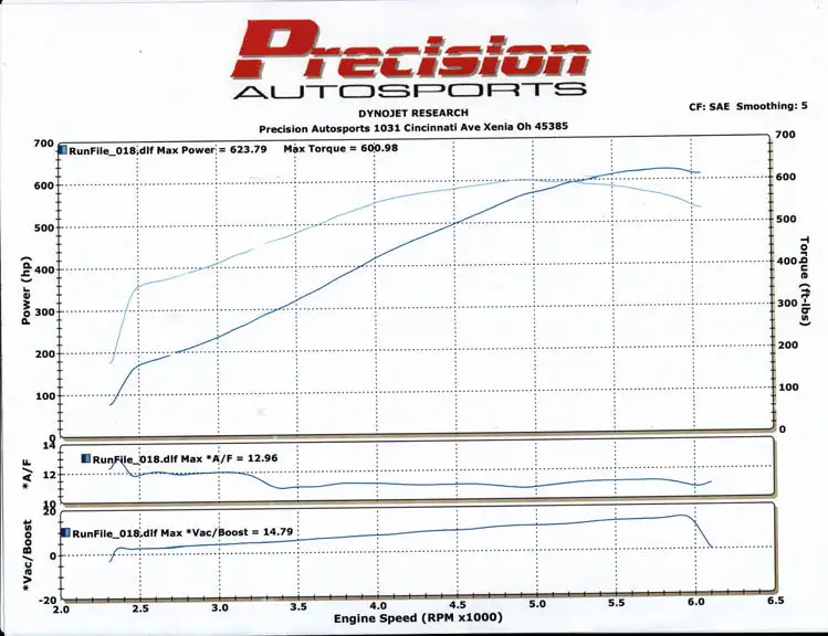

    Quickly... 623rwhp... Yeah!!! Chart to follow!! :)

    You're goal was 600 to the wheels so I'm guessing it was a good day. The intake and meth mods worked.

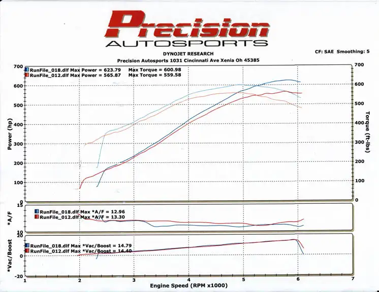

    Yes it was a great day... Breakfast, Lunch with my sons a great time at the DYNO!!! :)
    Had 565rwhp then added Systemax Intake (thanks again 4Jenna), 75mm T/B and Highflow cats, and add
    58 HP.....That is what I like!!!

    that is fantastic! you not only reached your goal but you surpassed it! that's such a smooth curve too.

    I really liked that. If you compare the old to the new you can really see it...
