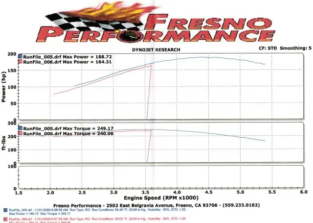

    good first run,driveshaft vibration.(will look into it over the thanksgiving weekend)
    second run aborted,started to ping.
    12*BTDC,87 octane.should have put 91 in.
    guess thats what i get for being cheap on the gas :rolleyes:
    the idea was to run the way i drive it,i dont see those rpms too often.
    next time it will have 91.
    heres the graph.
    [IMG]
    and the video.
    Dyno Shootout :: DSCN1813.flv video by hdavis3_bucket - Photobucket
    Thoughts?
    i'll post up some pics and videos the other cars later.

    Hmm...I'm sure more intelligent people will chime in here soon but, to run 91 octane wouldn't timing be at 10*? Also, would your car benefit from a cold-air intake?
    Also, your driveshaft vibration could be from a bad dampner or loose bolts? I had a problem with mine backin out.
    Overall impressive run for a stock, exhaust only car!:nice:

    If you are going to run an advance in timing at all, you should not be running bottom grade. That's really just kinda asking for trouble. I have also found that 94-95s do not allow the same 'window' for timing advance as a fox when using the lower grade fuel. Might be from a faster ramp rate in the maps idk, but rule of thumb is it seems to be a 2 degree offset from ping to no ping. It should like 14 degrees on good gas.
    However and what makes a good point, is that IF the balancer IS going bad (which the do as mine **** the bed) they will not only cause the vibration you are experiencing but it will be slightly spun from center and the actual base timing might not be correct from what you can see. In otherwords on a stock balancer 10BTDC is at 10BTDC. On one that is bad it might read you are at 10BTDC but is really closer to 16BTDC. Just something to think about. FWIW CIA's don't show much on a dyno, but they do help in real life.
    Nice baseline at least. Now you gotta get some real mods at it! They get alot more fun with @300whp and another 50+ lb ft tq. :)

    Looks Good Harvey :nice:
    I agree about making sure the hb is not hosed :Word:
    That way you can go max spark with good gas
    and
    You will know for sure what you got
    Pulleys & Intake (not pipe) would be good next mods ;)

    That's a little on the week end even for 87' Octane. The car should do 190rwhp+ bone stock.
    I would go ahead and change the U-joints on it. You can get the really strong ones from the Autoparts store, the Brute Force ones, or whatever that particular store calls them. The driveshaft might have thrown a weight. It should be around $35 to get it rebalanced at a driveline shop.

    Of course the second run would suck, no time to let the motor cool down, the second run was worthless.
    It's fun seeing your car on the dyno, but I always get nervous that something catastrophic is going to happen!
