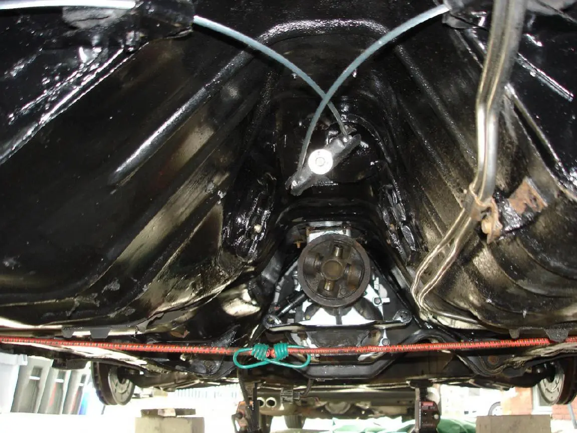

any one have pictures of how the 2 cables hook up to the e brake handle on an 86. there are 2 cables then a hook coming off the ebrake handle am i missing a part?
I don't have a picture but there is a metal bracket piece that has slots in either end and a hole in the middle that joins the two rear cables to the front "hook" cable.
