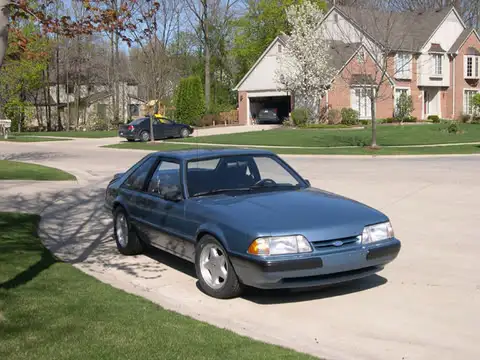

I had a question. Looking at my wheels and fender, there is about a 1.5" gap. in the front, and it dosent look like the tires would tuck under the fender, could this be a problem? Or should it fit fine?
Got the rear springs on. Probably one of the easiest things ive done to my car...
Im in a bit of a pickle with the front springs. i dont really want to do them, i have a pretty detailed instruction sheet to take them off w/o a springs compressor but im still not quite sure how it works. Once the front springs go on ill be ordering cc plates and ill get her aligned. The rears look sick!
