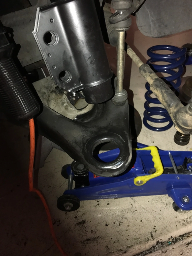

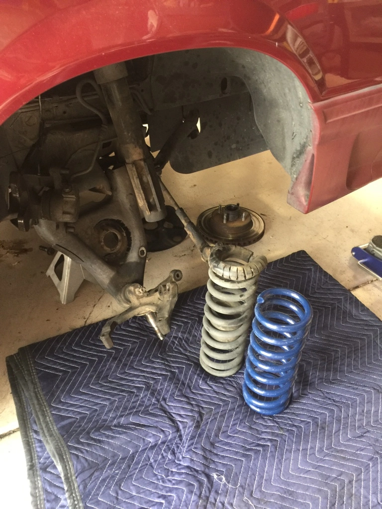

When I did mine, the safety pins would get stuck on the Eibach springs. They were OK removing the stock springs, but not so good installing the new ones. The spring was too thick for them. I also had to shorten the bolts, they were way too long and interfered with the spring getting into the perches.
