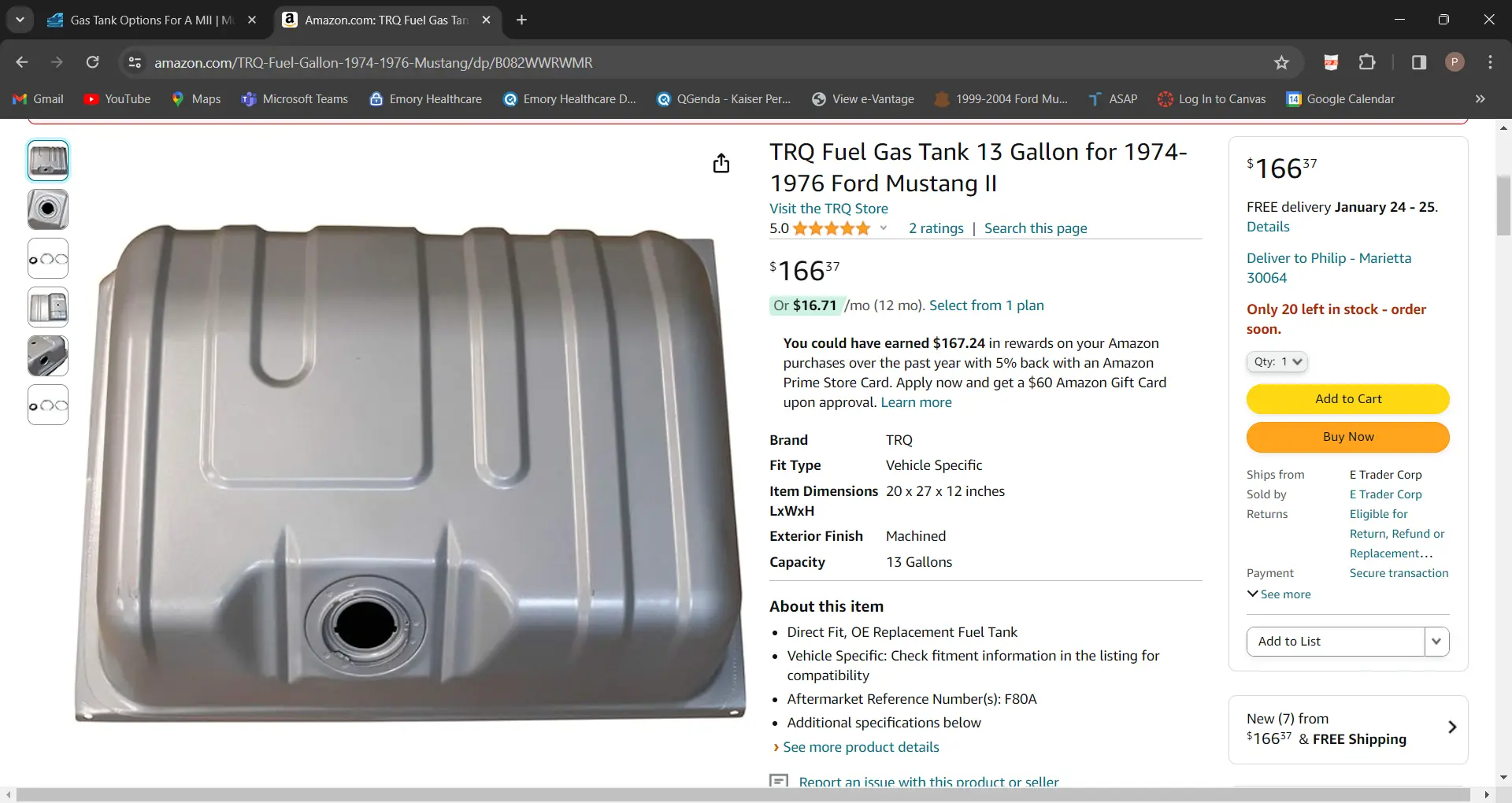

If I remember correctly there was a slight change to the top of the tank to accommodate for something. I know the early tanks don't fit the later cars though, I tried since the tank in my 77 was full of pinholes on top and I had a 76 parts car that I tried to swap from. From there I think there are only 2 - 3 options. 1st one is probably the most expensive as you've pointed out - find a replacement. A quick Google search revealed one through PartsGeek.com
here. Another option is to swap in a fuel cell, but that may be just as expensive and most likely less practical, depending on what you could come up with. The third option is what I did way back when - the Fox cars use a tank with a similar shape but required modifications to the car as well as the tank. I have a thread in the stickies under the tech link:

You are correct, the 74s had the filler neck located lower on the quarter than the 75-78 cars, but to my knowledge the tanks are the same from 74-76.
