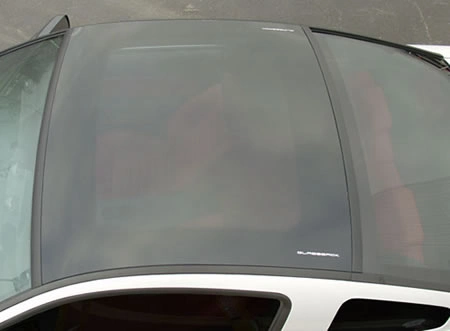

    Alright gentlemen, I think I have come across a mod which greatly exceeds my abilities. Which means I have no choice but to do it myself. :D
    Through a strange twist of events I got a hold of a CDC Glassback (Link) and I am looking to install it with the help of a few buddies.
    With this type of mod I can't say I really know what I'm getting into but isn't that 1/2 the fun?
    CDC wont supply any instructions to any non-authorized dealer which certainly complicates things. I have the template for sectioning out the roof center but even the placement of that is up to the installer's discretion.
    I found this video Youtube that serves as a semi-instructional just without the specifics. But it doesn't mention what type of cleaner to use, what epoxy/sealant etc. I haven't even settled on what type of tool to cut through the roof (metal shears, Skillsaw, jigsaw?)
    So if you have done a moon-roof/sun-roof install or anything of the like I'd be curious to get your feedback.

    Roadracing notes: From what I have read the glass weighs roughly 20lbs more than the OEM roof which yes is at the highest point on the car. Certainly not ideal. However, the glass itself is a dual laminated tempered and tinted piece which actually adds structural rigidity. Some fellow racer friends have questioned why I would do something to my car that doesn't make it go faster but at the end of the day this is my daily driver and secondly my weekend warrior. Any extra girth is offset by the cool factor. Plus, you don't know what I paid for it ;)
    Installation Notes: Remarkably similar to a sun-roof installation this should be pretty straightforward. About the flushness of the windshield/glassback, the paper template provided allows the installer to place it as far forward or as far rearward as desired. I think it should be flush with the front for the desired effect but again this is a sort of grey area.
    It also came with a type of plastic weatherstripping that kind of frames the glasstop as well as a custom premolded headliner which is pretty neat.

    I've been working with Sanctus on this issue via email, and am hoping to be able to provide as much help as possible, and might be able to get him the actual instructions. There are a few hurdles I have to go through, but I am working on it.
    As I told him over email, we do not pass these instructions out as many of you have stated, because of potential warranty issues and simply because the Glassback kit is not available directly to the end user. It must be purchased/installed by an authorized installer/dealer as each roof system has a serial number and is tracked. However, since we are car enthusiasts just like all of you, and our company was founded on the do-it-yourself idea, we might be able to bend the rules a little for Sanctus. :)
    To clarify a few comments above- you can use a jig saw to cut the hole, but we prefer to use a sheet metal sheer, as it makes almost NO metal shavings at all, and leaves you with a nice clean edge. The sheet metal that is removed IS rediculously thin, providing no structural support to the roof at all. The glass panel is a double-layer of glass that is laminated with a solar-absorbing laminate, and after crushing a Mustang for roll-over testing (yes, we crunched a car), it has been proven to be stronger than the factory Mustang roof.
    Regarding making the glass panel flush- if we 'sank' the glass into the roof, it would affect the roof structural components as well as the glass thickness, altering its ability to keep your head cool. The OEM glass roof uses an entirely new roof stamping, which although is very cool, is simply just not feasible for the aftermarket. We provide trim pieces that surround the glass panel that are OEM in quality and appearance providing a flush appearance for the Glassback; most people don't even recognize them as not being stock when they are looking at the Glassback.
