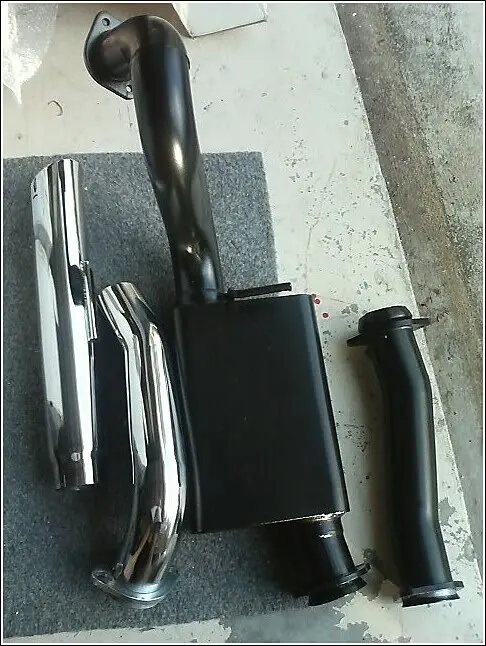

    I've had 4-5 different exhaust combo's. My favorite by far was Ceramic Long Tubes into Prochamber.
  11. Yeah, we have some very good fab guys welding them up. I've seen one bent in half that still held pressure.

  14. I never knew why people don't get ceramic headers or some type of coating. Trust me the first 4 headers I bought were not coated either so I'm in that boat too. With the GT40X heads I bought MAC 1-5/8" Long Tubes in Chrome which turned purple on the first start up which is a terrible feeling after spending $300. Had it matched with the Prochamber and MAC cat back. When I changed to AFR 185's I went MAC 1-3/4" Ceramic Long Tubes w/ 3" collector, MAC 3" Prochamber and MAC 3" cat back. Best sounding exhaust I've ever had probably because it bolted to a 347 stroker. Also it never discolored.
    Here they are:
  15. I had the full MAC exhaust with the Pro Chamber and I have to agree. Mine seemed cheaply made and it rusted in our Indiana winter almost as soon as I let it down off of the jack. But the sound to this day was the best I have heard coming from a Mustang. I will probably buy MAC again for my 94. But I will be sure to go ceramic.
