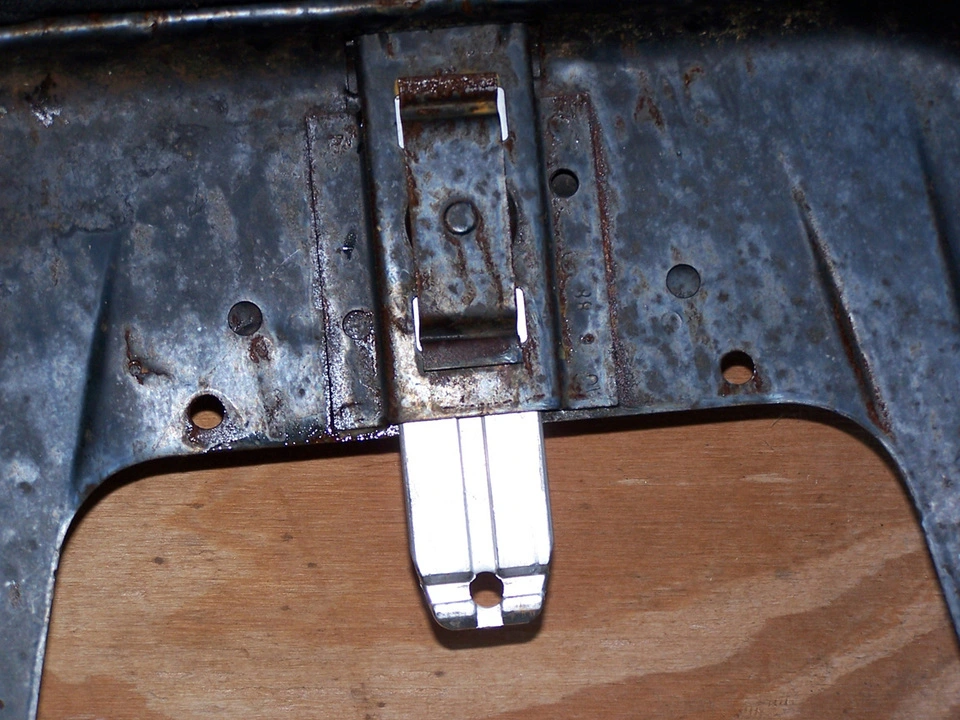

Opportunity & information have finally come together. I have an old seat frame and a headrest in my carport. If you stick the hacksaw blade in the front side of the headrest, it will keep the crook from popping in the groove on the headrest mount bar. There is one crook in the top part of the spring and one crook in the bottom part of the spring. I suspect that it may be easier if you insert the hacksaw blade from the bottom on the front side..
Joe, thank you so ver much for the pic! now i know what my fingers were feeling and what it all looks like.
i just got up, so i ll try it later. you guys have done everything but pull the headrests for me - so imagine how stupid i will feel when i cant get them out still. :)
thank you again :nice:
