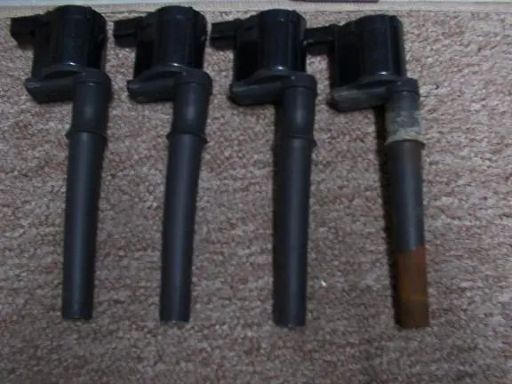

    this might sound dumb but on a 99 cobra were are the coil packs???

    On top of the plug boot. Its that little black box.

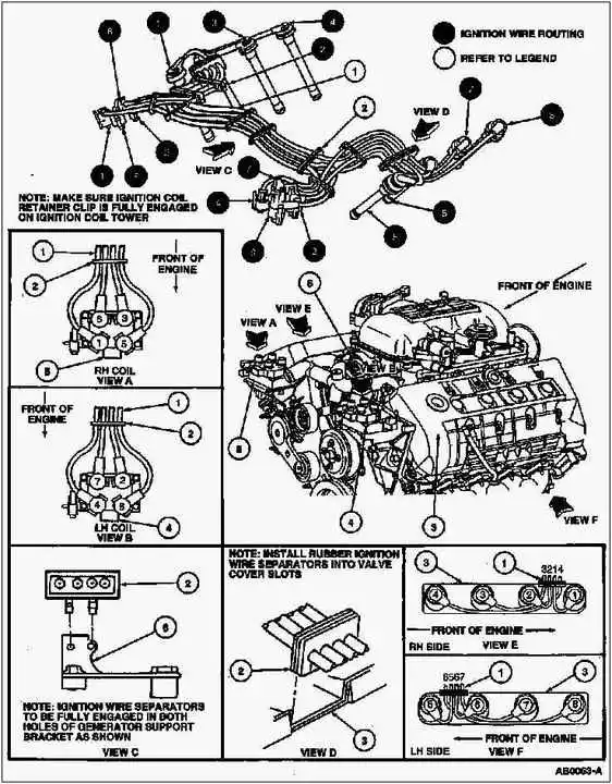

    Your car has Coil on Plug spark plugs where each spark plug has it's own separate coil on top of it...on the pre-99 cars there were 2 coil packs, one each for for half the engine...you can see them on my car in this picture
    [IMG]

  8. Lsredy2kstang Look, I'm special, dammit

    Nice diagram! Is that off of Ford Service Manual disc?

    Yup

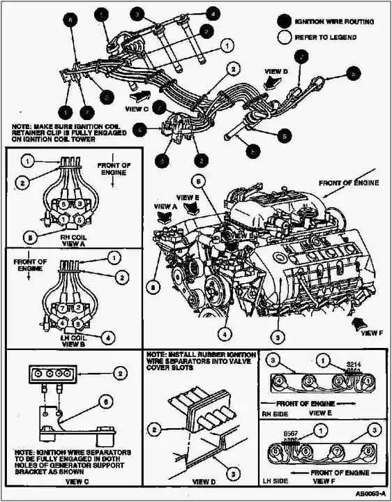

    99 and up look like this.
