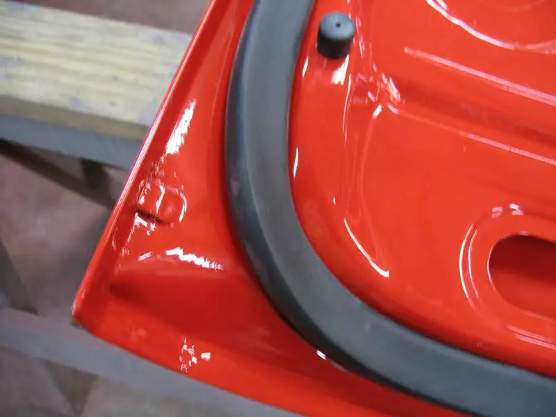

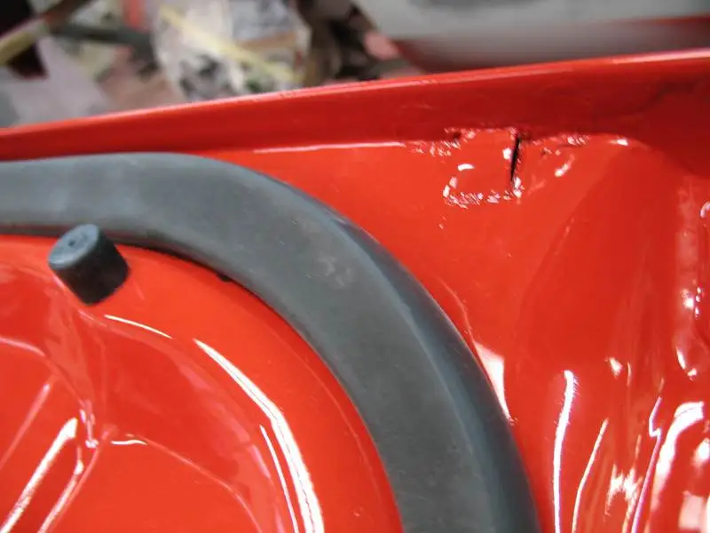

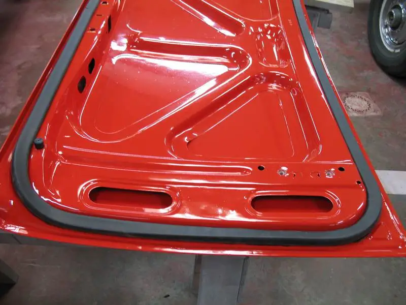

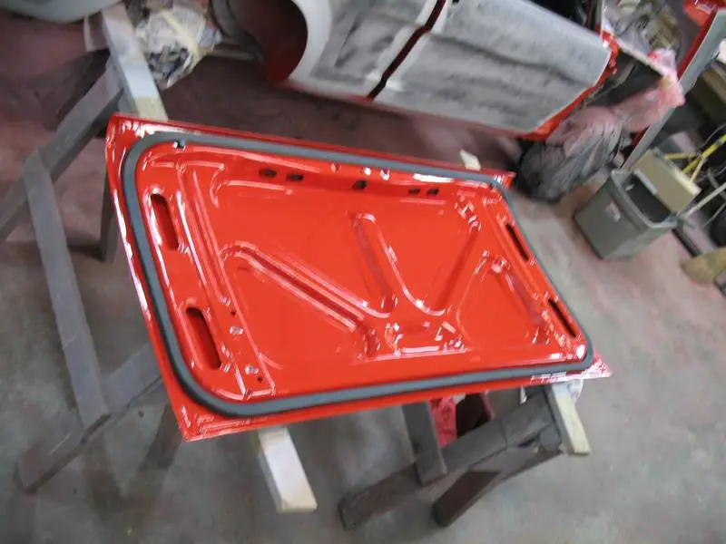

  9. Trimming was only needed when the seal was placed and I butted it together at the ends like Barnstang mentioned. Since the seal was very pliable, no additional trimming was required during installation.
    Black and yellow 3m adhesives have similar holding capacity. I first cleaned the seal with wax and grease remover to get rid of the release media used when the seals were formed. I then followed the 3M instructions and placed the adhesive on both the deck lid and the weather stripping for about a 3 foot area and let it setup tacky before placing them together. I used masking tape to keep them separate beforehand and carefully placed the strip on the trunk. Probably had a couple of hours in the install as I wanted it nice.
