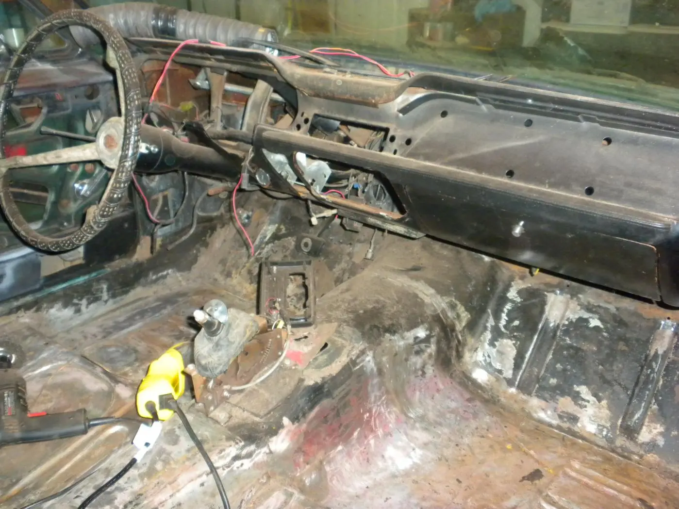

interior is gutted. Front seats are long gone, but I have the rails. The dash is gutted and I have all the guages somewhere.
The floor pans are stripped and I need to apply some more Por15. I do have a soggy passenger side rear floor pan. The metal is noticeably weaker there. I am contemplating welding in a piece of sheet metal.

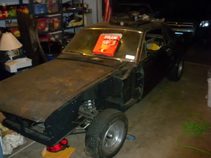

here are some more pictures. I am having a hard time deciding where to start. There is so much to do and I just need to pick something and get to It.

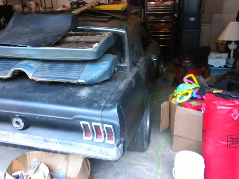

more crap I have to get out of the way before I can have room to work on it.

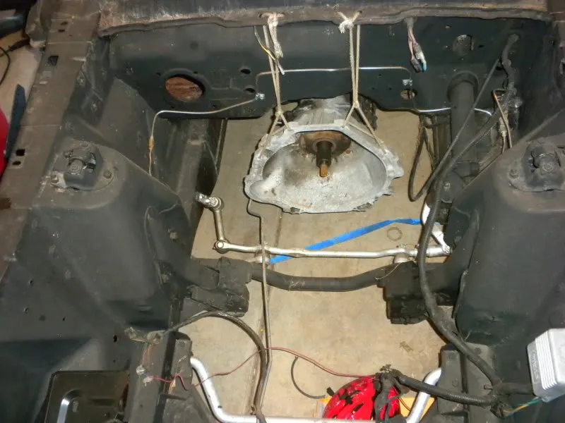

Engine bay. finding all the bolts, and remembering where the wiring goes is going to be a pita.

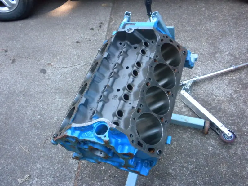

Machined and ready to assemble 302 that is going in the 67. I did find some rusting in the cylinder bores. I am going to take some time and clean it up prior to building it.

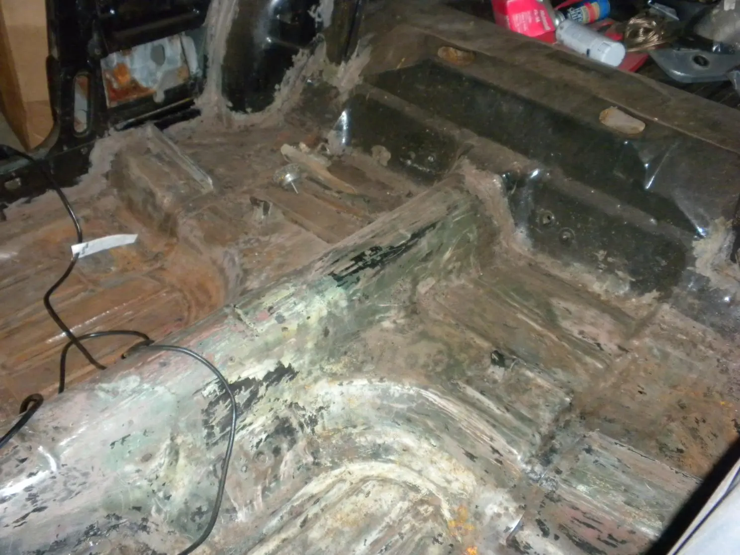

Por15 is a pita to apply, and a pita to take off. I am stripping because it flaked off in some parts. I am going to strip the metal bare and apply again.

used up a vintage 2005 can of paint stripper to finish off the interior. I am thinking I lost some basic math skills due to the fumes.
It seems to be doing the trick though. Its peeling off like dead skin.

I was able to get most of the old paint off yesterday. I just need to hit the remainder with the wire brush. Por comes off fairly well with stripper. It has the consistency of electrical tape.
