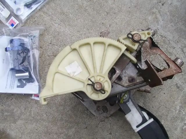

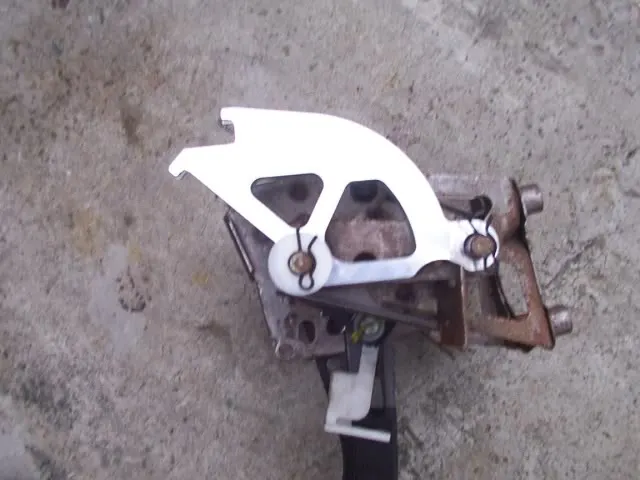

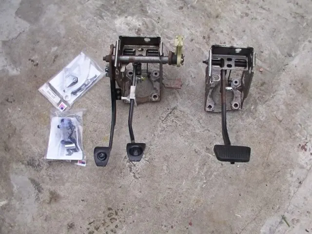

  19. So im gonna be doing this, but Im not converting from an auto to man. So I wont have to take all this out, right? I I have an aluminum quadrant, it looks to me like maybe I could just take the pins out of the side and take plastic off and put alum on? I know its not gonna be that easy
  20. Correct, you won't have to remove the pedal assy. I did because I was converting and couldn't use the auto pedal assy.
