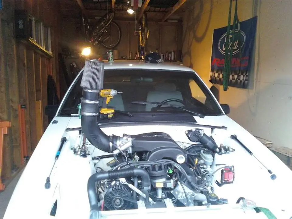

  3. yep i went out fixed the lines topped the coolant and drove it a few (literaly only a few) miles and came home cause the rain started. but yes no leaks and alot less heat now so everything looks great! oh yeah i made another ram air/CAI take alook it's pimp! :banana: peace
    john:p
  4. haha, snorkel air intake FTW... that would be fun in a rainstorm :rlaugh:

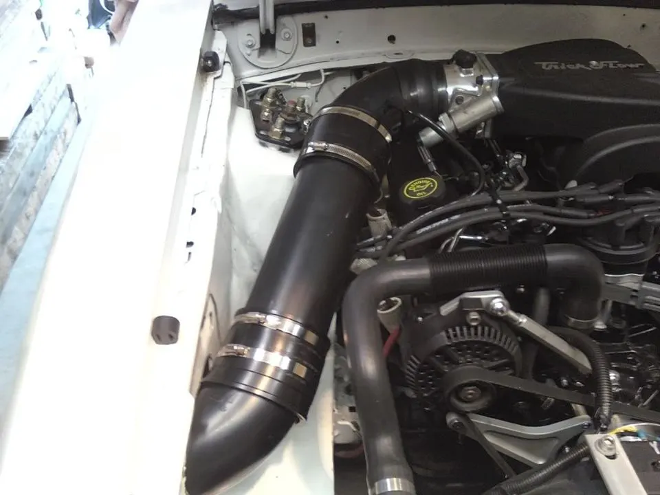

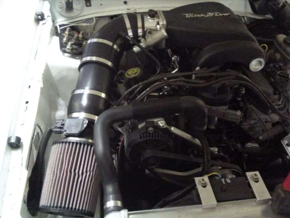

  9. Well i built a new CAI wednesday for the dyno tomorrow. Tell me what ya think?
    It was gonna be like this but the pipe was to dam big to make the bend down below

  10. looks great!!!

  13. you bet! getting ready now to load it on the trailer soon as a buddy gets here dyno at 11 .S&B i'm not sure? I know with my set up the TPS was hitting on my stock hood and also that BIG ASS CAI i made was also.peace

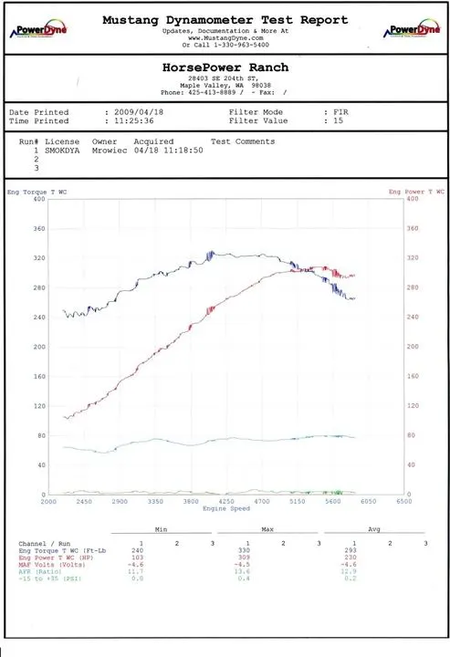

  14. Well i guess as long as it looks good huh? **** this! 309/330 what a joke!

  16. nope nowhere near what i expected
  17. damn, i didnt expect that small of numbers on such a sick motor. i was hoping for high 300's. maybe some tuning here and there might help?
  18. You and me both! But unfortunitly thats all i can get cause the compression is so low. I started another thread of how bummed i am,from the sounds of it my cam is to small as well. So it's time for a bigger cam! peace

  19. Todays the 1st of may what are your numbers? peace
    john:p
