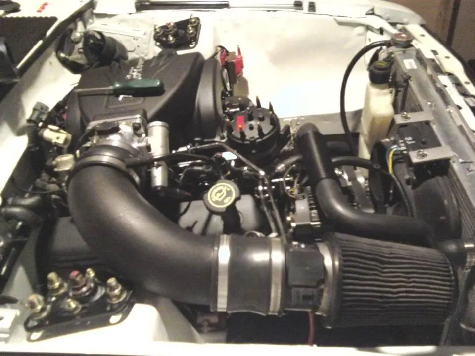

  1. thanks for the help, luckily for me i already have a hardwood 2.5" on the car. U have ARF185s, im using twisted wedge strip/street heads? Im not sure on what style headers to look for, well im getting longtubes, but u know how certain heads need certain style adapters or flanges? not sure if thats what is called.
  2. Looks real good in there!!! Should be a fun motor.
  3. it was about $5030
  4. thanks 25th. wish i had your car to put it in! man i like yours alot espically the paint scheme! blueink not sure on your heads if all headers will work,but something i've never really liked are adaptor plates. i coulda got one for my lower intake to bolt on to the 351 off my 302. but nah dont feel comfortable. as far as the hood? if you only use the normal gasket for the upper and lower and not a spacer (if you go with trick flow) and you use the energy suspision poly mounts the hood you have should be fine? i want to put the bottle to it soon after i get the tune done,if i do then i will definitly need a bigger (then a 2.5") cowl hood i think. the plate for the nitrious is like 3/8 to 1/2 thick and it goes between the upper and lower intakes.plus i need to get a job :rlaugh: :notnice: peace
    john:p
  5. I didnt go through and read all this but what size Throttle Body are you running?
  6. :lol: thanks didnt think anyone would. well thats about what i was thinking i had into it! peace
    john:p
  7. it's a accufab 90MM inlet and goes to 75MM on the intake side. peace
    john:p

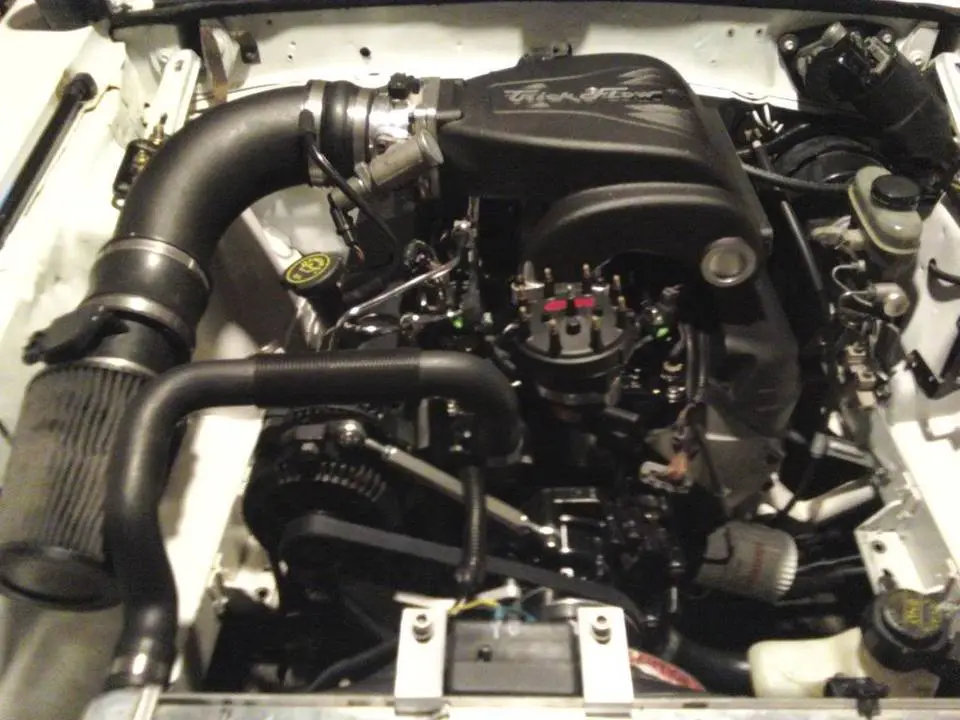

  13. well i didnt use that pipe picked this elbow up today.i'm using it till i get the AMF power pipe.whatcha guy's think?peace
    john:p
  14. looks good. Maybe ditch the filter for a new one one, your engine looks sick!
    Hey you running a black majic or a proform fan?
  15. it's a black majic fan. thanks peace
    john:p
  16. where did you get that piping?
  17. i went to a desiel truck (pick up) perfermance shop and it is actually a real CAI for a pick up. it's 4" in and 4 1/2" out (into the tb) really nice product not sure of the manurfacture? it's gotta work for now tho. and the plans for today are put the mid pipe on put oil in it and put the chip in and fire it off! if my buddy remembers the camera i'll have video later today or first of the week for ya guy's!peace
    john:p
