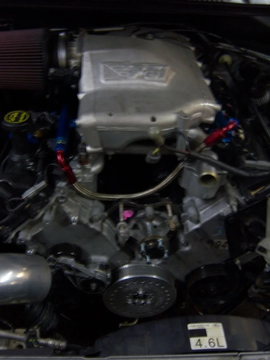

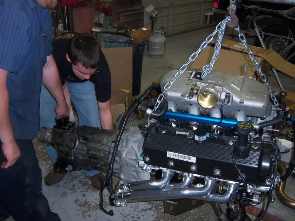

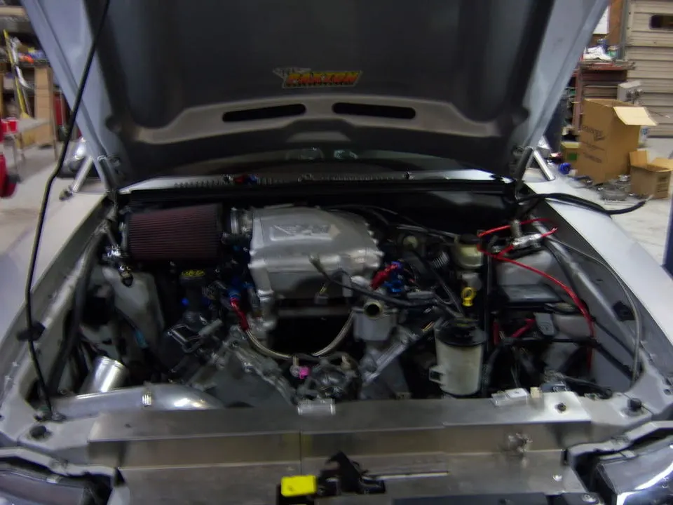

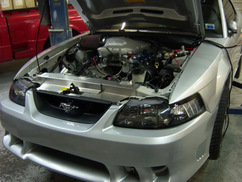

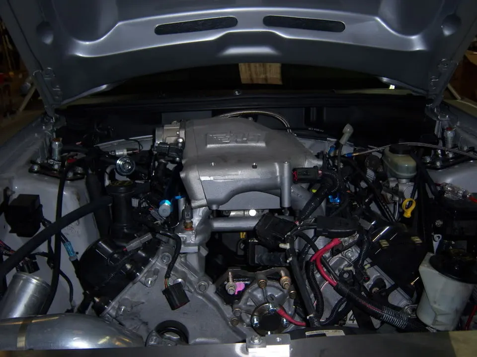

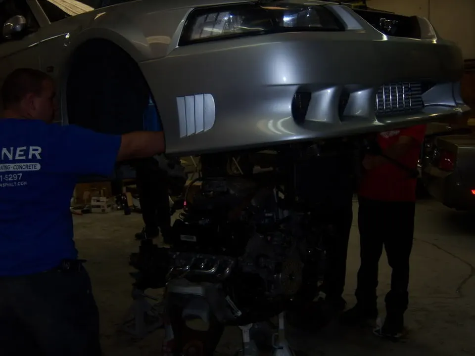

we got a lot finished up today after running into multiple headaches. it should be finished up tomorrow afternoon.
heres a few pics from today
Looks good although I am wondering why you have the filter on the throttle body. LOL
We got my car all done today too. I got CPR rails to go with my p-51, I want to warn you to make sure you lube the injector rings with vasoline because they will come loose and spray fuel everywhere, as mine did tonight at the movies!!! Thank god for friends with tools. Anyway, looks like you are off to a great start, and try not to get frustrated...always expect the unexpected.
we had a TON of missing parts, bolts and other misc stuff today. the blower and a few 8 rib pulleys are all thats left now.
i figuredi'd give it a N/A look for these pics since you'll never see the filter again

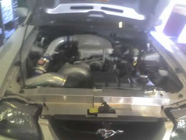

i installed all the 8 rib stuff and the blower today at work. i also installed the wideband sensor and gauge on the steering column(still need to wire the power and ground and hide wires)
if all goes well and i can actually get a belt tomorrow it SHOULD be ready to crank up by the time i leave work. Dyno will be scheduled for sometime next week after i finish all the nitrous plumbing and wiring.

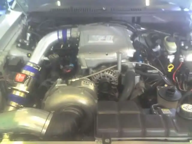

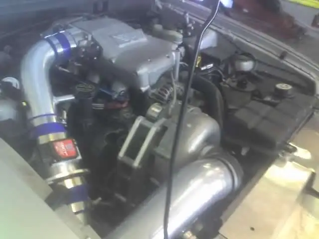

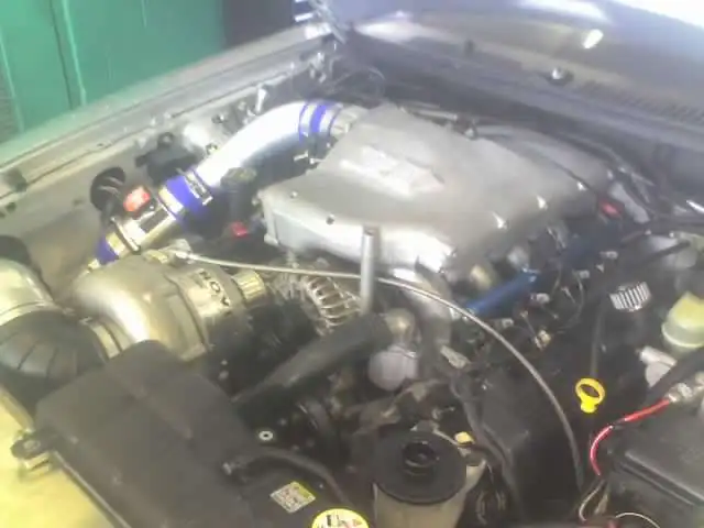

anyways the car is at Fastlane right now getting the section of IC piping from the MAF to TB redone to fit the P51 and allow the IAC to be hooked back up. i got the wideband and nitrous stuff all finished up and hopefully i will be picking it up tomorrow afternoon to put some miles on it. i drove it about 10miles from my shop to Fastlane today and it drove like ****. the IAC was open and it was basically a HUGE vacuum leak and it would not idle worth a damn. (obviously)
they should have the idle and surging problem fixed tomorrow.
i have some pics of it all finished. sorry they are crappy cell phone pics :(
